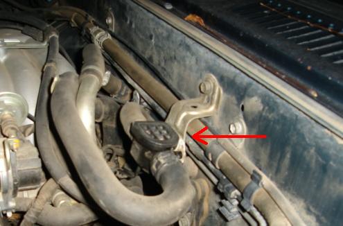

Here's a crappy pic, but the best I could do
This is the suspect area. The head above the block appears damp as well. I just don't know whether that is some oil from the valve cover gasket weeping or if is coolant as well. I do know that this is the spot where the leakage/seepage becomes most significant.

better pic of the situation
Anyone wanna venture a guess as to what this might be that is leaking? This pic is actually from 5 months ago, so I've had this problem longer than I initially thought.
Only in the past several weeks have a let my truck sit for a long period of time for something to actually drip on the ground.

if that is the drivers side like i think it is, there arent any coolant lines on that side...unless its one from the throttle body or something. Kinda looks like an external leak from the headgasket. Hard to tell tho

Pressure tested this morning. Starting at 7:00 am. Held pressure until noon when I left, vehicle was then moved outside and low and behold three hours later the problem evidently reared its head.
A leaky heater valve. They didn't have one in stock so I may just do it myself. It looks pretty straight forward.
Evidently at just the right temperature this valve would leak and drain down the back of the head and block on the driver's side.
A pricey part $40-$80 depending on source, but obviously much cheaper than a BHG or a leak under the intake.
