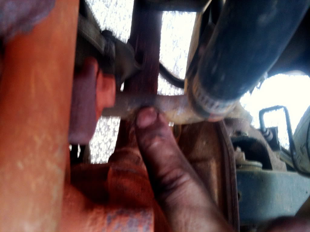

In the above picture at the back of the engine there is a black rubber hose that enters into a metal tube that goes into the block. There is a decent leak (steady drip) coming out of this leak from the bottom of the pipe where it meets the block. There is not a hole/crack in the pipe as I have checked that already. I'm guessing there is an o-ring that is bad where the pipe connects to the block. My questions is how do I disconnect this pipe to get to the gasket/o-ring to fix the leak?
Hopefully the head doesn't have to come off
Thanks for any and all help in advance

Ok. I have at 1993 22RE with 135k. I guess the pipe does not go into the block I wasn't really sure what they go back into specially I was just trying to say they go into the engine/heater core I don't really know here are some better pics. These are of two pipes that are on the DRIVERS side of a 22RE there is one in the middle and one further back the one in the BACK is the one that leaks. There is also a similar pipe that wraps around the back of the engine from passenger side guessing whatever this connects to the one I'm talking about is related too.
The above pic is of the front pipe my finger is touching. The other pipe thats further back is exactly the same rubber hose into metal pipe that goes into the timing cover as you said???

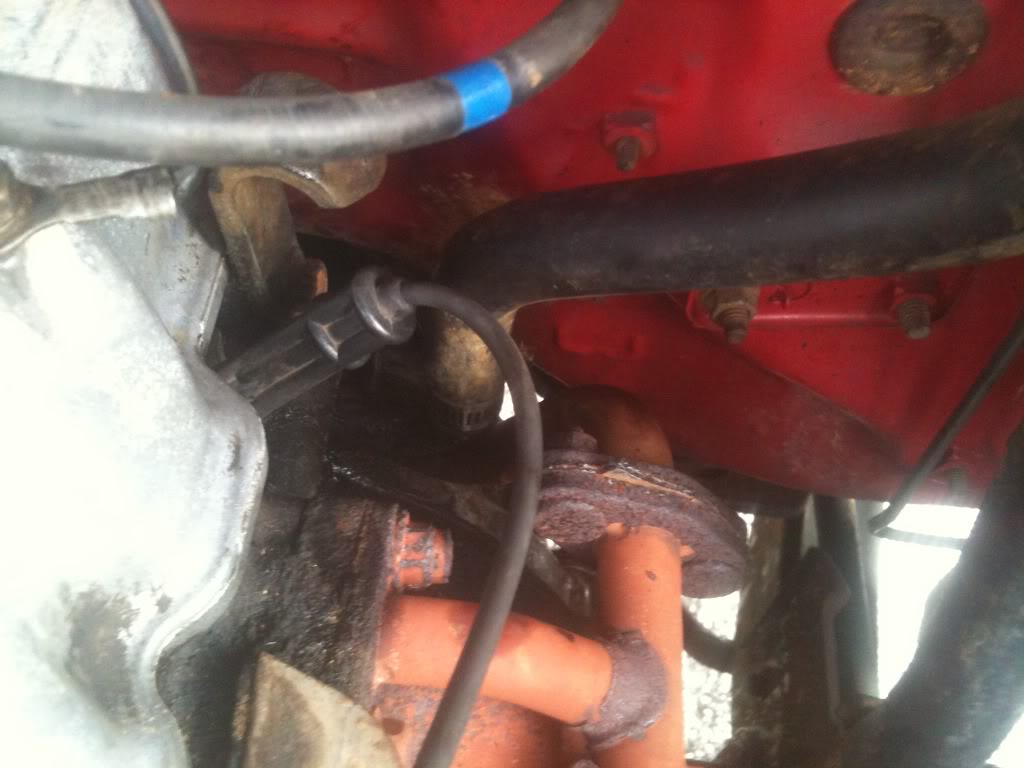

This above ^^^ picture you can see my finger again on the pipe this IS the one that leaks the valve cover is to my left and the pipe below it is part of the exhaust (EGR?)

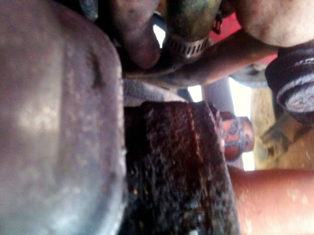

Side view of the pipe from drivers side of car you can see the clamp on the rubber and the metal pipe heading into the timing cover? I hope this helps. If you think anything else would help too let me know
PS Scuba I wasn't trying to offend. I did give ya the caps lock I just figured maybe my post was vague and I wanted to clarify where the leak was

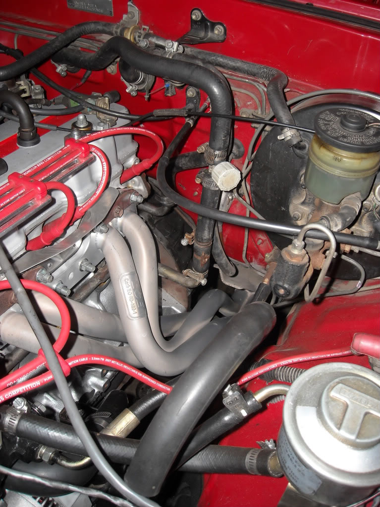

Dtroupe....
Here are some better pics, as it seems the pipes are VERY similar if not exactly the same as my 87 22RE.
In this picture, you can see both pipes coming from the heater hoses in the firewall, downward. The one on the right, most forward, you can see runs under the header in my pic and winds up in the back of the timing cover, driver side.....
The one in the rear/left in the above pic, at least on mine, disappears behind the head(where its' actually bolted to the back of the head block plate through one of the bolts)...then wraps around the pass. side of the block, behind the fuel filter, then straight up in the middle with another bend, into the intake in the middle, here.>>>>

Reach up above the oil filter and touch the pipe where it goes into the intake.... if you feel water there, that IS AN O-RING that's failed..... at the very least, the bolts are loose. 2 bolts, 10mm. I replaced mine with studs into the intake... that helped to keep it lined up as I installed it and once I broke the nuts free, they just spun off with the lock washers I used.... If you end up having to remove that, I CAN help you, if you want, with a step by step of how to remove it with the least amount of 'tear down' as possible. If it's NOT where it's leaking, we need more CLEAR info..... Use my pics to explain, using PAINT SHOP, exactly where the pipe is leaking.
PS> If you feel coolant leaking from behind the head, not over by the intake..... My guess is, while you might not wanna hear it(I wouldn't ), is that your head block plate is leaking and running off of the pipe, making it SEEM like the pipe is leaking.

Yeah those are the two pipes Im talking about. The one closer to the firewall is where the drip is it drips onto the bellhousing and then on the ground. So it's leaking on the drivers side not by the intake like yours was. Hope that helps? I can edit the photo and circle it if you want later let me know if you get what I'm talking about now
Old Jul 5, 2011 | 02:55 PM
dtroupe18's Avatar
Joined: Aug 2010
Posts: 32
To be most specific the two pipes that the hoses come down from the firewall on and they are both visible in the first pic you have
