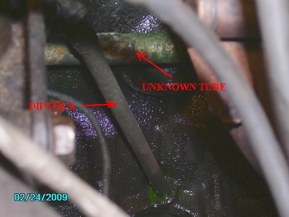

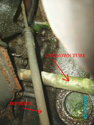

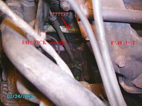

i've been dealing with my coolant leak for too long now, so i finally decided to try to fix it now that i'm laid off and bored at home. it's not getting into the oil (i have black oil) and it's not getting into the combustion chamber (no smoke). it's just leaking and therefore i've just been adding coolant when the heat suddenly starts blowing cold and/or when the temp guage suddenly starts to rise from the midway point. i don't know exactly where the leak is coming from, hence why i'm writing this. it's coming from somewhere on the exhaust side of the engine (22re), near the front, above the dipstick (according to some green evidence that i can see). i fear that it's a head gasket leak. but at the same time, i'm wondering if maybe it could be water pump related? the water pump is pretty close in latitude from where this appears to be. also, what the heck is that pipe that goes horizontally, front to back, under the exhaust manifold right about in the head gasket area? is that coolant related? check the pics. i haven't figured out how to add pics that are bigger than 48kb, so they are small and kinda hard to see. but i have the fullsize ones if needed.

To me it looks like it could be leaking from a freeze plug .I have no idea of what that pipe is ..lol I should know .

That "unknown" tube is a coolant passage to the firewall or rear of engine, I think.

Where I made the Black dot is the freeze plug . A freeze plug is an expansion plug located in the side of an engine block that is supposed to protect the block against freeze damage. Water expands when it turns to ice, and if the coolant doesn't have enough antifreeze protection it can freeze and crack the engine block.
After looking closer .. it look like its leaking from the head gasket . I used a black arrow also to point out where I think it's leaking from . .

that "unknown tube" is the return from the heater core (back to the water pump).
Since the leak is above that tube, I'd have to say it looks like a head gasket leak.
