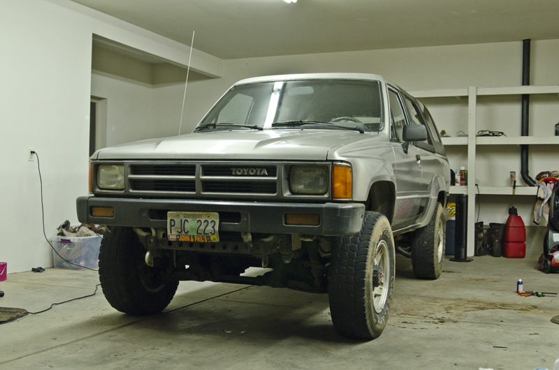

Hey yota techers,
I picked up an 88 4runner last week with what I thought was a blown headgasket. There was no coolant in oil, compression was mid 150s throughout (although I did not measure with Throttle Wide Open), no bubbles in the coolant, but it was steaming and sputtering water out the exhaust.
I finally pulled the head last night and found that all 4 cylinders were full of coolant, the weird thing is the head gasket did not look obviously blown. I know they can be leaky without blowing all the way but with coolant in all cylinders I would expect to see more damage to it.
Could the leak be coming from the intake manifold?
Any other Ideas?
Sorry if im missing something obvious, this is the first time I have worked on a car beyond an oil change. I did try searching.
Thanks guys! cant wait to get her out on the trails
