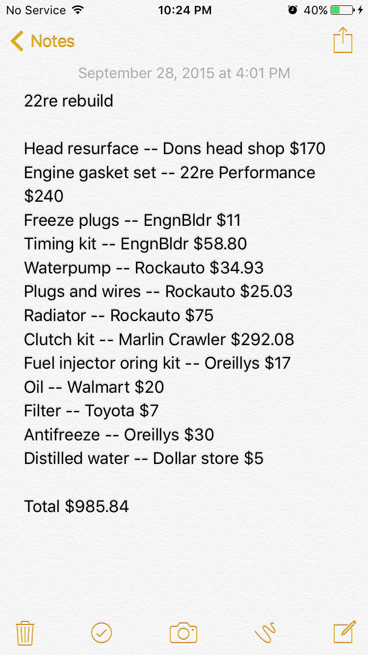

Mine was torn down completly and every piece cleaned and inspected. Reused bearings and rings, cylinders still had cross hatching 164k on engine. I elected to go with 22re Performance full gasket kit. They claim oe gaskets and they did look the part. Plus they add the aluminum half moons for the head/valve cover. All in i was under $1000 minus degreaser

Regency:: You coulda added rings and bearings for about $100. Seems to me you did a lot of work for little return.

Why change the rings if the gap is well within spec? The only issue this engine had was bad head gasket. To me as long as everything is within spec then im going to run it, on my personal vehicles.
If i woulda thought they were questionable i would have changed them but i had an understanding of the history of the truck and all was well
