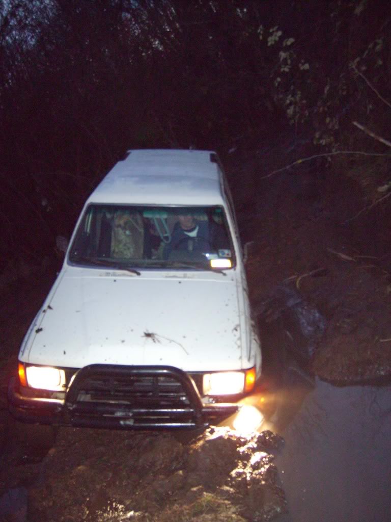

This was the time I tried to use the Hilift for a winch. The video had me pumped too. I didn't like it cause there is no way to do it without being in the way of a kickback. I'm sure it can be done. I got a T-max so perhaps I'll never find out, makes a good jack though.

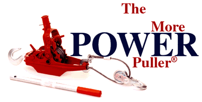

yes and this one works awesome!
http://www.izook.com/reviews/mppuller/mppuller.htm

I have had one of those for about 20 years (I'm an old fart) It is about due for a new cable but they are awesome. Wyeth Scott has been making them for about 100 years or more. has 20 feet of cable on it.
Works front or rear, to the side and portable
I have probably gotten enough beer and misc small cash payments over the years helping people out to have paid for it.

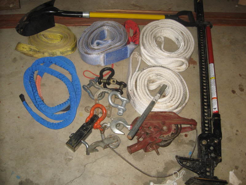

An a shovel also makes self recovery easier....
Hi Lift is a valuable tool but also practice with it. I still want a winch but here is what I take wheeling with me:
comealong and a high lift won't do squat for you if you don't have attachment or lifting points to hook up to...IE bumpers, sliders.

i keep a comealong in my rig even with a winch. they have saved my ass many times. but i would go with a comealong with a snatch block on the hook end and not a direct pull line like the first one pictured.
