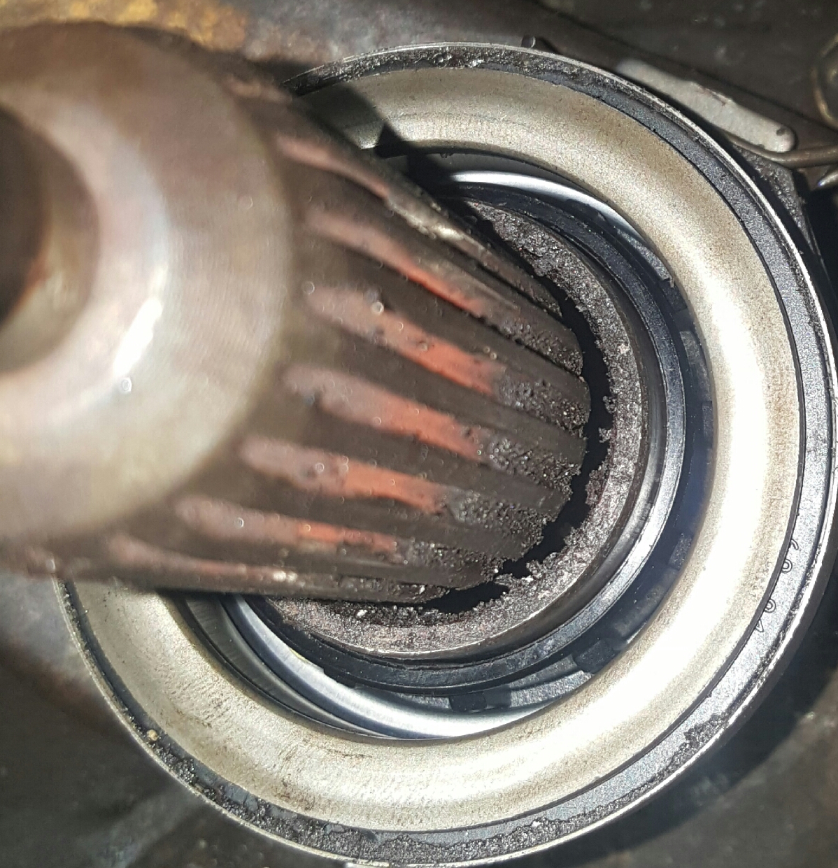

Hey guys need some help on my truck i have a 92 22re and im having a problem with my clutch or possibly throwout bearing i recently installed a new clutch kit because throw out bearing was bad ever since i replaced it all i cant get into gear i have bled the system checkecd for cracked pedal etc idk if the throwout is wrong ....truck was running with the bad throwout bearing but wont run with new clutch kit pls help thanks
First pic is whats installed second pic is what google gives me when searching

There are 2 different styles of bearings for these trucks. I prefer the one with the single wire clip that is showing on the right side of the page. If you look at the front of that bearing, it will have an orange stripe around the front of it and in my opinion is the better bearing.
The bearing on the left side of the picture, as two black clips that attach the bearing to the clutch fork.It is a good bearing and will do the job.I am not sure which bearing a 92 uses but I am almost sure they are interchangeable as I have done it on other trucks.
When you had your flywheel turned, as I understand it, there is a special step in having a flywheel turned to the correct way of meeting Toyota specs. If I recall right, It was $20 to have a fly wheel turned and $25 to buy a new fly wheel from Oriellys.
Is the Clutch Slave Cylinder extending as far as needed? I have had issues with a slave cylinder causing same problem as you are having. Really not a lot of distance from slave cylinder engaging or disengaging the clutch.

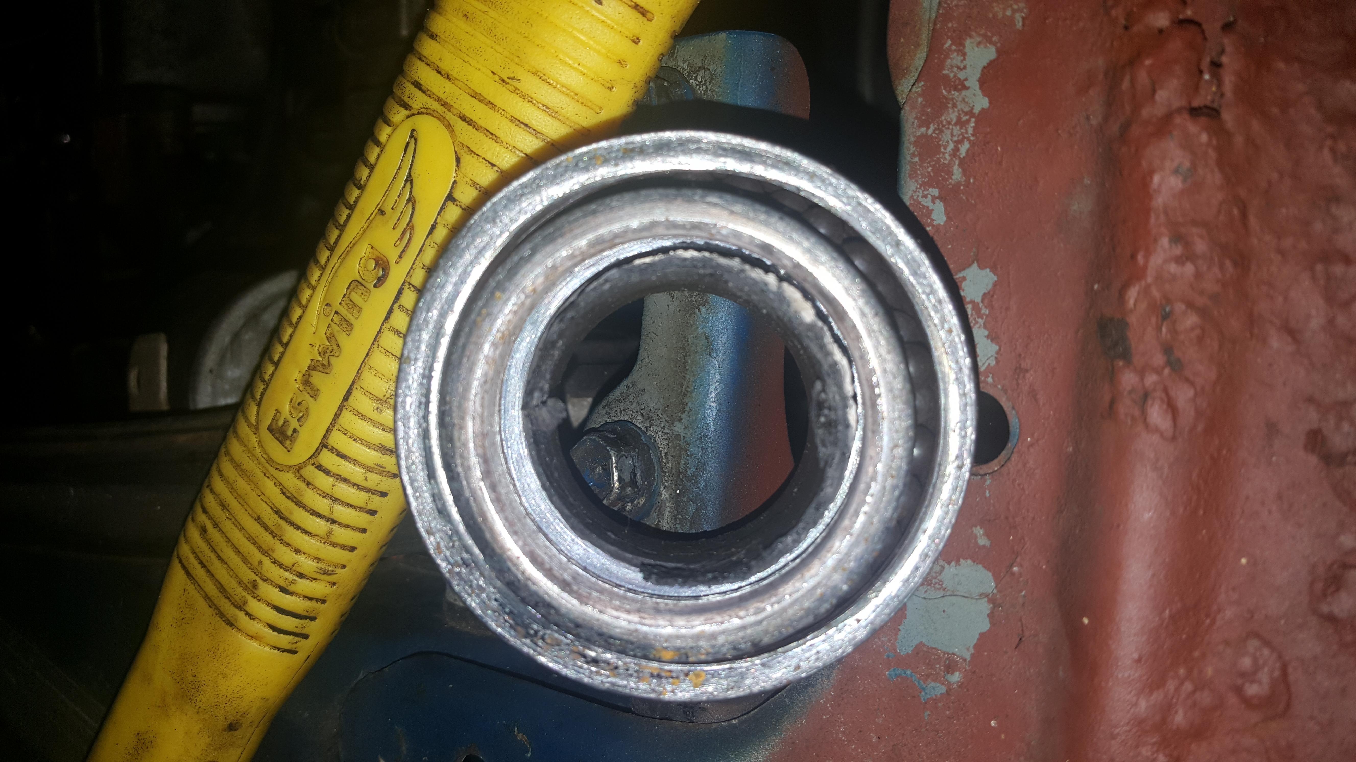

The throwout that i took out

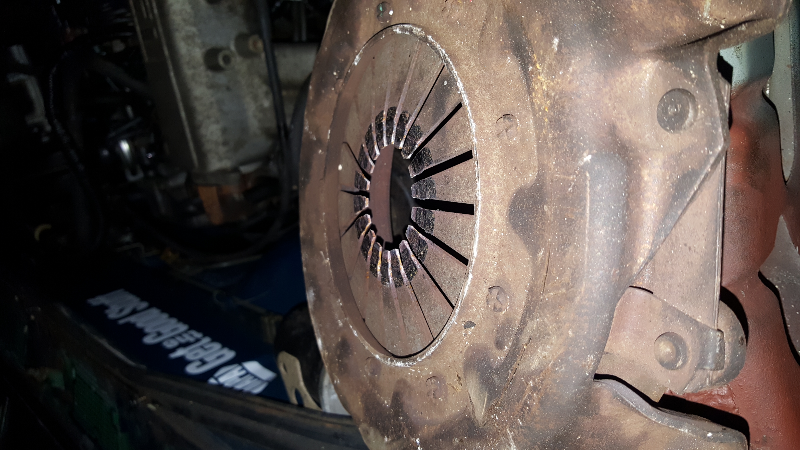

Possibly defective pressure plate stock vs napa luk clutch kit

Are you able to shift it into gear with the engine turned off, then start the truck with the clutch pushed in? When doing this 1 of 2 things will happen. The truck will start and move when the clutch pedal is let out, or the truck will lurch forward while turning over with starter. If it lurches forward this is telling you there is an issue with the engagement. Sorry to tell you, but most likely you are pulling the tranny back out. Sounds like The wrong clutch kit for your truck to me. Hope this helps

yes im able to shift into gears while engine is off I can start the truck while pressing the clutch when its on first and when I release truck moves but then I have to turn it off to disengage.. Yes it seems to me that I have to take apart the trains again to get the right pressure plate or use the old pressure plate truck was shifting good with old jacked up bearing I think the issue looks like the pressure plate forks are not in a cone pattern as the stock plate looks the luk pressure plate dips in not making the throw out bearing engage fully
