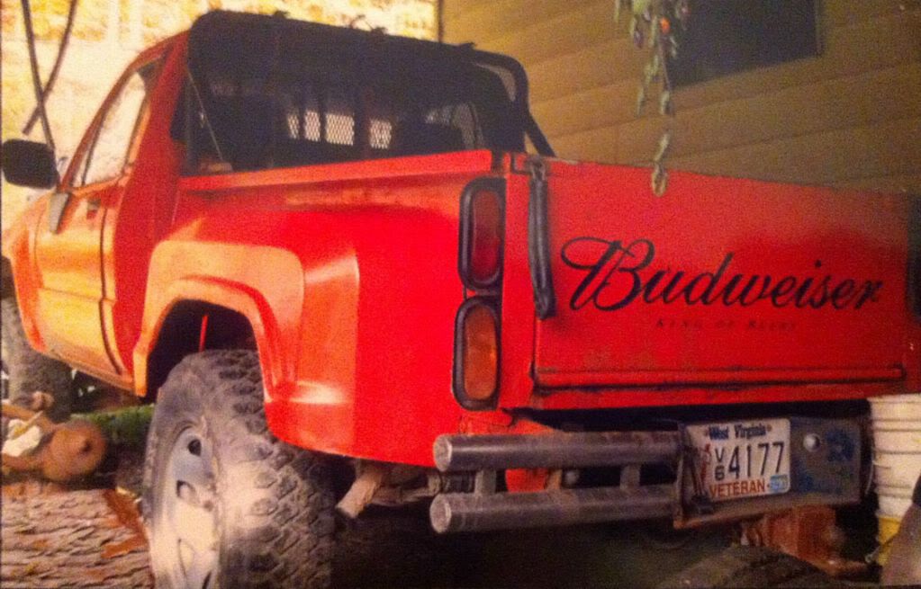

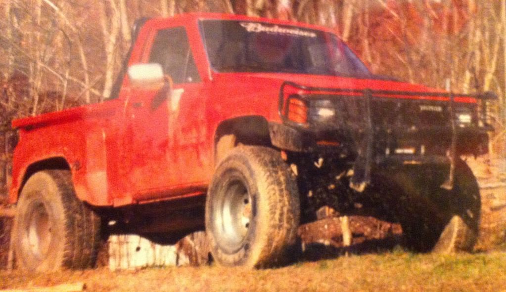

As some of you know I built a built a step side bed for a previously owned Toyota of mine. The bed was scratch built using only the Chevrolet fenders. I have seen numerous post on this site asking about transforming a stock Chevy step side over to a Toyota. So here it is. I'm going to put together a build thread of how to do it. This will not be a one week project. It may take awhile as I work everyday but Sunday.

I will include accurate measurements along with some drawings to help everyone out. I do not have any pics of the bed yet however here is a pic of the one I made a few years back.
