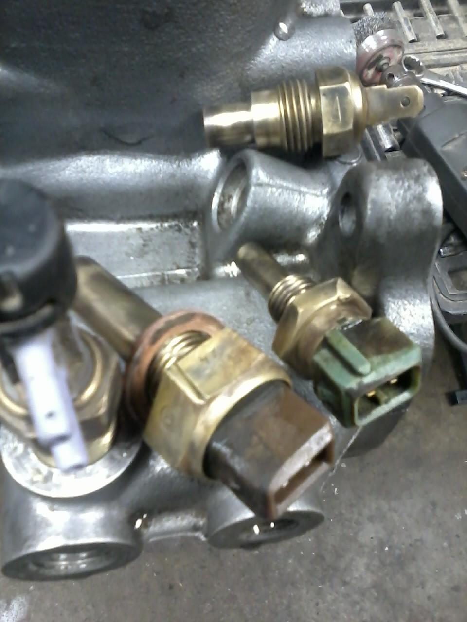

I had to take two intakes and make one. Here are the dirty sensors. Cleaning temp guage one in between #2 and #3 cylinders has helped my temp guage to be more stable then jumping around.(Top Right).

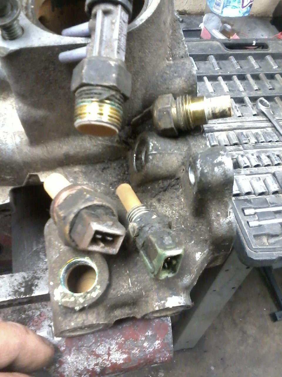

Here they are cleaned. I just use a brass tooth brush and water to get them cleaned. The manual says to wrap the Cold Start Injector Time Switch (Sensor with Brown top)with plumbers tape. I do them all. I haven done it yet but will when I put the motor together.

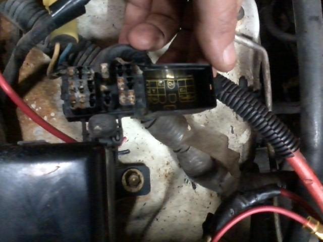

Here is my 88 Diagnostic Port. I believe it is the same as the 89-94. I can try to get a better picture of it if needed.

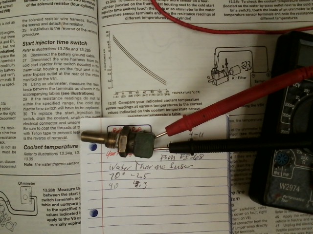

I put the Water Temp Sensor in the freezer for about 30 minutes and then did resistance checks on it. At about 40 degrees it was 4.3k ohms as the temperature rose, the resistance decreased as it should. At about 70 degrees it was 2.5k ohms. I got the test from Haynes Manual page 4-11 Section 13.35. I have an 85 Factory Service Manual and the test are the same. Most wont have an FSM so will refer to Haynes where test are the same.
On 85 an 88s the Water Temp Sensor are the same.
