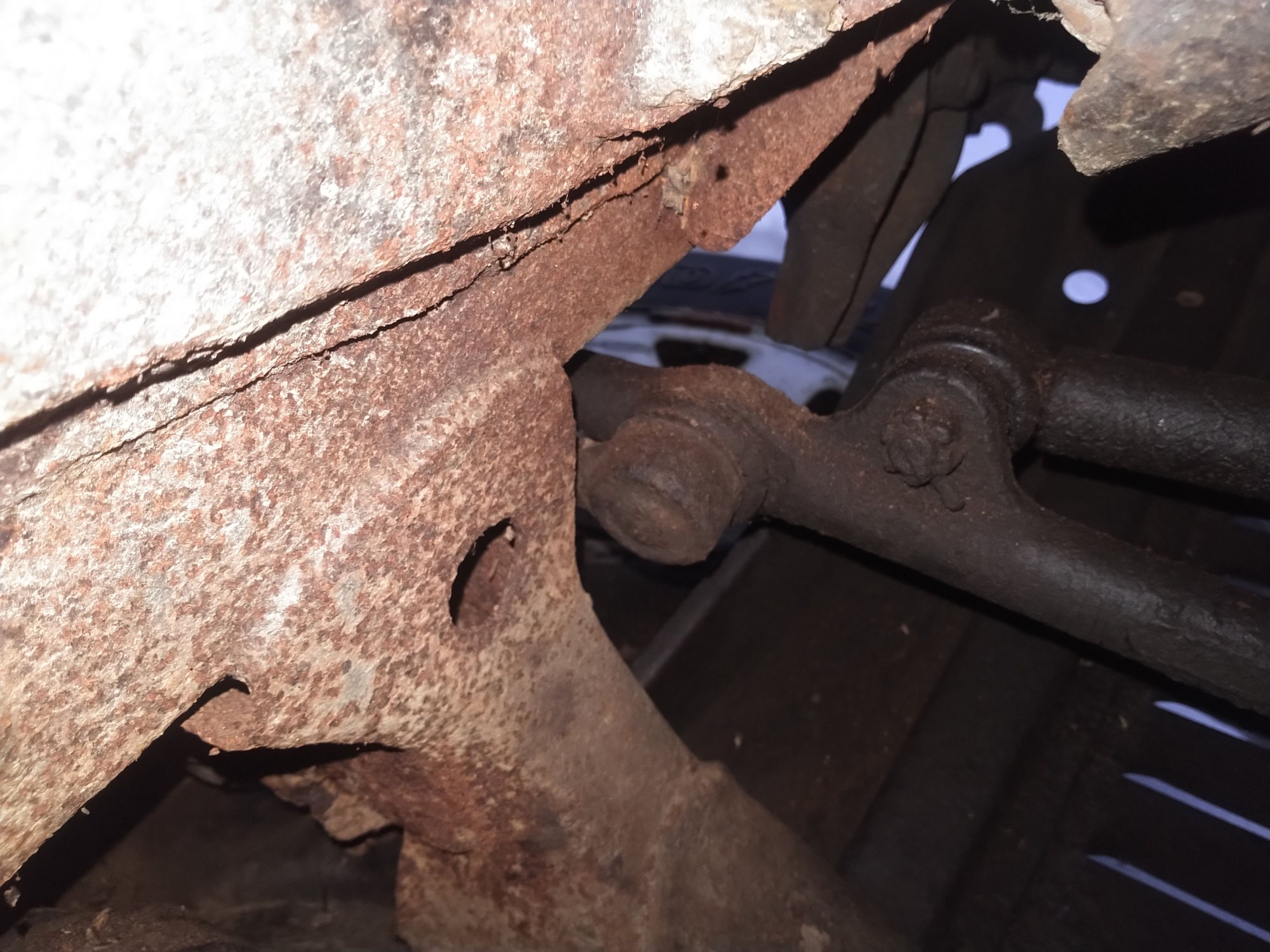

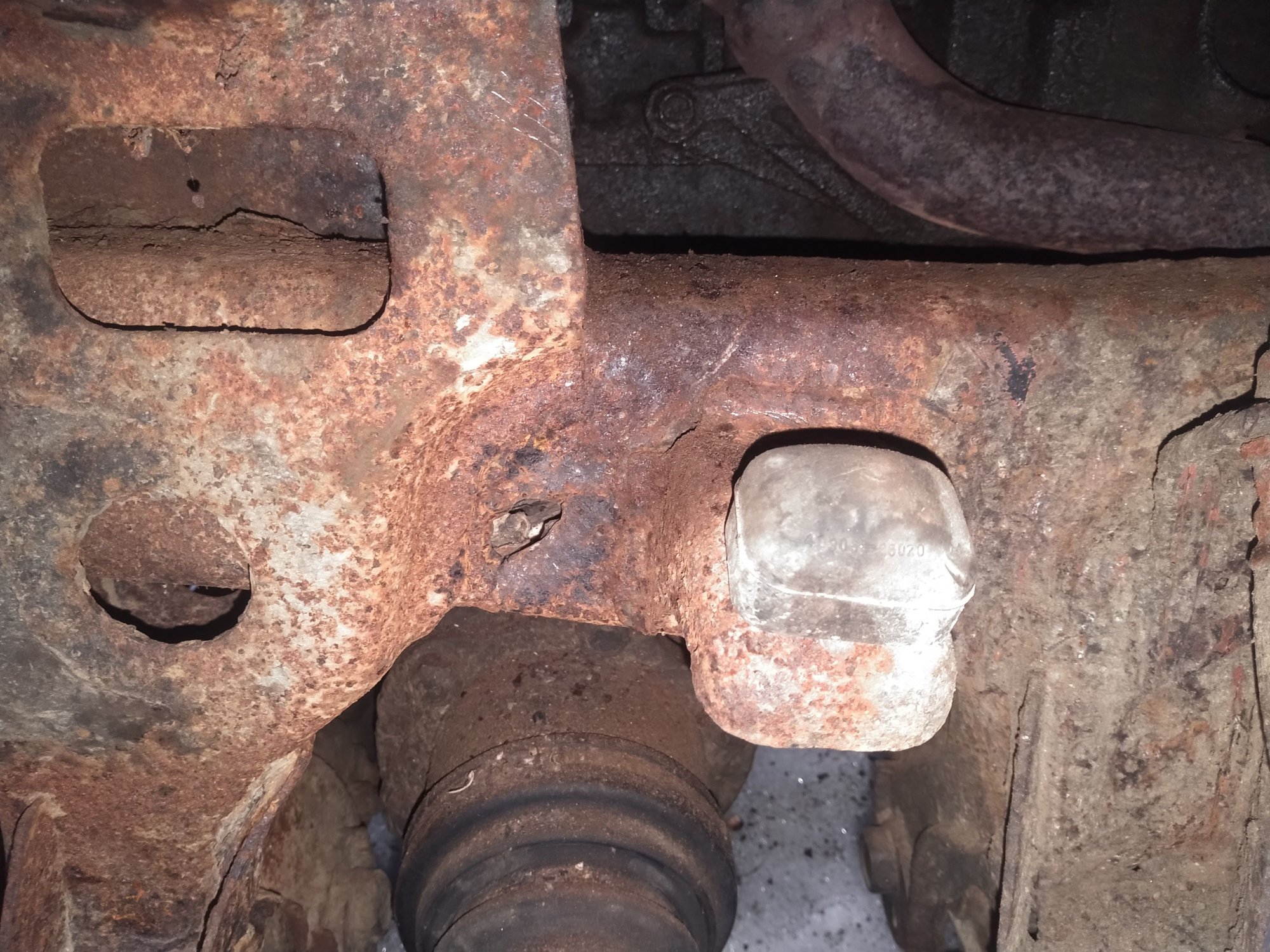

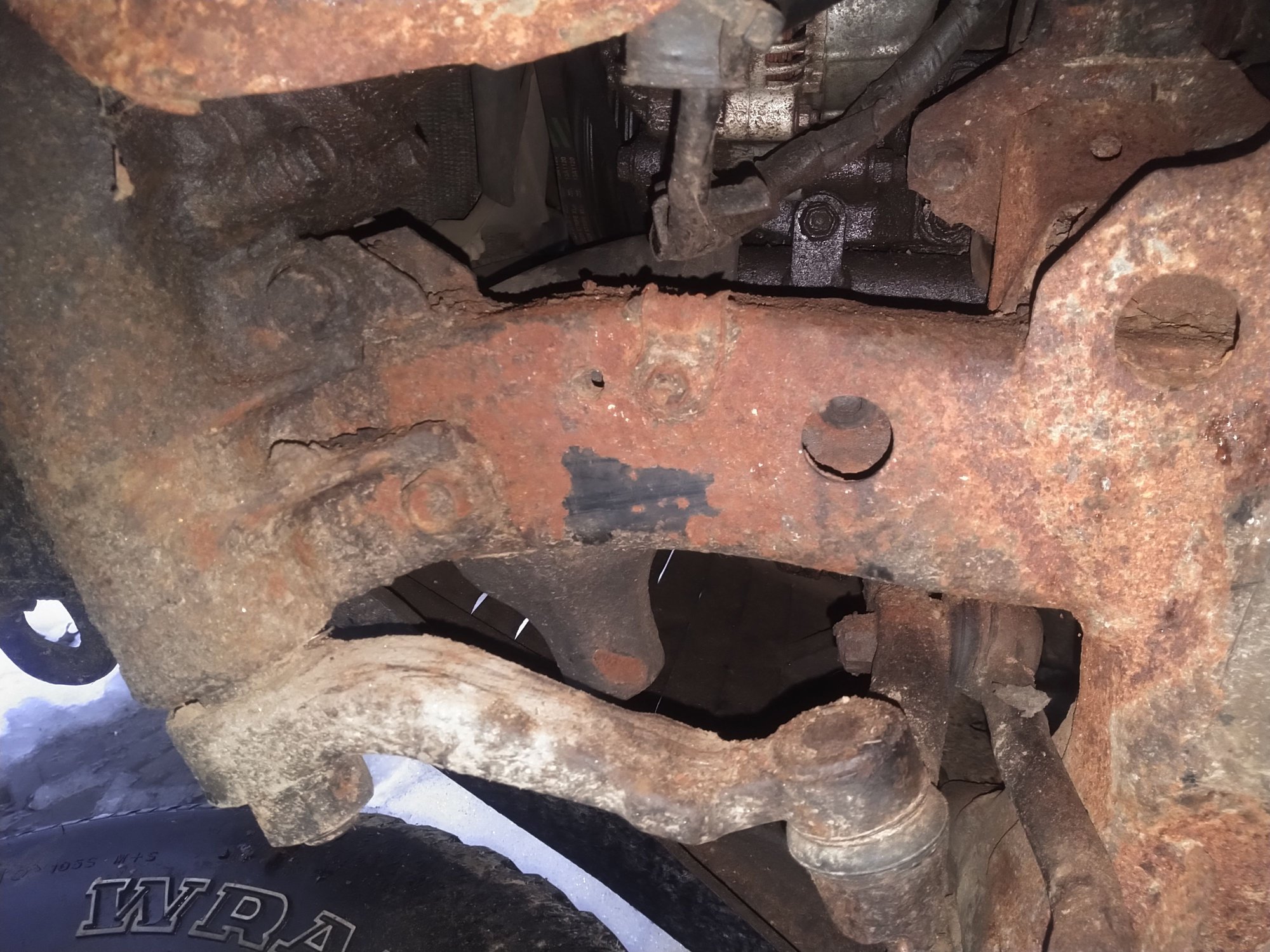

So, I recently picked up a yota with 2 parts trucks and the one in photo below is the bet if the three.

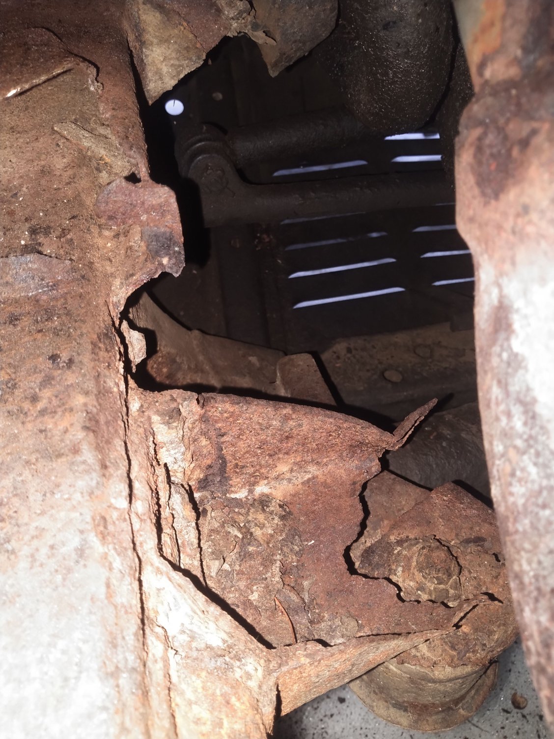

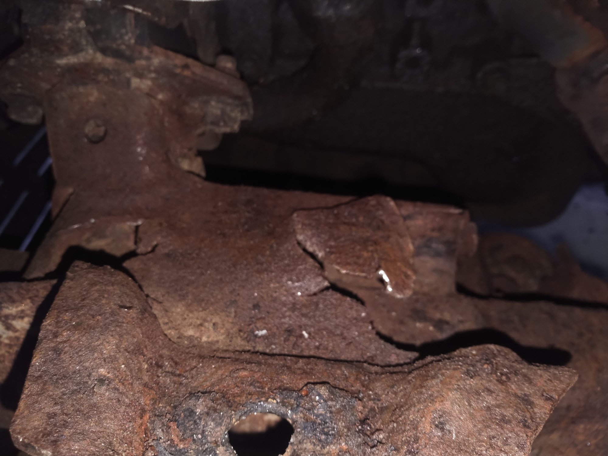

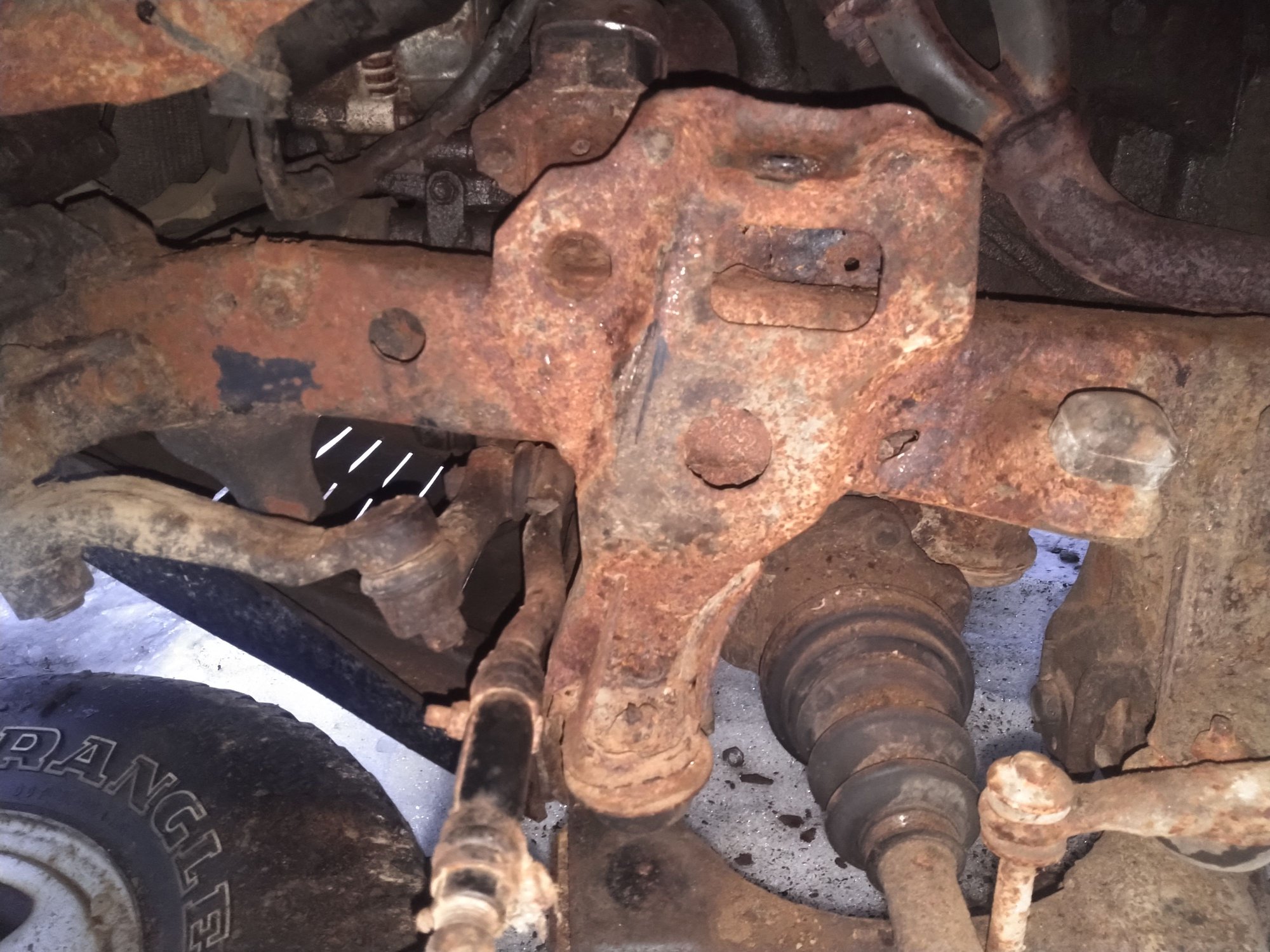

Only real issue is frame damage on the front driver side. The PO was bombing down a farm road and managed to rip the upper control arm out of the frame. While digging around I noticed the rear front differential mount was completely rotten. I think this may be the root cause because the metal surrounding the UCA mount is pretty good. Weldable even.
My question is, does anyone make a beefier UCA mount that includes motor mount & shock mount? What about after market bump stop mount and diff mount?

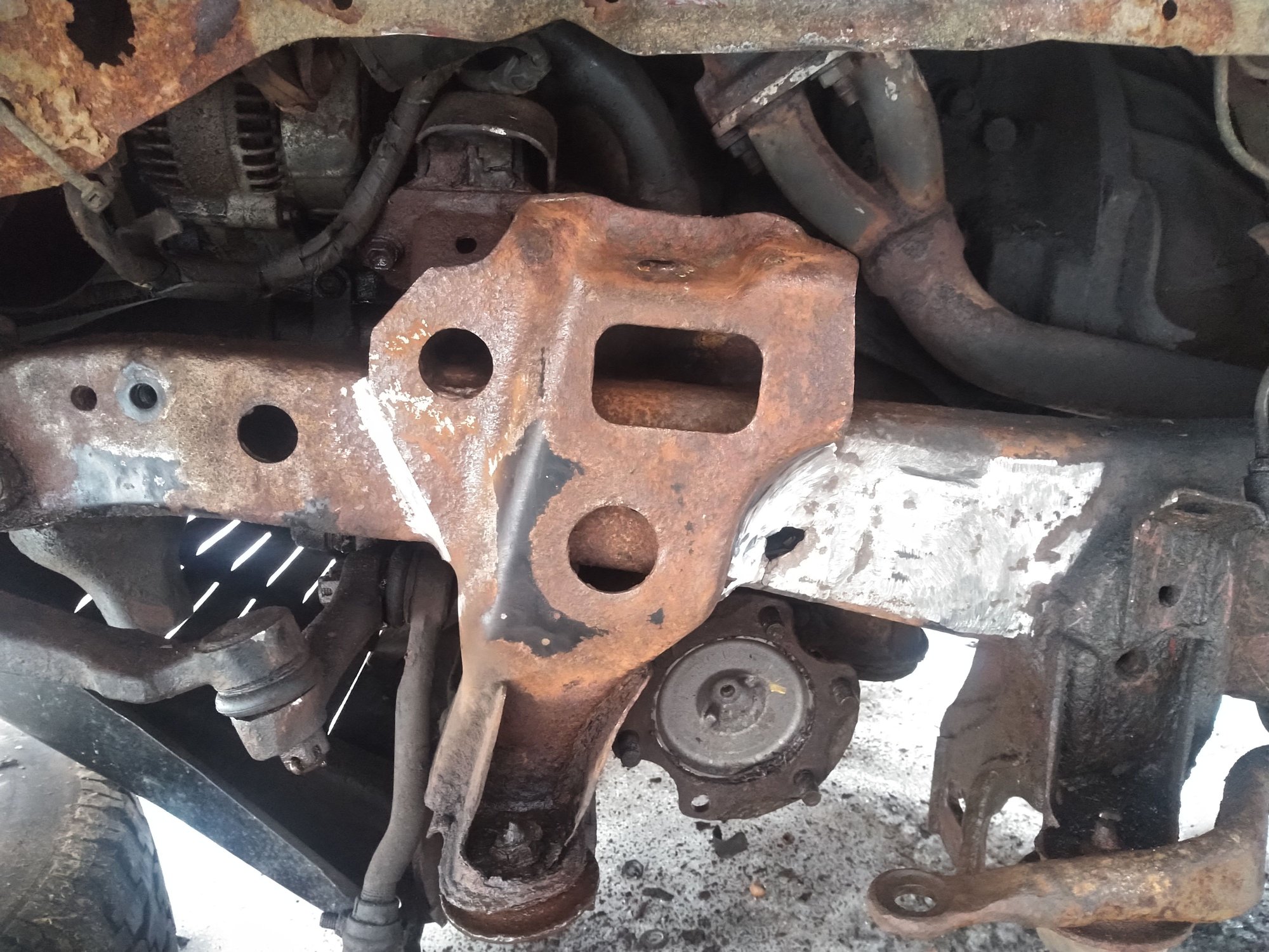

Turns out there is quite a bit of good metal under there. Looks like the diff mount isn't really all that great to begin with. A little cutting and a little welding might just do the trick.
