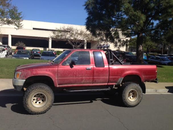

Post some pics. I think it will be too high with a 5in lift with 32's. Why not uninstall the 5in lift and keep the body lift?

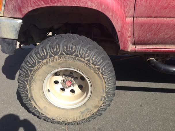

Thanks for the replies. Here are a couple pics as she sits right now. Second one is one of the rims in question.
It would be cool if I could just get 10.5" tires and be done with it. I don't need any type of spacers or anything to make up the extra 2 inches?
I was just thinking about getting rid of the body lift as it's pretty useless for everything except fitting larger tires, which is what I'm trying to get away from.
Basically I'm trying to turn the truck into more of a daily driver. I guess 33 x 10.5 wouldn't hurt my gas mileage all that much instead of a 32.
Attached Thumbnails Changing for a 12.5 to a 10.5 Tire-yota1.jpg   Changing for a 12.5 to a 10.5 Tire-yota2.jpg

Looks like those rims are 10in wide

I agree..looks like 15x10" wheels to me. I ran the 10.50's on my 10" wheels. I wouldnt recommend airing them down as they would come off the bead easily. I ran them for probably 20k like thst with no issues
