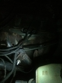

sorry for the poor quality, flash light and an ipod at night

You have to post a pic before you can apologize for the quality.

Kind of odd the O2 is there 'tween 1 and 2, and there's a flange on #3 cylinder.

it is odd, but it came with the truck so I don't have much of a choice on it right now

And looking closer, the flange on #3 looks like it would be better suited to an EGR or air injection connection than O2- looks like an O2 there would hit #2 runner.
Even still, a 1 wire on #2 will cool off enough if there's enough air coming through the radiator. The factory had the 1 wire in a boss in the CAST IRON manifold between 2 & 3, and the iron held enough heat to keep it hot.
You could try a universal, heated one and see how it goes. Not sure about your emissions laws there though.... There's another thread bouncing around about a similar issue so maybe look it up, if you haven't already.
