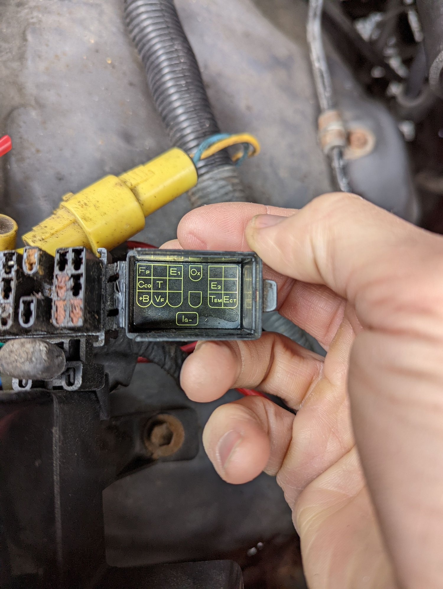

want to run the diagnostic check for codes by jumping e1 and te1
, but on my 87 4runner i dont see any te1 pin. sounds like 87 was the year of transitioning to the diagnostic plug so it was different than other years. any idea on how to run diagnostic test?

Jump T and E1

Thanks man, worked perfect!
