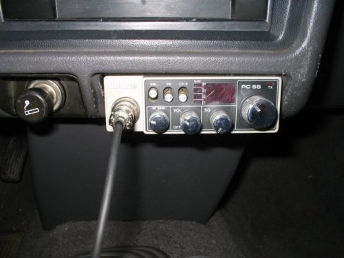

The Uniden radios that fit are the PRO 520 XL and PRO 510 XL. There is an older radio, the PC-55 that is the same form factor and will work, too (it's basically the same radio as the PRO 520). Don't know about Cobra or Radio Shack, though I do think there might be others that will fit.

The Uniden is definitely the widest radio that will fit in there - it's pretty tight. My RS had a bit of room on either side.
