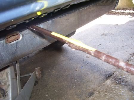

Well,well,well...I got that friggin' spare down and out w/out having to hack anything.
I had her soaking over night with some "Knock'er Loose" from CRC.
Pic's below:
The blasted pieces of scrap metal Yota supplies to get spare down. The smaller pieces I got from a friend a few years ago...the long piece was in my rig when I bought it.
The handle. This hole is supposed to be square!(but,not)
The method to my madness.
I put this piece of tape on to make sure it wasn't slipping around. The bolts that hold it together were wiped out from the previous night's attempt.

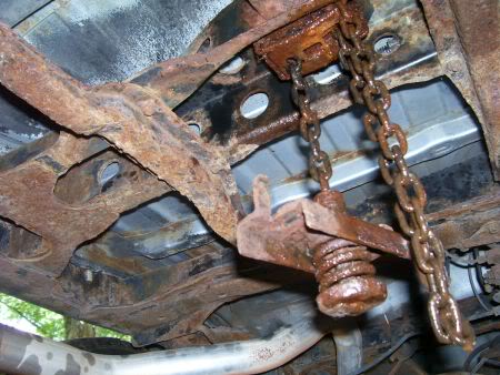

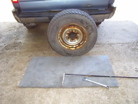

OUT FINALLY! Yup...gonna dismount the tire,clean the rim up,repaint.

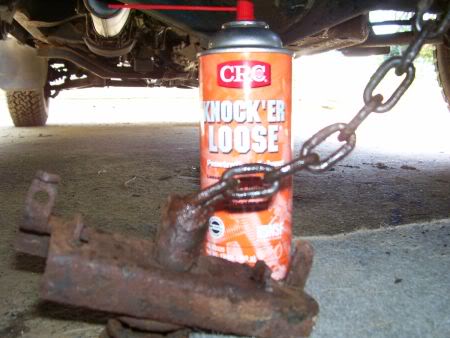

Some pretty good stuff!

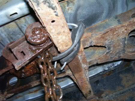

Got her soaking and gonna continue to do so,and keep working the mechanics for a few days yet to make sure it's good. It actually works really good now. Im soakin the 3 mounting bolts to get the assembly out to clean it up good. Upon re-install,it's getting about a full can of Anti-Seize globbed on it all:>)
