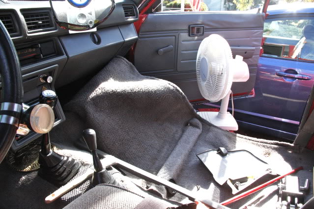

Welcome to the leak club. You may have rust in your windshield channel
Pull the seats and carpet, or at least raise the carpet and get a fan in there. Good luck.

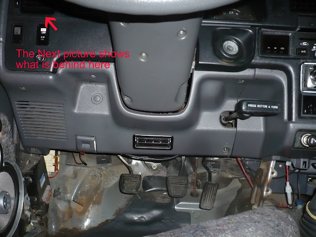

Pics inside dash
So, I went ahead and started pulling a few things apart. This picture here is the base of my driver side Dash, which sets you up to know what you are looking at in the next picture.
this is where I think the water is coming from. It's behind the driver side vent. I have no idea what that thing is called (the part that's covered in rust)
I'm beginning to think it's not my window that is leaking, but the cowling, or the part above the left-front tire.
