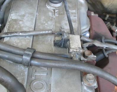

Ok where is the a/c idle up vsv? Is it on the valve cover? Does it have two vacuum lines going to the plastic screw adjuster that is next to the F in EFI? If so mine is not connected at all. I have found several sets of wires dangling under the intake manifold. One set is W-G and W-R, one is blue and W-Black, and one is a single green. I looked in my haynes manual and found that the A/C idle up vsv has a W-G and W-R going to it so...? Any ideas?

Can you post pics of your underhood mess?

Ok here they are.
Attached Thumbnails A/C Problems still...-yota-vsv-004.jpg   A/C Problems still...-yota-vsv-005.jpg   A/C Problems still...-yota-vsv-006.jpg

could be overcharged. too much pressure in the system.... can affect your idle and everything.

Holy Crap! Did they just cut it off??!? I think I may have what you need; let me check when I get home....

Yeah they just cut it off. I've been drivin like this for a year!
