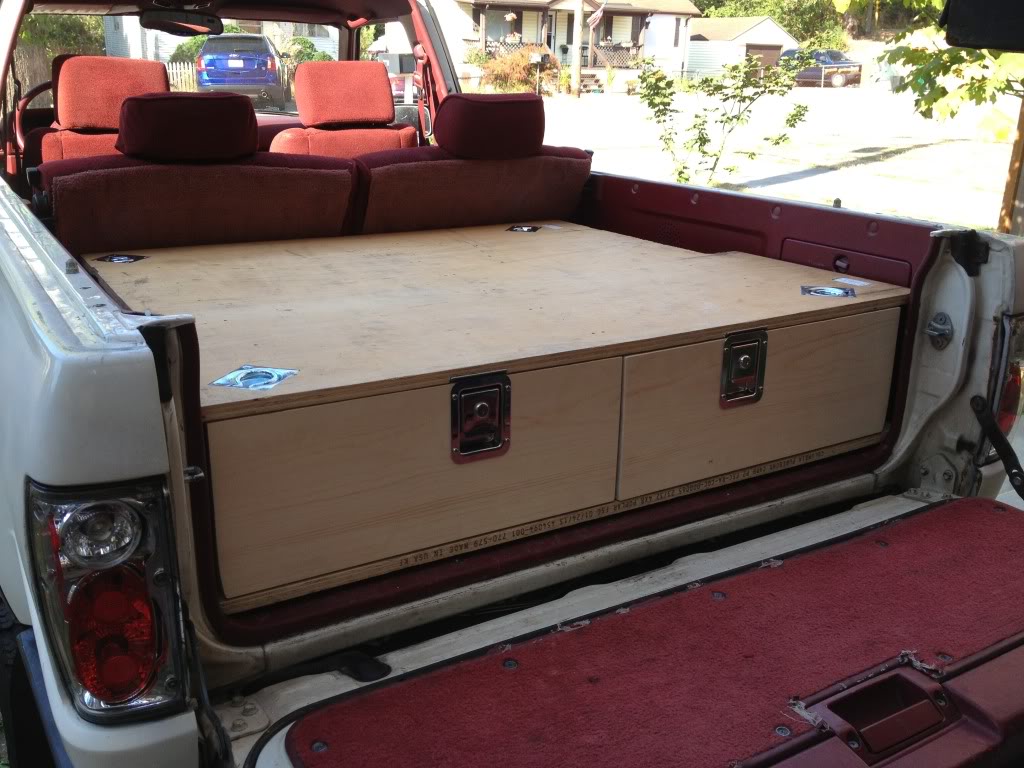

Here are some pictures so far. Keep in mind it is not done yet.

That is a thing of beauty. Are you worried about the excess weight at all? Do you need to fasten it to the floor in some way?
Old Aug 18, 2013 | 05:02 PM
helipilot77's Avatar
Joined: Nov 2011
Posts: 122
From: Seattle, WA
It is heavy. But I am used to always having lots of weight in my truck. I may end up fastening it to the floor somehow. But for now it is very well trapped by the roll bar. We'll see. I also have an additional board that folds out over the rear seats to make a flat sleeping area.

That platform must be for a 4Runner, because of the woofer?

Wow man that is awesome! I love the incorporated drawers to stow stuff in and the sub. How much you reckon it weighs?

I am guessing that it weighs about 100 lbs. empty. I have also incorporated an inverter that is wired into a pair of flush mounted outlets. There are also flush mounted tie downs. I have to give credit to skyrat since I am copying a lot of his ideas. I will be installing paddle latches on the drawer fronts like skyrat did.

Oh wow I was thinking it would be at least 100 lbs heavier. Well good work man thats awesome haha really inspires me.

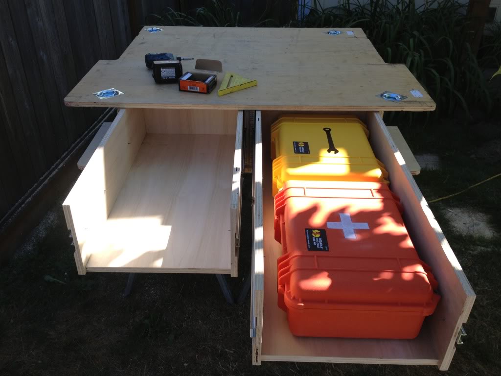

Just want to confirm -- you're not keeping/removing anything in those side pockets that you might possibly need (like recovery tools) though, right?

they are actually still accessible. The front of the drawer is wider than the drawer itself. when it is opened it provides access to the side cubbies.
