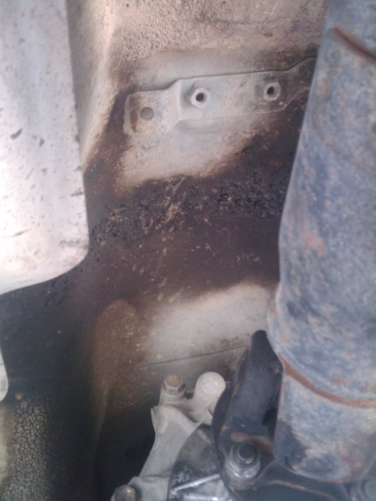

If you look up from below above drive shaft you should see two attached brackets about 7-8" apart (front/back). If you see the seatbelt "body nuts" on the side of the hump the rear bracket will be near them on the flat underside of the hump.
If I remember right they are a 5mm size. If you lift the carpet in the cab there should be locater dimples for drilling or stickers covering the holes I can't remember which. I think the latter.

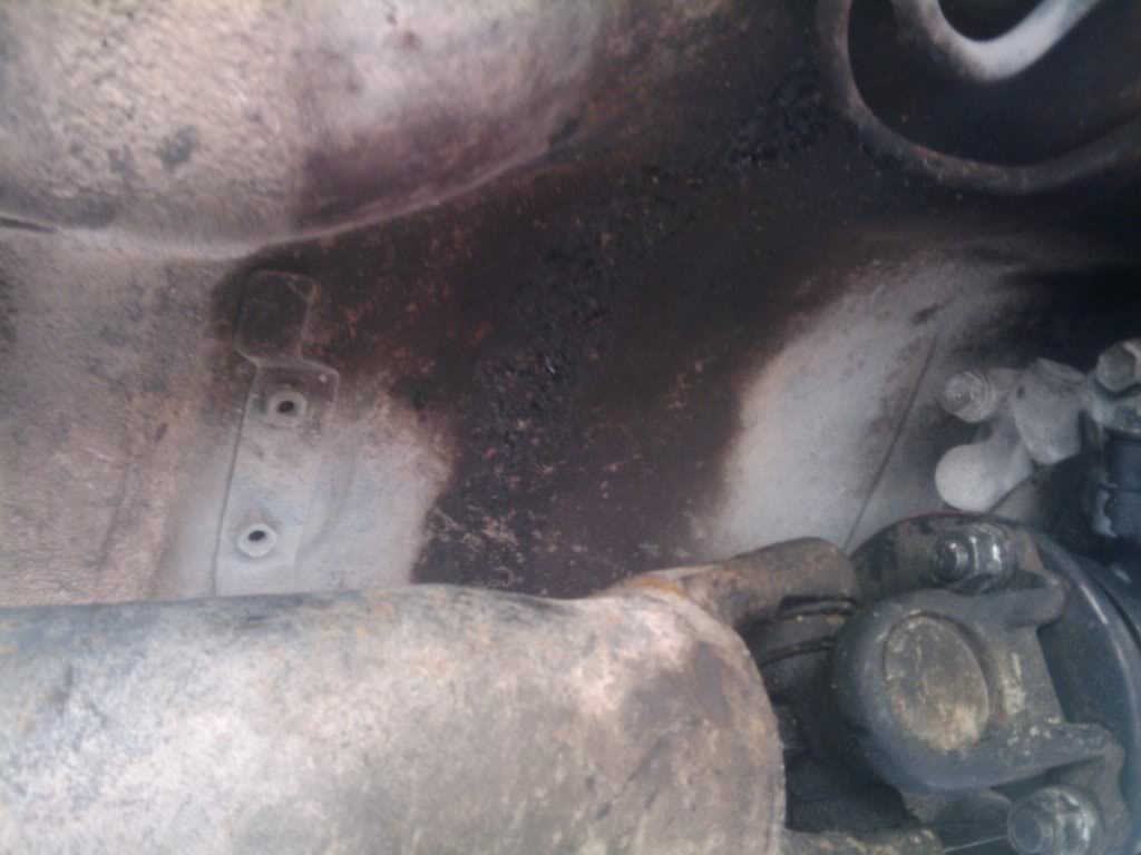

This is what i got.

Is that what you are talking about? I dont see any more holes all the way up as far as i can see.

Those holes in the picture go all the way through. They are covered by tape underneath the carpet.
If you don't want to take out the carpet, cut an X where the console would sit. You'll find them.

Are those the holes you were talking about. Should hold it in place..

yeah, cause you converted from a bench right? the holes are for the original center console on a bucket seat model. screw up from under nieth so you can feel where they are under the carpet and poke a hole there. just as they say, it's a couple stickers sealing out water and cold....
