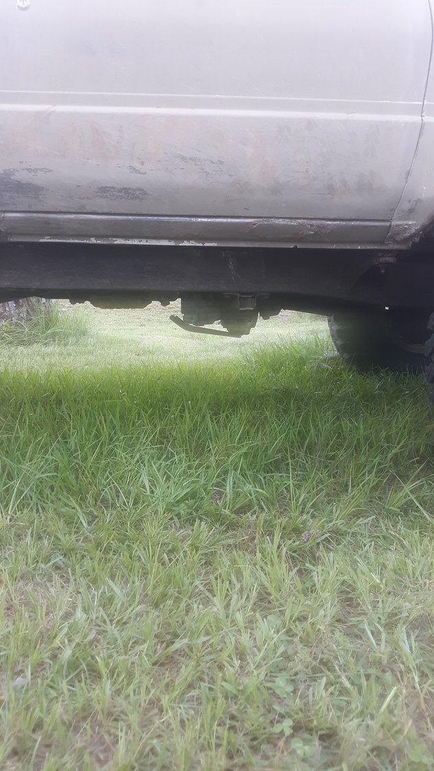

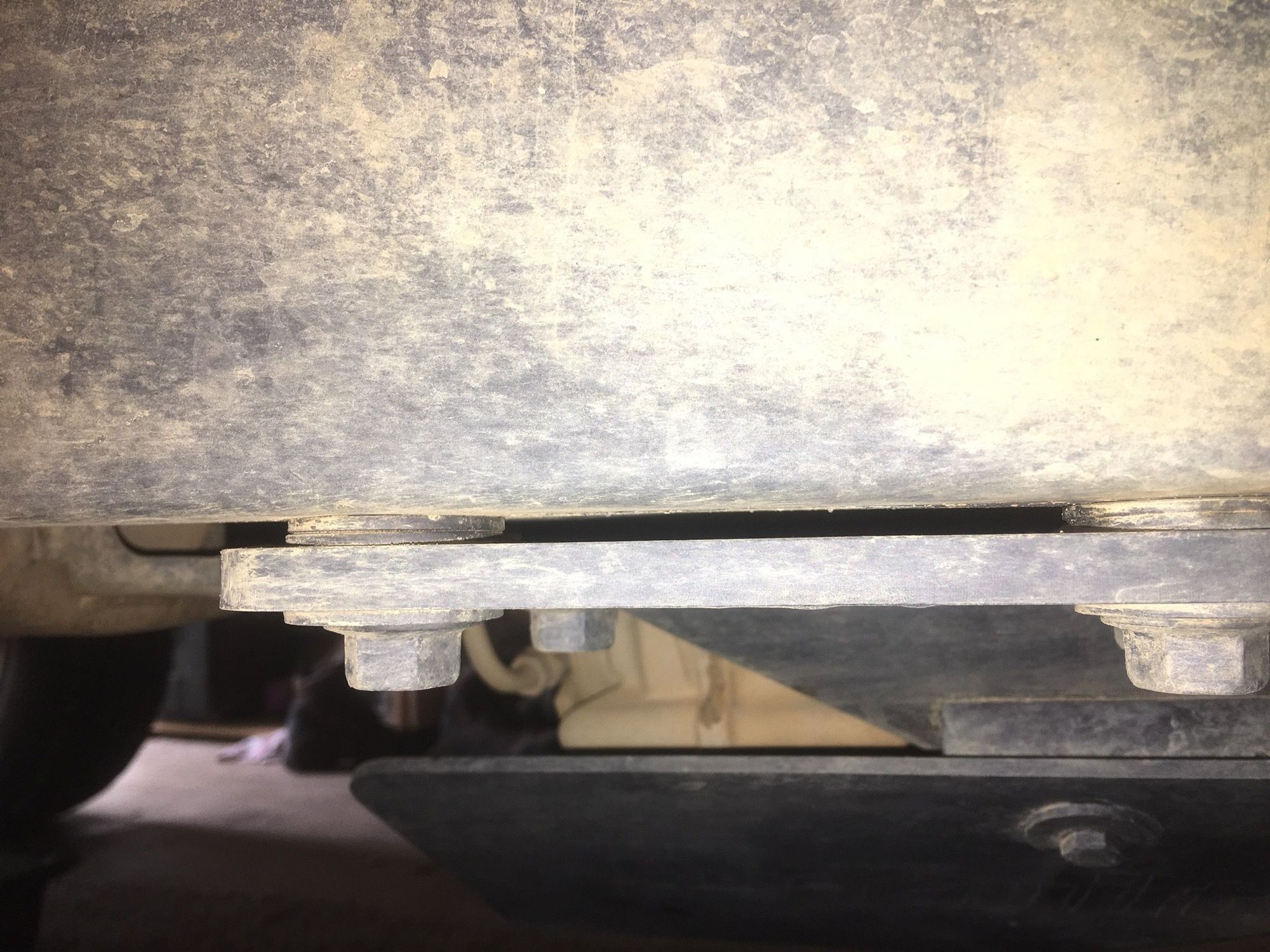

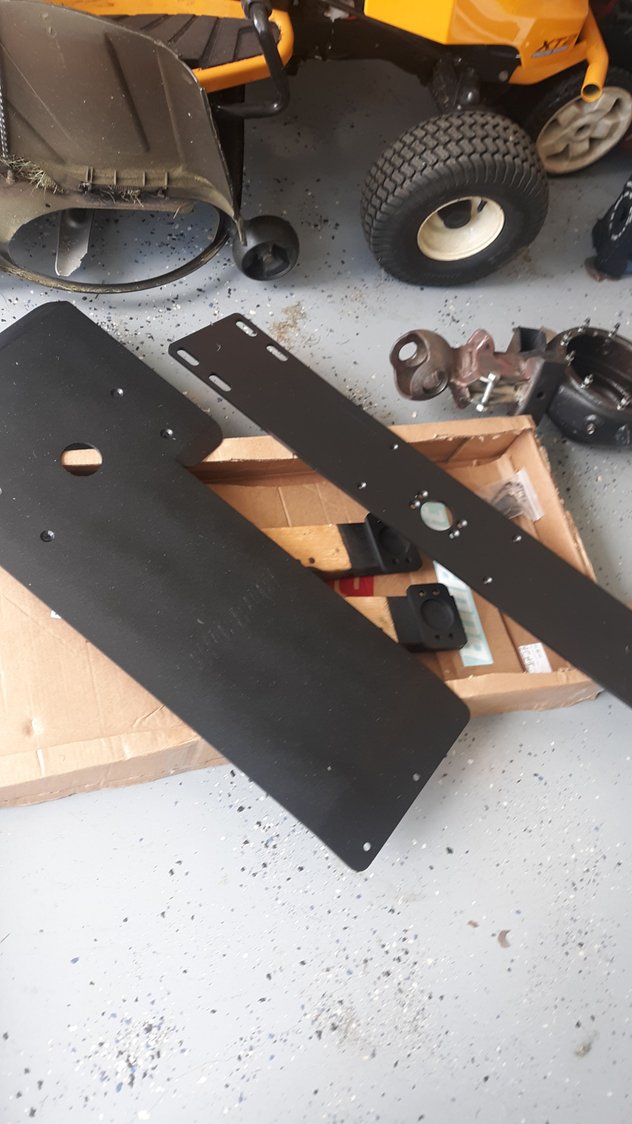

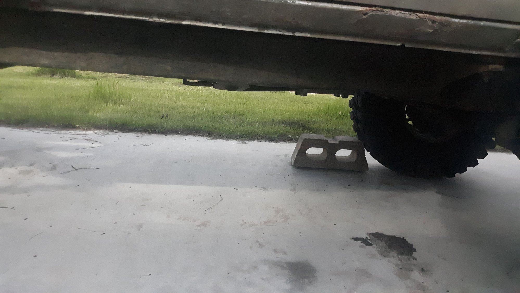

I installed a budbuilt crossmember a few days ag . I have a 3 inch body lift so I went with a flat belly member with a 3 inch drivetrain lift and I also did 2 inch 4crawler motor spacers as well. I now have 22 inches of clearance under the belly of the truck. The difference is insane. I think I had 13 or 16inches of clearance before the new crossmember

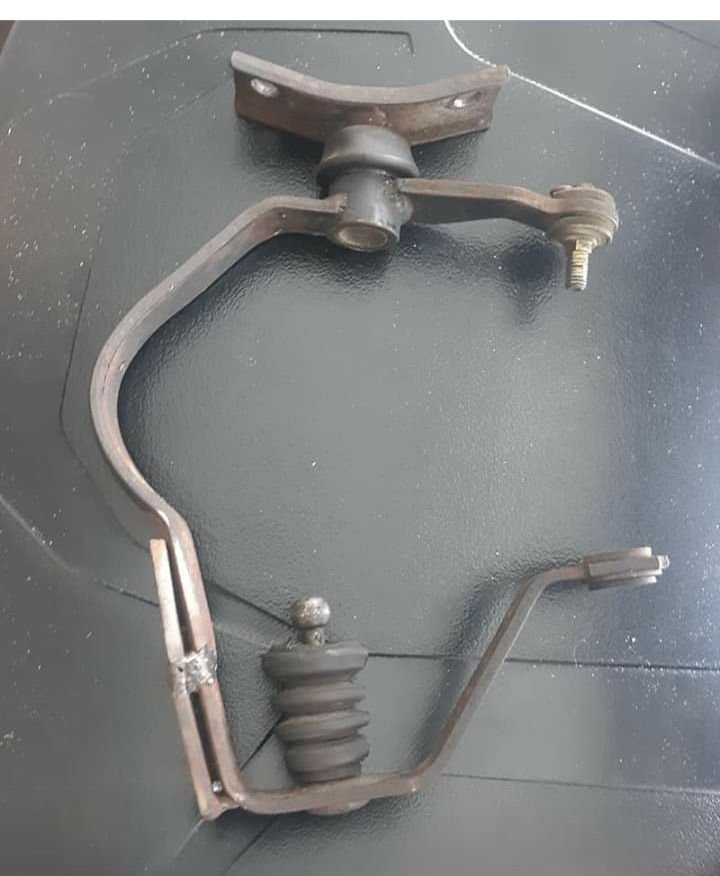

the only issue I'm having now is that my driveshaft bolts hit the transmission 4x4 shifter under load. Kind of annoying lol but other than that the ground clearance is amazing

I hated how low the stock crossmember was. Now I've got a ˟˟˟˟ ton of clearance which was a big problem for me before

hmmmm what engine do you have? Maybe they dont for your particular setup. I know with mine they had to fab some stuff up custom for my skid plate.
Did you get this problem fixed? I had the exact same issue 2 months ago on mine. At first I thought it was a bad mount but after replacng it I stll had the issue. Finally spaced the crossmember down 1/8" with washers and it went away.
I tracked it down to the 4x4 shifter on the body and tail end of the transmission. The original owner cut and extended it when he put the body lift in. I cut and shortened it to fit but apparently didnt cut enough off. So I ended up.ordering a new one. I havent got it yet so I dont know 100% if this will fix it but my next thought was to do spacers like you did.

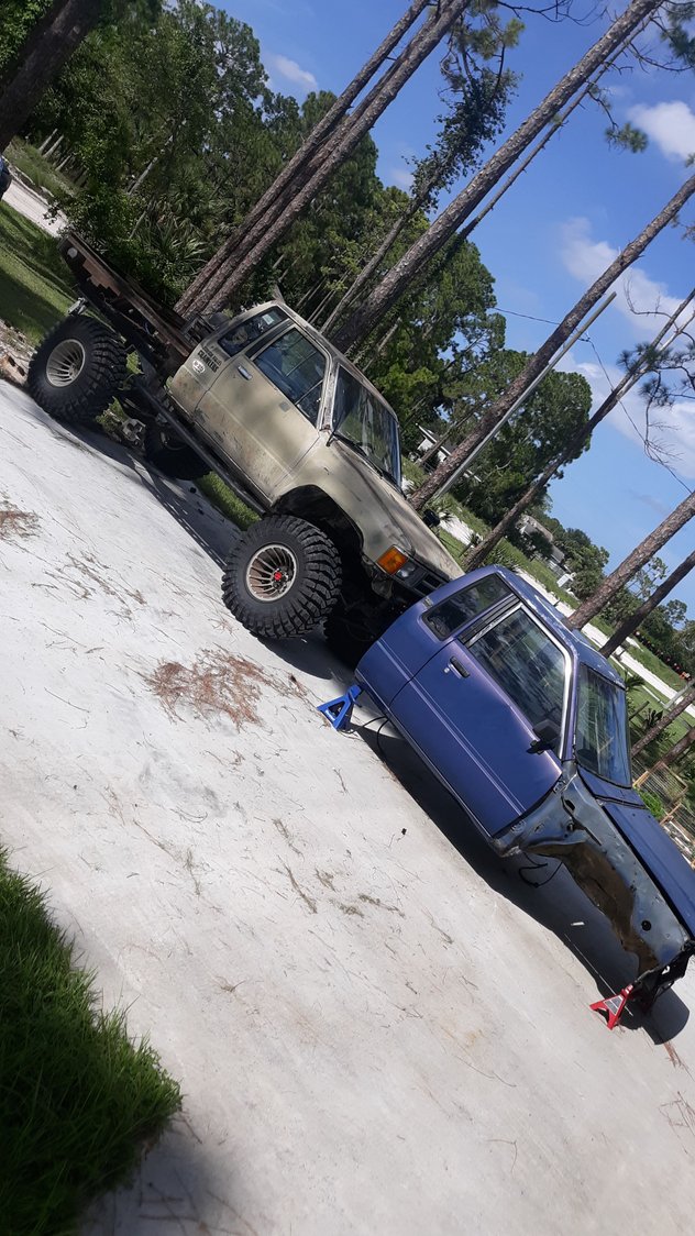

Also for kicks heres my truck and the cab I got planned to swap on it you can see I got some good clearance now

i would love to have your turbine wheels.. its my all time favorite wheel to come out of the 80's
