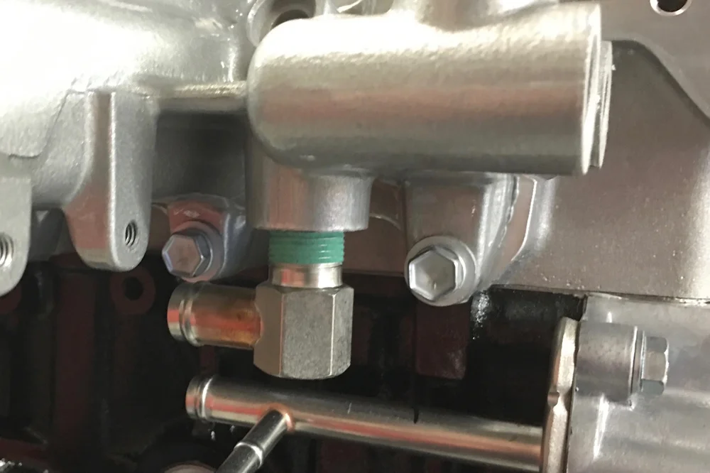

Are you sure that a bad radiator cap did not cause the problem in the first place?
If it still has original hoses for the IAC, I would definitely replace them. One of the hoses(Gates 18222) is like $40 plus if you buy the Toyota part. Fortunately, you can still get Gates hoses that will work just fine. Gates 18222, Gates 18223, Gates 18400, and you will have it covered. I bought all of the above back in 2017 from Amazon, and they are still doing good.

I’m not sure of it, but I have replaced the radiator cap since the incident with a new OEM cap. The hoses you listed look like the heater core hoses, not the IAC hoses. Should be two small hoses for the IAC, correct? EDIT: Double checked, and I am wrong. Not sure what 18400 is for off the top of my head but will poke around and see if I can find where that one goes.

Gates 18400 is the bypass hose. Most auto parts houses around here keep that one in stock. It goes from the bypass union under the intake to the pipe on the backside of timing cover passenger side. Might as well replace it while you are doing the two IAC hoses. It's a U-shaped hose, and it should be the cheapest of the bunch. Picture is from 22reperformance.com.
