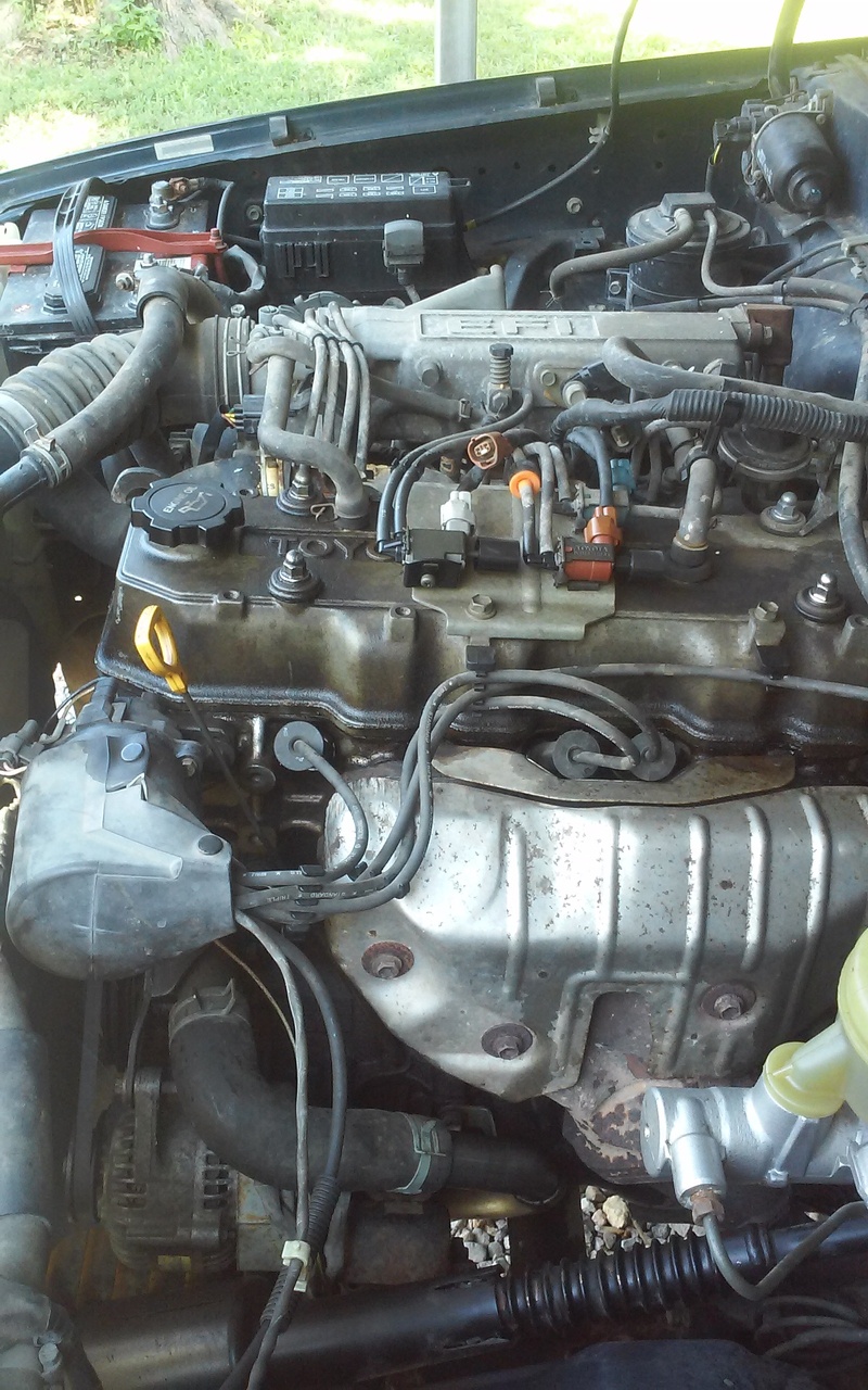

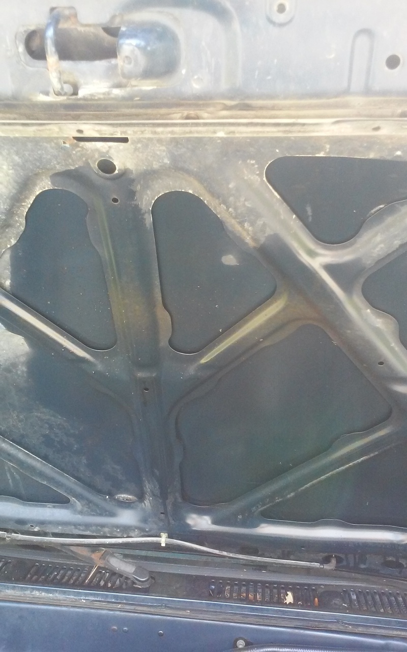

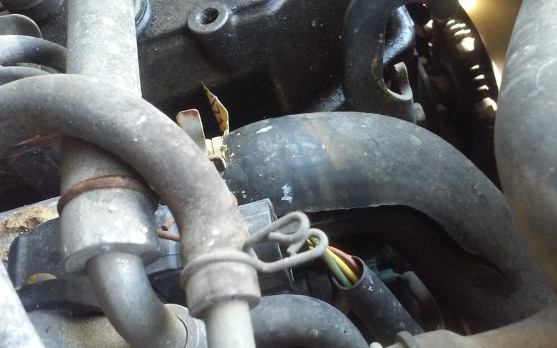

Split the upper radiator hose a good 6", water everywhere. Water levels were good before hand. Seemed sluggish driving into town but not just aweful. Went to crank it leaving the place i was and with clutch in and i think shifter just pushed up into 3rd from being parked, i turned it over, it turned just enough to know it turned like a low battery. So i tried again, same thing, so i pulled it out of gear hit the clutch cancel and it started right up.
So now taking off it was pretty sluggish. I drove a few miles and just trying to get me and my 5yr old boy home. After the few miles it was real sluggish and i was looking for a good place to park so i could check it out but all of a sudden, Boom the upper radiator hose went. So now in a mad rush for a place to park the smoke starts rolling out the back. But after that hose blew it was running great?!! Finally parked i open the hood to see water everywhere and on driver side of engine on the bottom of the hood and everything else was engine oil? So im looking for a place oil came from and i cant seem to find it.

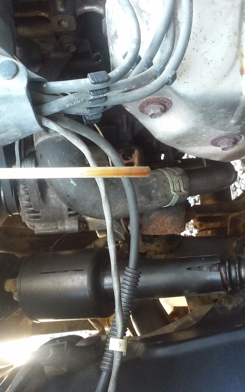

oil on the outside of the engine could be a real problem.
what does the dipstick look like? bottom of the radiator cap?

92 pickup 22re 5 speed
White/blue and filled the cab, it smelled like oil
Upper radiator hose
Oil is still kinda clear brown
Size:  295.7 KBName:  20150611_155511_zpsdjmd3cfe.jpg
Size:  439.3 KBName:  20150611_155532_zps2coe5rsq.jpg
Size:  322.2 KBName:  20150611_155608_zps7v6pevfh.jpg
Size:  157.4 KBName:  20150611_155651_zpshxjwlgub.jpg

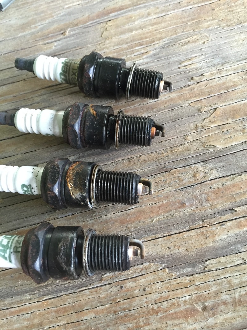

Oil is fine color wise, water is fine color wise, runs good meaning not missing or anything.
Compression test, engine dry and cold
#1 - 155
#2 - 145
#3 - 150
#4 - 140
Also let sit for about 90 seconds and gauge didnt move.
Seems good to me, being im looking for a blown gasket.
After the test i cranked it and let it clear up and initally it smoked but went away quick. Never has done that so it may have been fuel since i didnt pull the relay.
Plugs looked OK, a little on the white side for my taste but i think they were good.

Plugs look good. My have just been some water in the gas causing the issues.

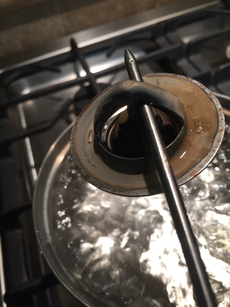

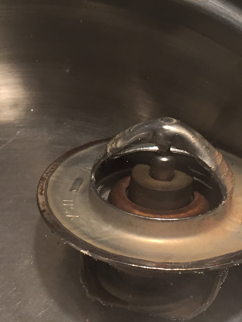

Here is the thermostat at 210*F - 215*F in the water 1st pic, out the water in 2nd pic.
Doesnt seem like its open enough to me.

Put a new genuine Toyota two stage thermostat in it.
Old Jun 20, 2015 | 04:29 PM
88xtra4x4's Avatar
Joined: Nov 2014
Posts: 28
Word of warning about thermostats: They are made extremely cheap and it's possible to purchase multiple thermostats and not have any work. Ask me how I know.

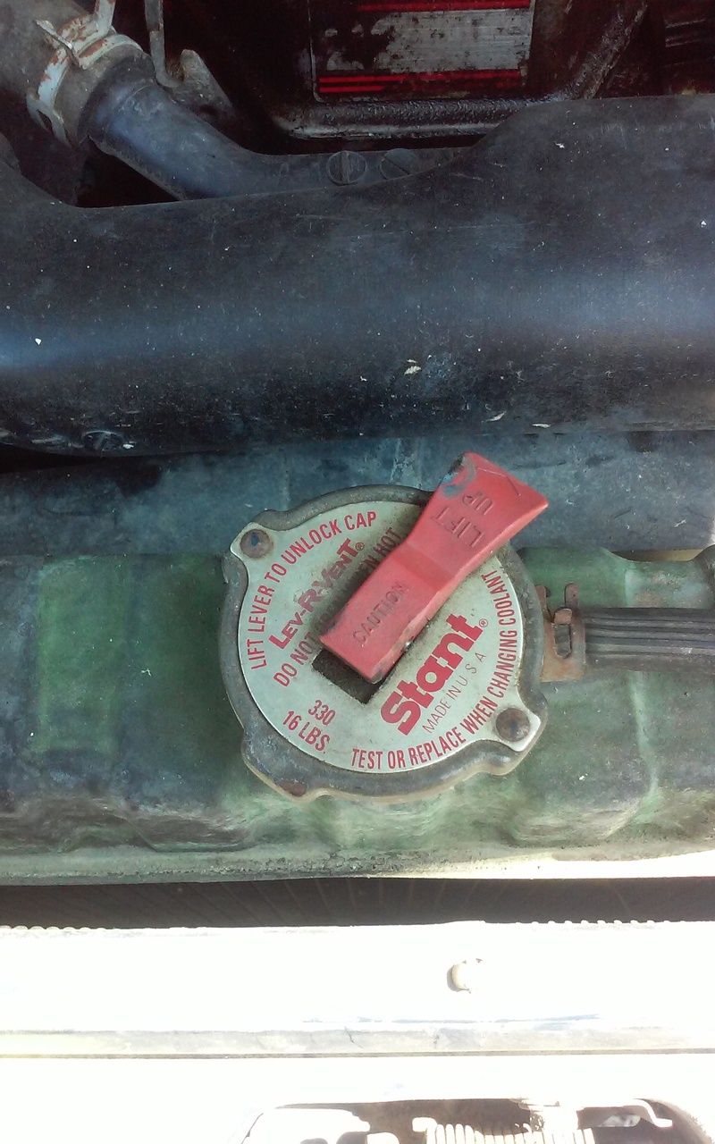

I could be out of line here but I'd say your cooling system is a neglected one.
I don't know the radiator's history but from the pictures I'd seek a good shop and ask if it can be roded out.
Then I'd replace that radiator cap with one that doesn't have a pressure release lever on it. For me that lever style has been a source of premature leaks on several different vehicles.
The rust on that thermostat certainly isn't a good thing for it or the cooling system as a whole. I'd say you're system needs to be flushed good and the coolant replaced with Toyota red and distilled water.
About the only aftermarket thermostat I'd use is the Stant SuperStat. They have three different levels of thermostats- OE Type Thermostat, OE XACTstat , and the SuperStat.
The SuperStat is partially stainless steel and has more of a heavy duty construction than most but they can be bad out of the box too.
It's either that or back to OEM Toyota for me.
The OEM Toyota thermostats are made by Kuzeh. If you can find a cheap supplier for those you might just have the same thing as OEM for less.

Get yourself some new plugs and some engine cleaner too. Let the truck sit overnight. In the morning spray it on and start cleaning. Don't forget to clean the area around the spark plugs. You don't want oil collecting there, it has a way of making it into the threads. Notice how most of your plugs don't show signs of burning oil but yet you have oil on the threads? It can effect both spark plug grounding and heat transfer.
