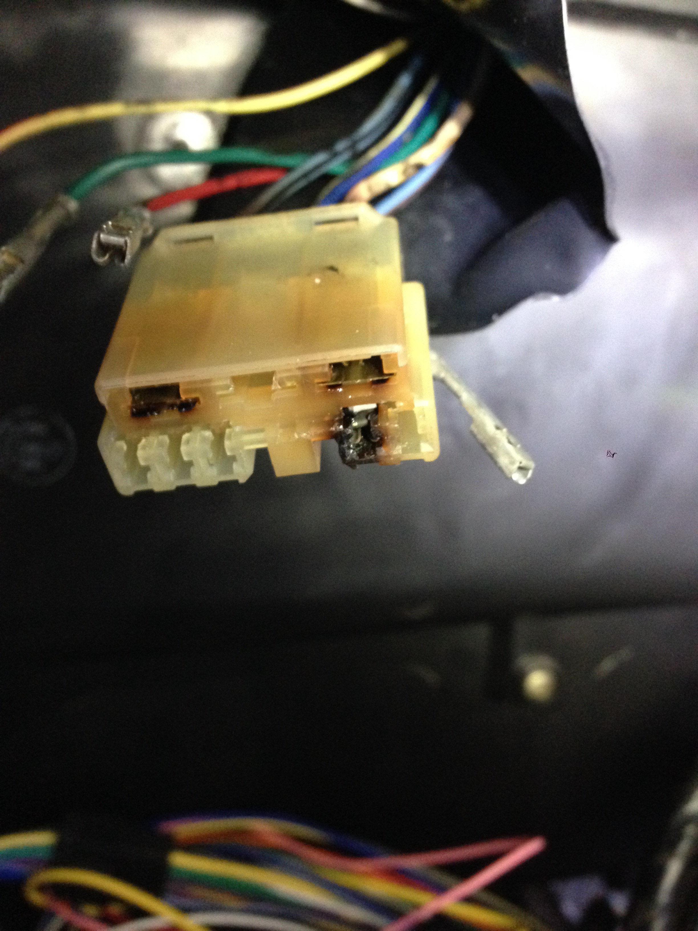

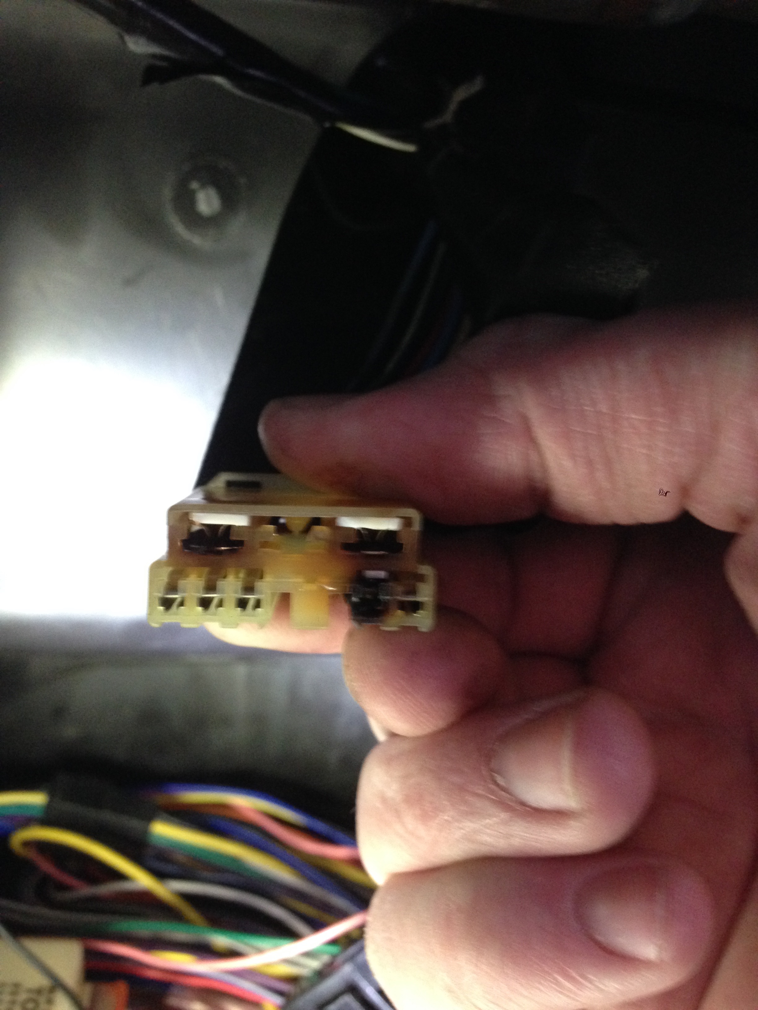

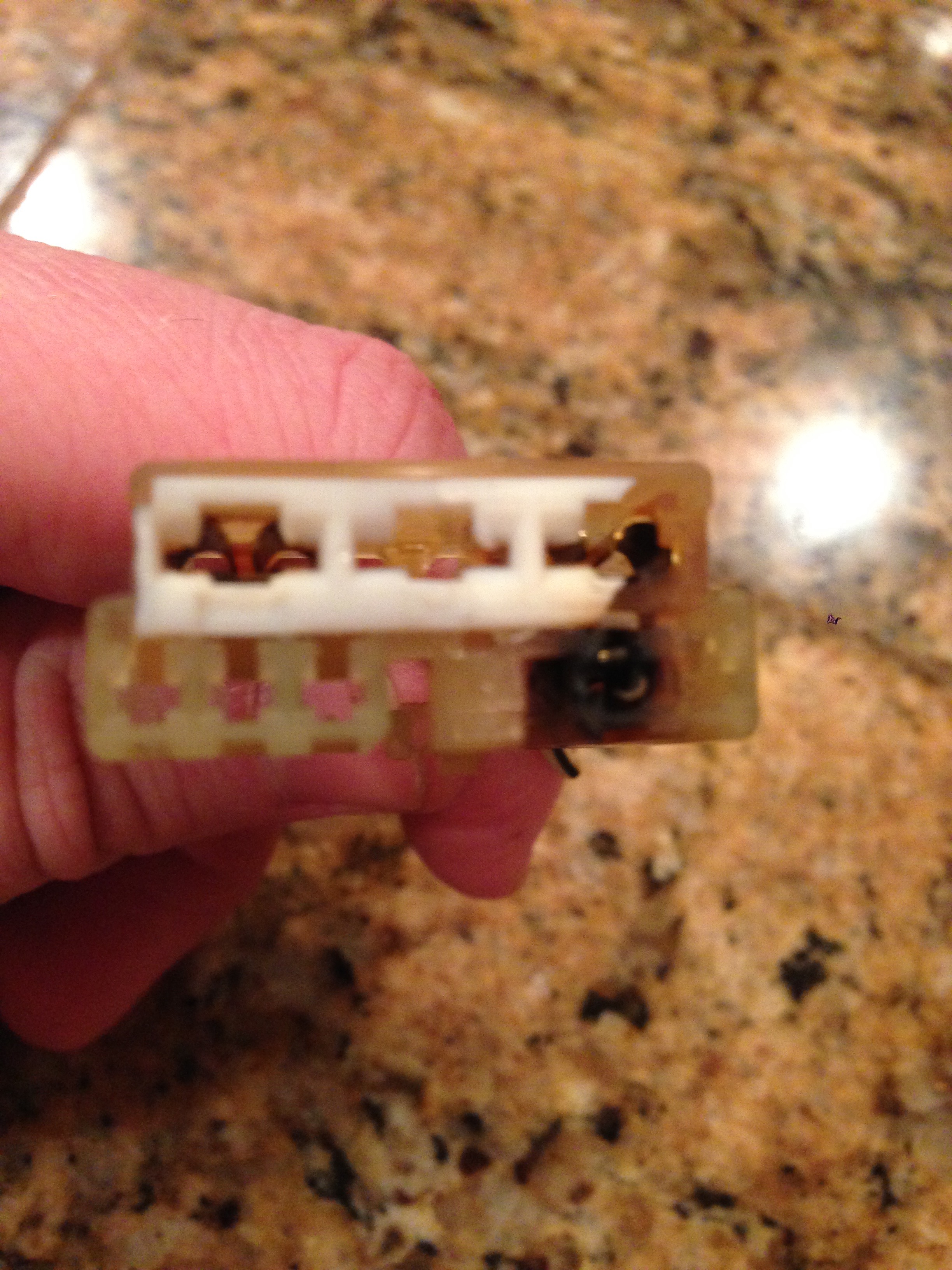

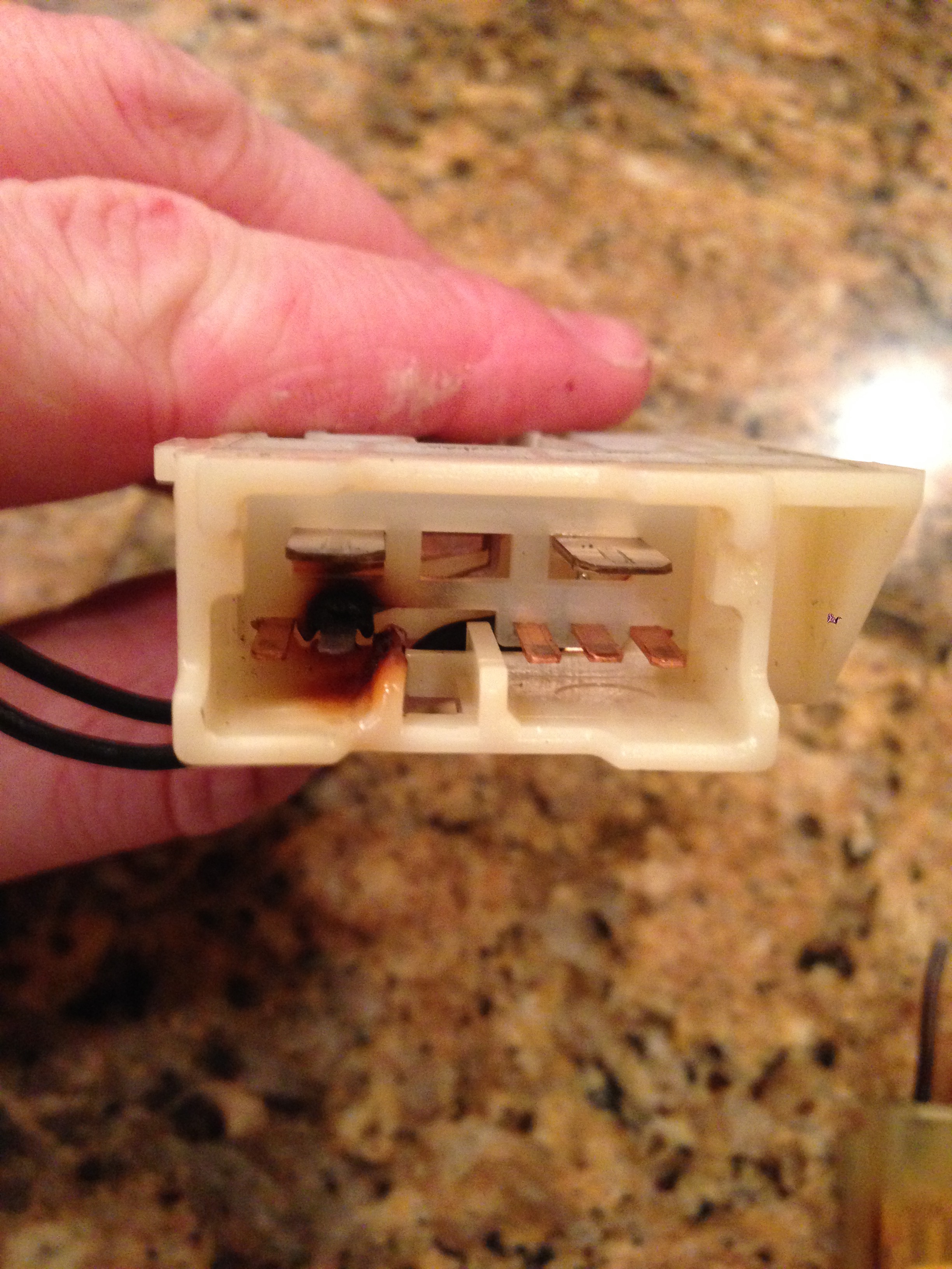

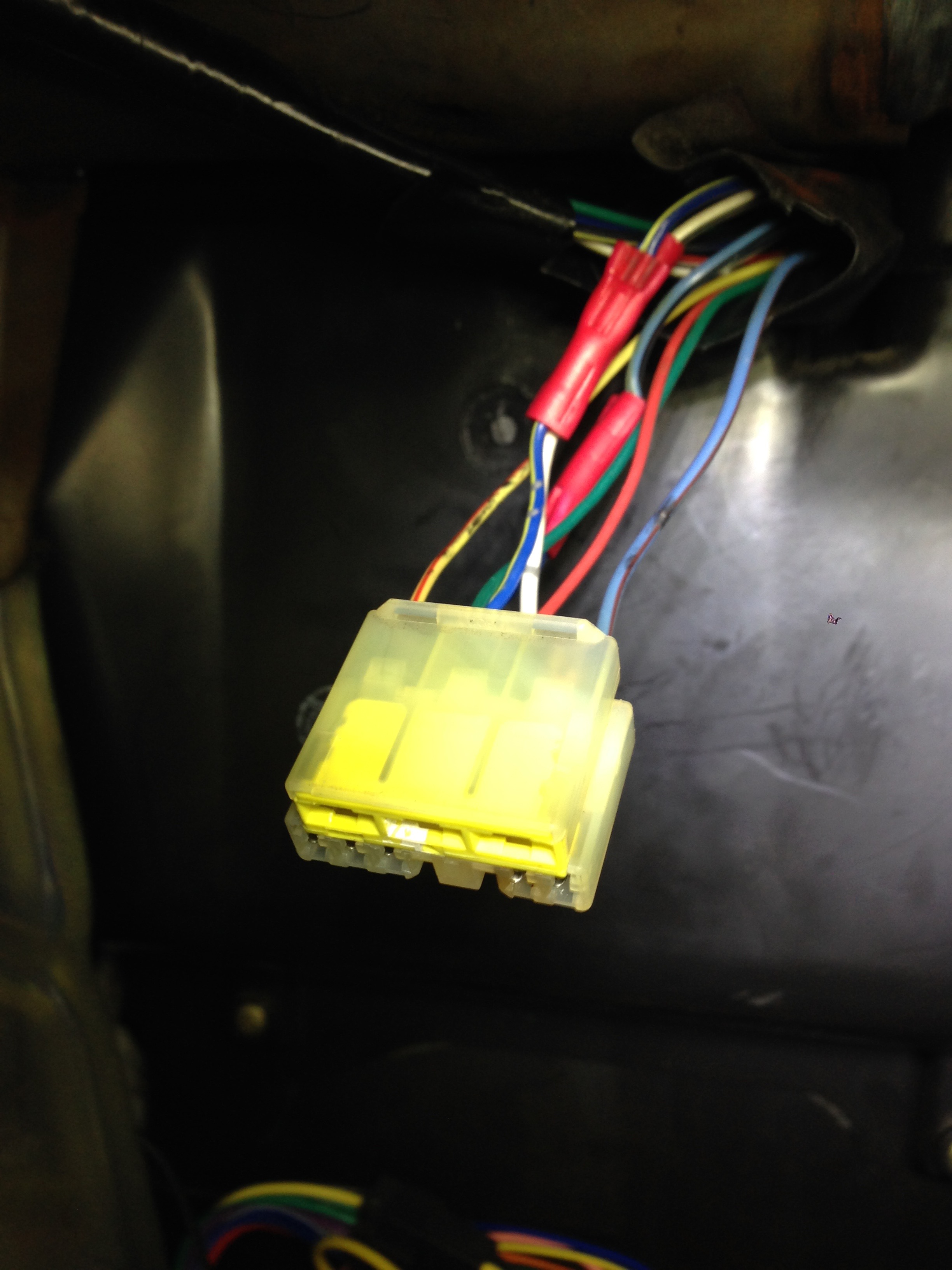

Welcome to Yotatech! I actually just had and fixed this problem on my 94 pickup. I had replaced the blower motor switch a while ago and that solved the problem for a while, but eventually it returned. The real problem was a burned up contact on the switch harness plug. I managed to get a basically brand new plug out of a donor truck so I spliced in some new contacts for the burned up plug and picked up a new switch. The first switch I bought I payed $70 for at the dealership. I got the exact same part (Part # and everything) for $20 on amazon. If you can't find a decent plug of another truck the part # for it is 90980-10463. The new contacts with wire for splicing are for the large contacts 82998-12060 and for the small contacts 82998-12170. I had to do some hunting to find these. Below are some pictures of how mine looked like before and After. The burned up contact is the 3rd speed for the blower motor. I am sure you will find something similar. If you have any questions about how to get to the switch or get the plug off the wire harness, hit me up.
