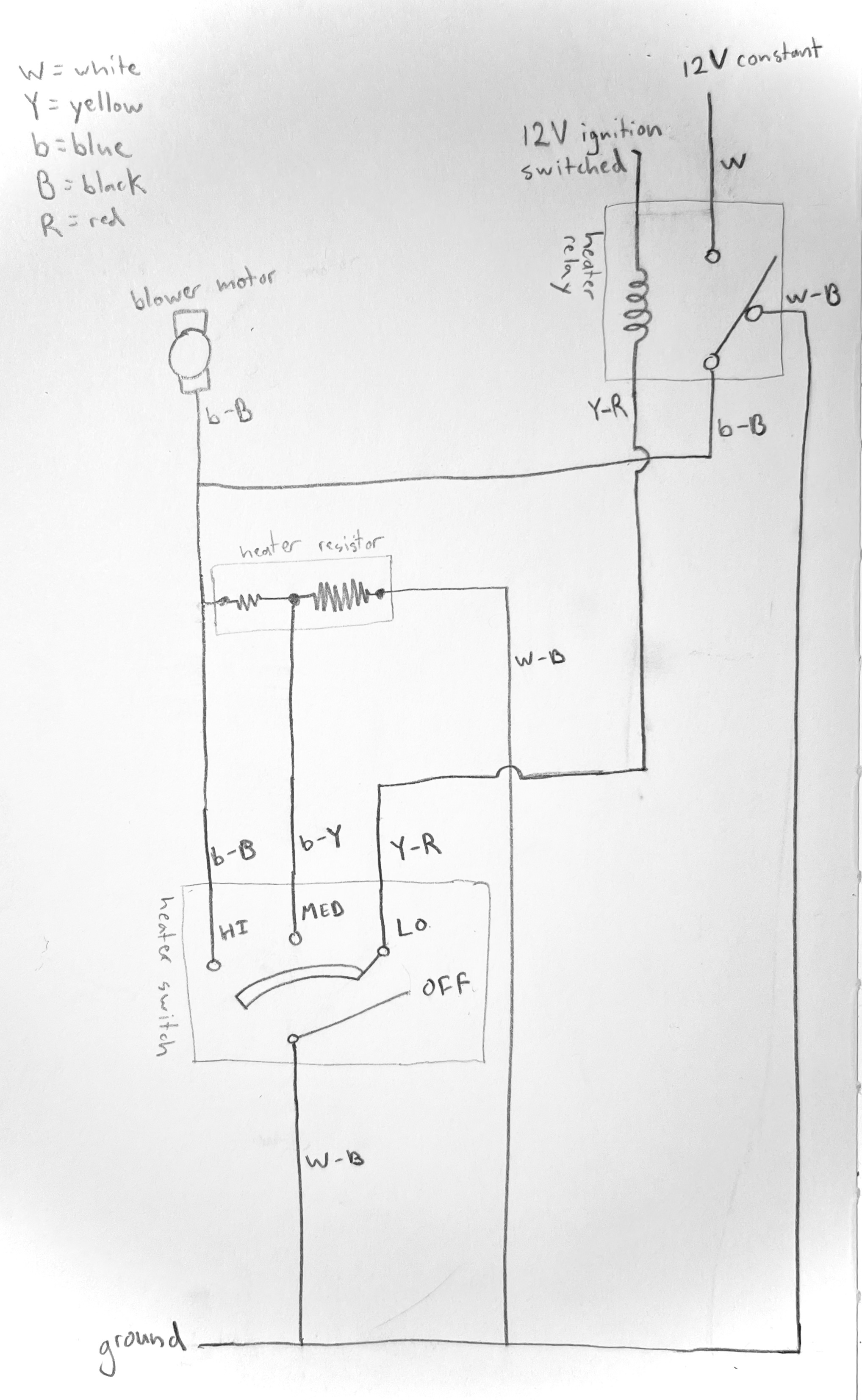

Figured I'd update this thread with my solution if anyone else has the same issue in the future. I've drawn up the wiring diagram for my particular truck as it helped me figure out exactly what was going on.
Turns out the relay coil wasn't being powered. There was originally a yellow wire (turns into a black-yellow tracing it back a bit) going into the relay coil which was ignition-switched, but it was only putting out ~0.2 volts, not enough to activate the relay coil. I swapped that yellow wire for a different ignition-switched 12v source. All is well now.
Could anyone could tell me what that yellow wire that I deleted is? Is that relay supposed to get 12v to power the coil or does that coil require a different voltage?
Glad to have heat again, working outside on the truck in 9ºF wasn't ideal.
