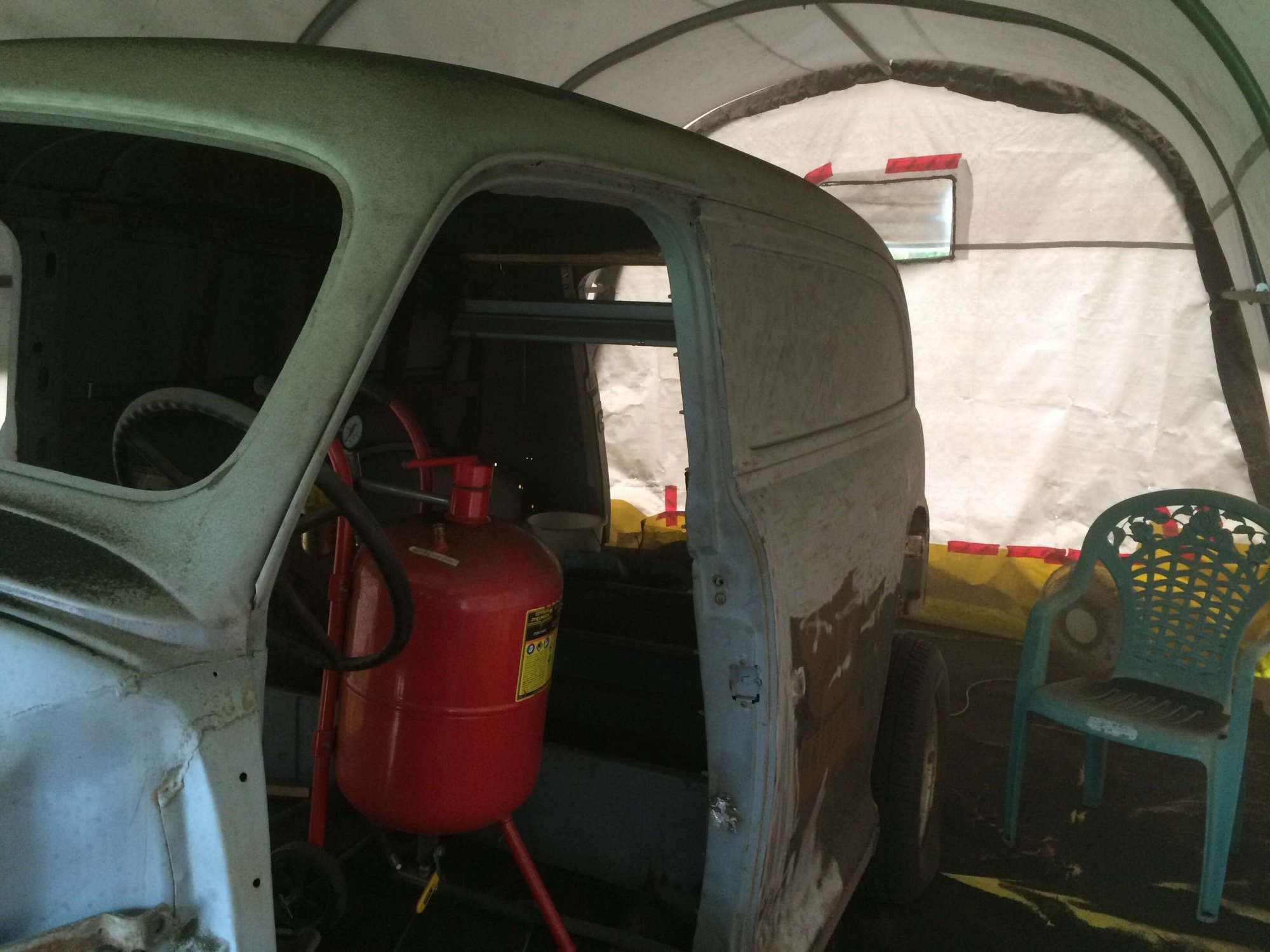

That's how i deal with that type of rust. Don't be concerned about warping metal using media. That happens when the village idiot is blasting with 100's of psi. I blast at 120 psi and never any issues. Epoxy primer over the bed after cleaning with a phospho solution to neutralize the metal. A $4 bottle of phosphorus would be plenty. The bed itself would only require 1/2 a bag of media at most depending on what kind of unit you are using. I have a HF pressure pot and 5hp 18 CFM compressor for blasting in my wigwam. Poly on the floor so I can recover and reuse media
