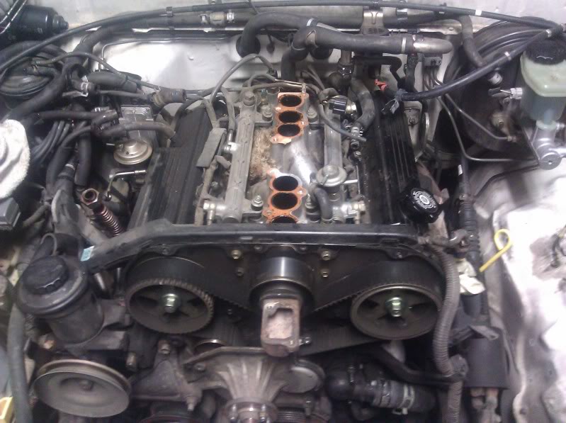

Thinking about doing this. What are the pros and cons of pulling the motor vs taking the heads off while the motor is in the car? I've done several engine swaps before mostly on hondas/acuras but I've done a turbo mr2 and I've swapped the 2jz in my sc300 quite a few times so I should be able to knock it out.
I pulled the top manifold off tonight.

I'm pretty tall so workin on the motor in the bay isn't really a problem. I think I'm going to leave it in. The exhaust seems like the only real problem. And with the right tools it looks doable. I just wanna fix the gaskets and be done with it. I will probably go and swap the 3.4 in the future but for right now the lack of funds won't allow it.
Check out the mouse nest on the manifold in the picture I posted. At least I think that's what it is.

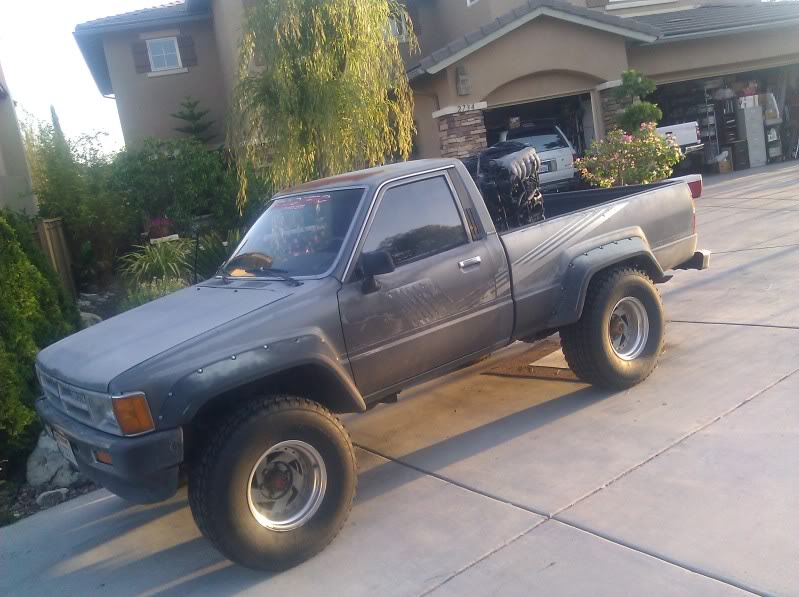

So everytime one of my previous cars breaks down. My good friend has been so kind to let me use his rig. Here she is guys. 170k my friends dad is the original owner. Still keeps tickin
