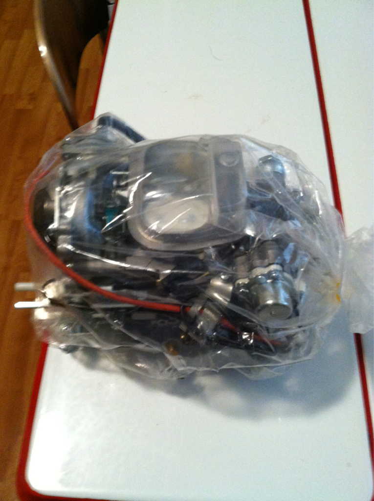

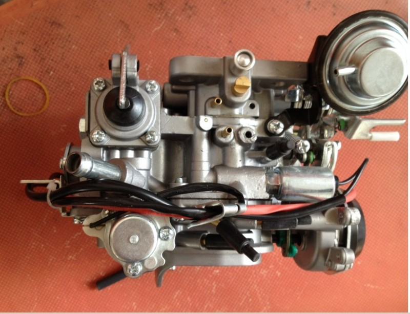

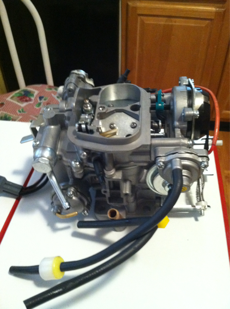

Well my carb finally arrived .I compared it side by see to my old one to look for any differences .at first I thought the linkages on the china carb were On the cheap side.but after looking on the factory carb they both look the same.so i installed it and fired it up.so after reaching normal operating temp I start adjusting it.the mixture adjustment on it only took 4 turns out.my old carb was set at 6 1/2 turns out for it to reach its highest idle and highest vacuum on vac gauge.i will let you guys know how it goes in about a week of driving to see if there's any kinks to work out.

Well its been a week and i have no complaints.Its been in the 20s here in the morning and after 2 pumps of the gas she fires right up.There are no drivablity problems or anything.The only difference in the carb and the oem was the R port for the egr isnt drilled into it and the air flap for the secondary is just spring loaded like a rodchester carb instead of having a linkage to it.It does kick in the secondary alot smoother than the old on did with the linkage.I kinda miss the kick the old one gave when it kicked in it seemed like it was going to do something.lol
