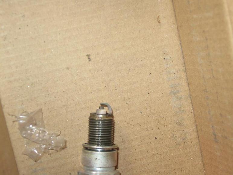

So I pulled plug #1 from front cylinder. This is the only clear image I could take. These plugs were put in back in July of 2009.

That plug looks great.
Btw easiest way to tell if you need a timing chain, pop off the valve cover. Takes less than 10 mins, and you can inspect the chain, guides, and timing cover (look for grooves worn in the aluminum)
If you are wearing into the timing cover, replace the timing cover.

Ok cool, hopefully tomorrow I can drain her and check it out. She really needs a full blown oil change since I've just been topping her off anyway. Thanks for the advice.
As far as the plugs, yeah I thought they looked ok, I'm just wondering about the whole oil guage always reading low, which I'm sure could just be a wiring thing. And where my oil is going to.
