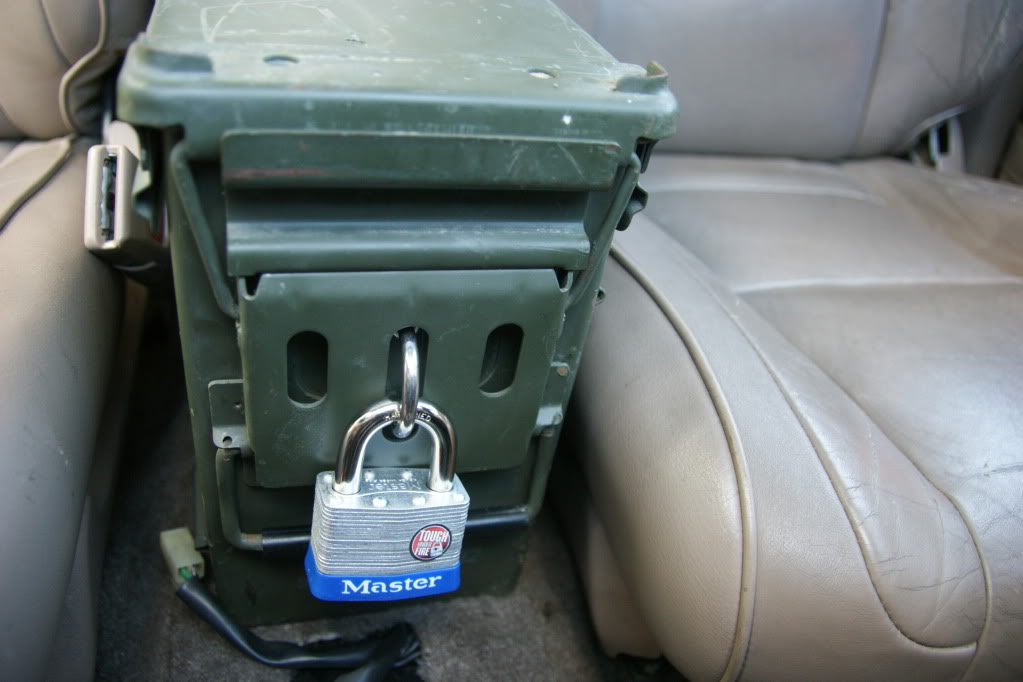

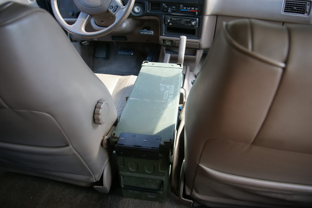

I just finished mine last week! So far I love it

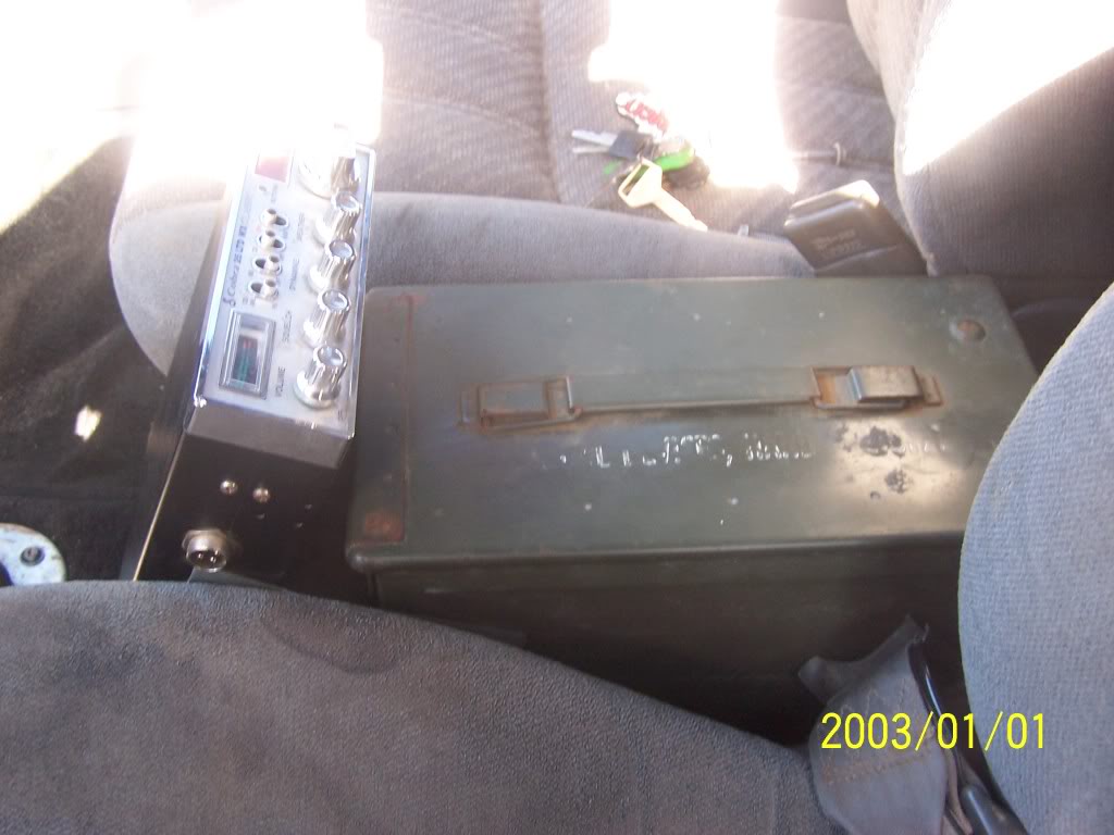

I just installed a 5.56 box in my first gen between the seats where the factory plastic crap goes the 5.56 fit perfect. now I just need to pull it out and paint it tan to match my interior..

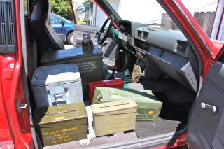

Old Feb 1, 2012 | 08:05 AM
westjohns yota's Avatar
Joined: May 2011
Posts: 1,751
From: pensacola FL
Size:  80.6 KB this is how i did mine, it fit my cb well now i just have to figure out a way to lock it for when i take my doors off and run around.

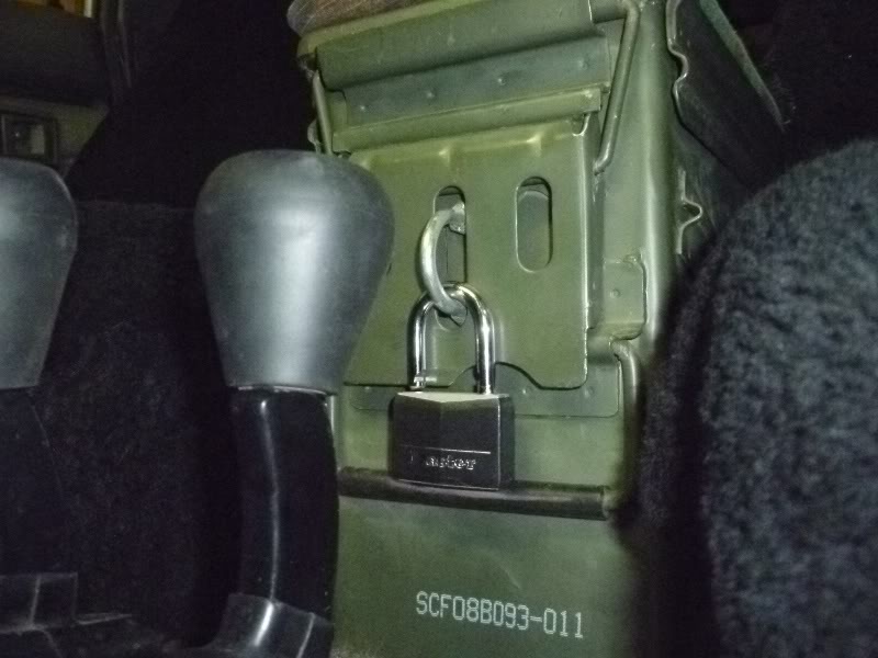

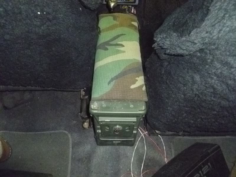

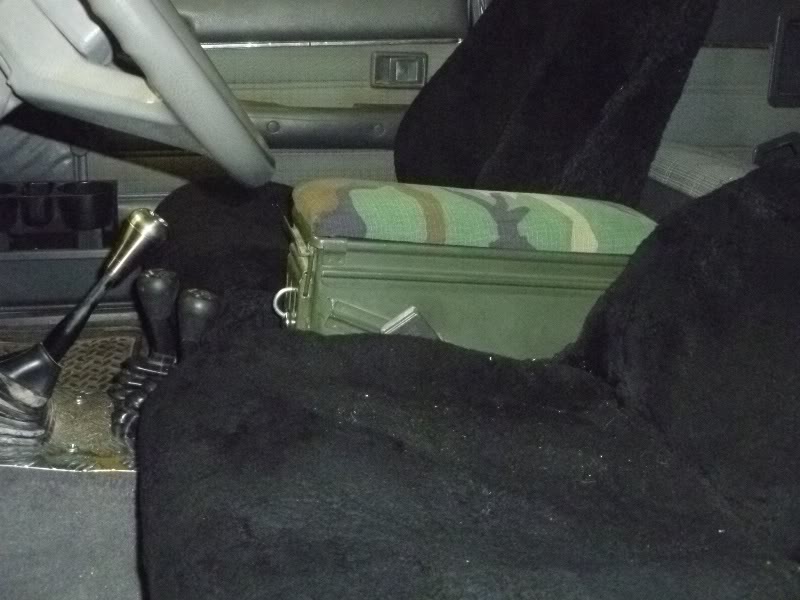

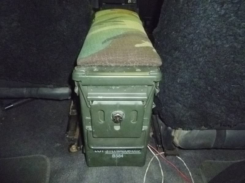

Anyway, I finished my ammo can mod and put a camo pad on top using the lower leg material from a pair of rip-stop BDU's that I cut into shorts. The 40mm versions are sealed when closed.
I used this very easy method to mod the can to make it hinged. No welds or special hardware...just about $5 worth of stuff from the fastener aisle in Home Depot. I am very pleased.
The 1/2" bolt uses red loctite and is only tightened to snug. It cannot be removed and will only spin if you put a wrench on it from the outside. This is how the back side stays attached permanently.

Note the $5 cupholder in the map pocket of the door in the first pic
Fits PERFECTLY!
