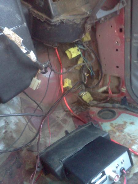

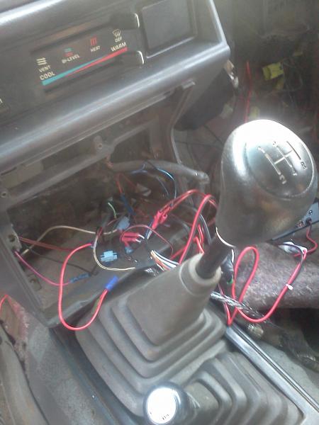

my mess
weathers been poopy so not much progress goin on ......... but this is of the mess the previous owner left me with......

Have you found the FSM for it yet and studied the wiring diagrams?
