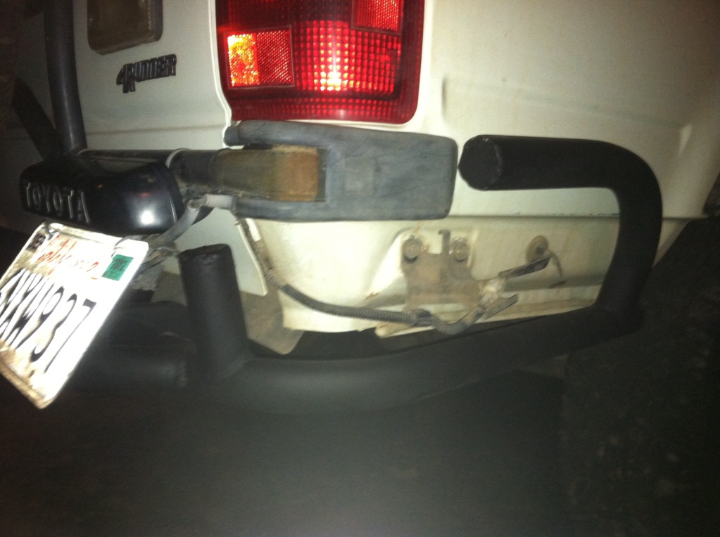

images by JoRunner, on Flickr
This is the older Marlin crawler bumper with a bit of editing off of the truck. Their new design still has the issues of interfering with the swing out. (I just think its an uglier bumper now)

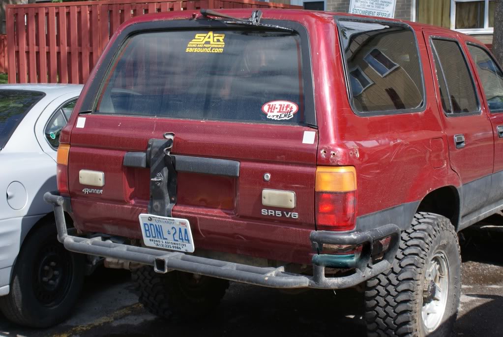

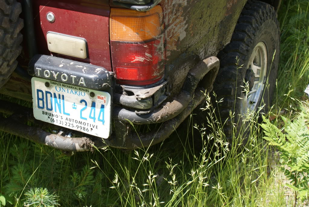

Yea here's mine, same stuff as previously posted.
