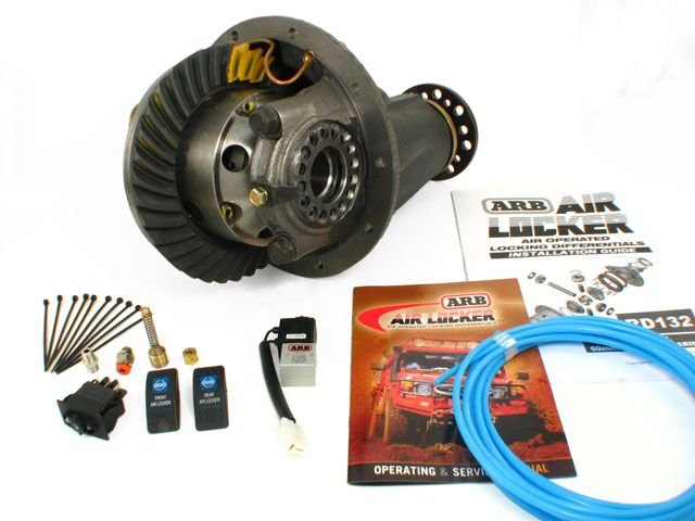

My rear 8" (4.88) diff with a Truetrac in there has bit the dust after over a decade of loyal service.
Carrier assembly needs to be replaced, stealership quoted over $3k which is meaningless I would not want to go OEM anyway.
I'm interested in buying a complete diff. I have been looking into Marlin Crawler who are having their DIFFTOBER special. I have also been looking at East Coast Gear Supply and LCE ($$$!).
To be honest while the Truetrac is great on road in the rain etc, it did not help me when I needed it most deep in the woods.
While the Yukon Zip-Locker is cheaper I watched the youtube video of it snapping under pressure and will be going w/an ARB.
Question is, should I go for a complete 4.88 diff w/ARB from Marlin (no core needed) or East Coast Gear Supply (needs core), or is there another option I'm missing?

As far as compressors go, if you're just running the ARB locker itself, I would think the mini should be adequate. If you want to air up tires as well, get the biggest OBA compressor you can fit under the hood and afford. Assuming you have a 3.0 in there, there isn't much room for additional stuff.

I'm thinking that seeing as we're 5 days left in the DiffTober special I save almost $200 off an ARB equipped 4.88 fully built diff, pretty sweet.
Still pricey even w/the discount but now may be the time! Thanks again MP, I trust marlin too I appreciated your thoughts.

Thanks sky pilot and space-junk for your thoughts. Sky I agree w/you that marlin is great. I called them up and realized that they ALWAYS include a solid spacer (east coast gear supply that's an extra $24 expense).
Also Marlin uses a triple drilled flange by default...for ECGS they charge another $50 for a double drilled flange. Also ECGS needs a $250 core charge, Marlin has so many on hand that they don't even need to charge for core.
ZUK is a legend on this forum and does absolutely spectacular work! He has been a source of wisdom and assistance on this forum for many years, and his posts have helped me and so many others a great deal.
Right now I'm not in a position to send my diff out, I think that (just given present circumstances and the DIFFTOBER expiring in 2 days, I'm ordering the complete 4.88 ARB rear 8" diff this afternoon. Painful...but will go great w/my Marlin manual transmission.Cheers everyone and all my best for a fantastic weekend of wheeling and wrenching (and spending time w/the hot girls of yotatech!) T
