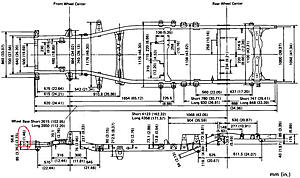

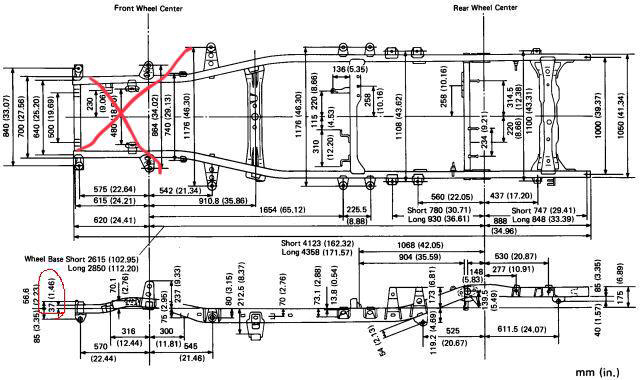

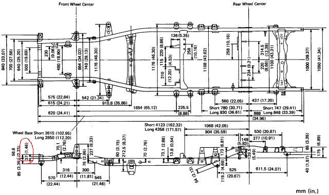

One way to check for squareness is to measure diagonally on the frame. From and to the same points on the opposite side of the rig. They should be the same. It will probably take 2 of you to do it right. This picture is very crude but I hope it gives you the idea. If it is slightly bent you can try and straighten it out on your own, i have done it with a come-along and a tree. But if it is cracked or creased then I would only trust a professional or highly skilled fabricator to make the repairs permanent. After you know its square then as states above its just a big lego set. Most of the parts are easy to find in a junkyard or craigslist. And rattle can paint is a good temporary fix to make colors match ish.
