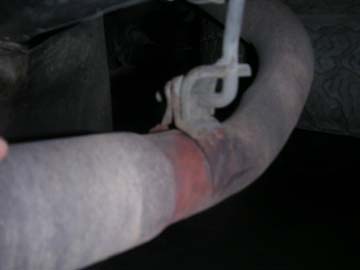

My exhaust bracket on the back of the 4Runner has rusted through and the pipe is free to move around. Can this bracket be replaced for minimal costs? Any suggestions on fixing this would be much appreciated in advance. Trying to attach a pic but I need to reduce the file size. I'll keep trying to get it posted. Thanks

Get it new at the dealership. Reasonable price and NO exhaust rattle. I replaced the entire cat back, including all the hangers on my 89 v6 4runner for less than an exhaust shop would have charged. And its all bolt up factory parts!

no brackets?
so I cannot just get a bracket replaced that holds the end, i guess I should go dig in the trash for my 15% off coupon at the dealer. THanks again

i bet you could jbweld it back together but it wont last long.
like deathcougar suggested, a oem catback would be the way to go. its actully a part from the dealership that isnt overpriced. Also, it would be a good time to throw on an aftermarket catback if you wanted one

Yea you can get that bracket new at the dealership. I was just saying that I replaced my whole exhaust as a comparison.

I appreciate the quick response you guys. The coupon is actually for 25% off for this weekend, so i'm glad I salvaged it from the trash before they came tomorrow. I may just have to go the route of a new catback, and get in there when the kids are sleeping.
