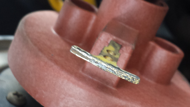

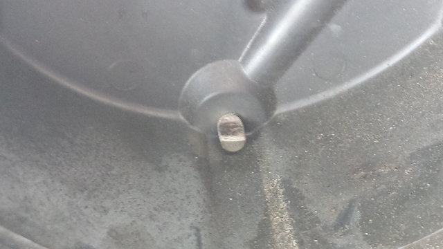

Heres a few pics of my cap and rotor, I have been told there both good and bad so decided to let you guys be the judge
