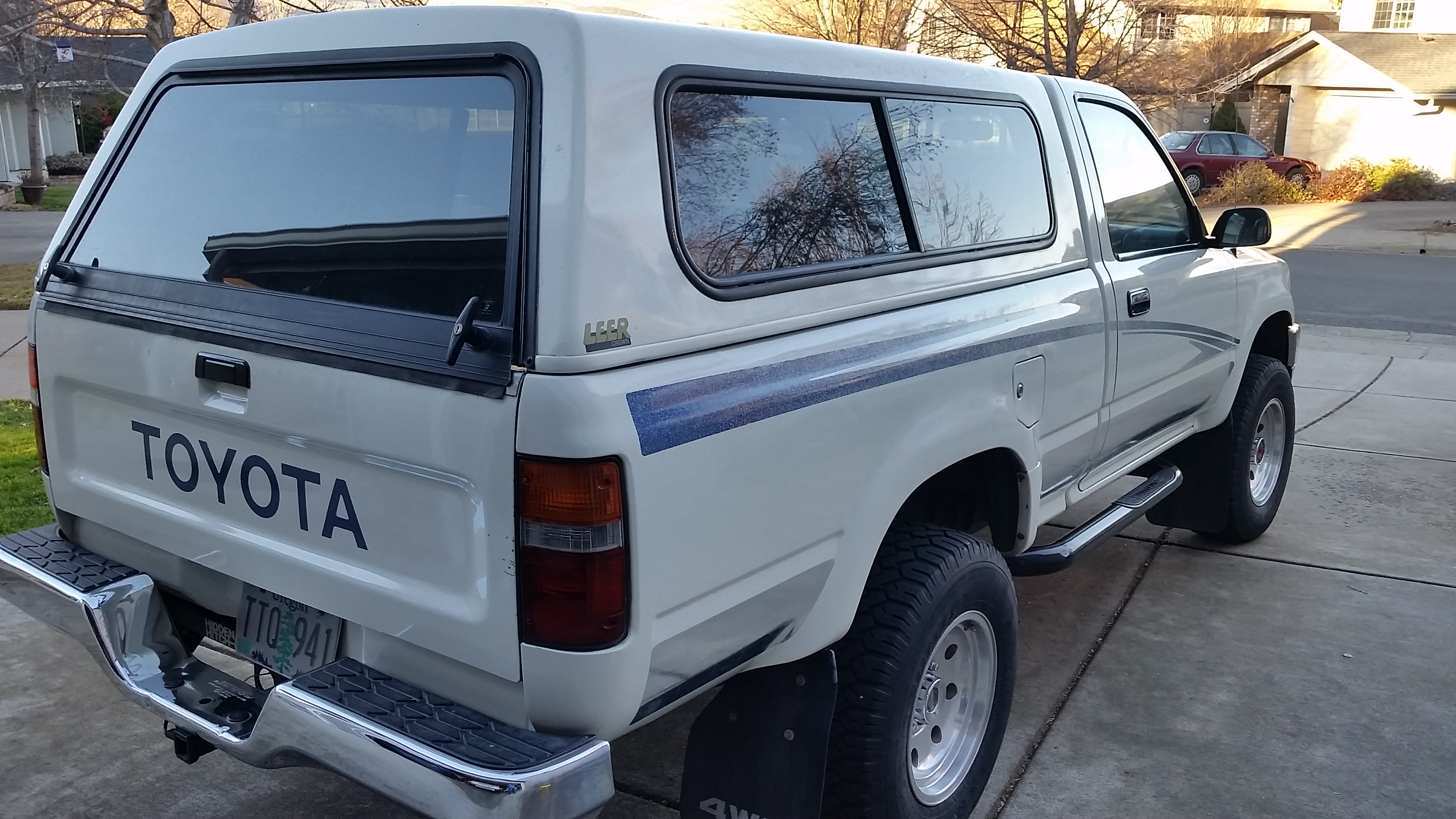

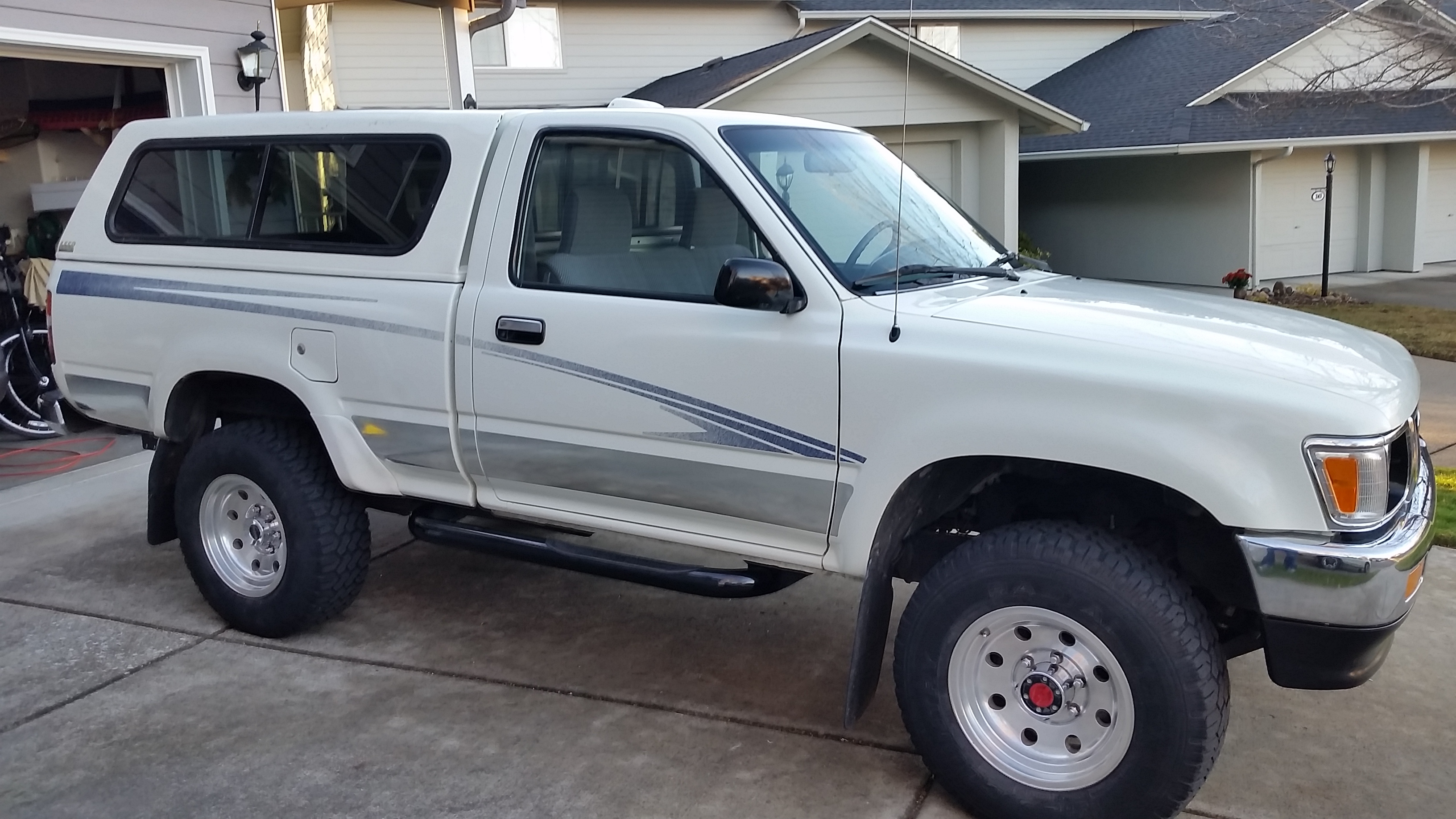

I bought a 94 Toyota pickup 4 WD in October and paid $3,500.00 for it. So $1,500.00 sounds quite good. With the thing I have fixed an now at $6,000.00. I have done had most of the work done except for cleaning it up.
I am glad I bought it and will try and do as much work as possible.
