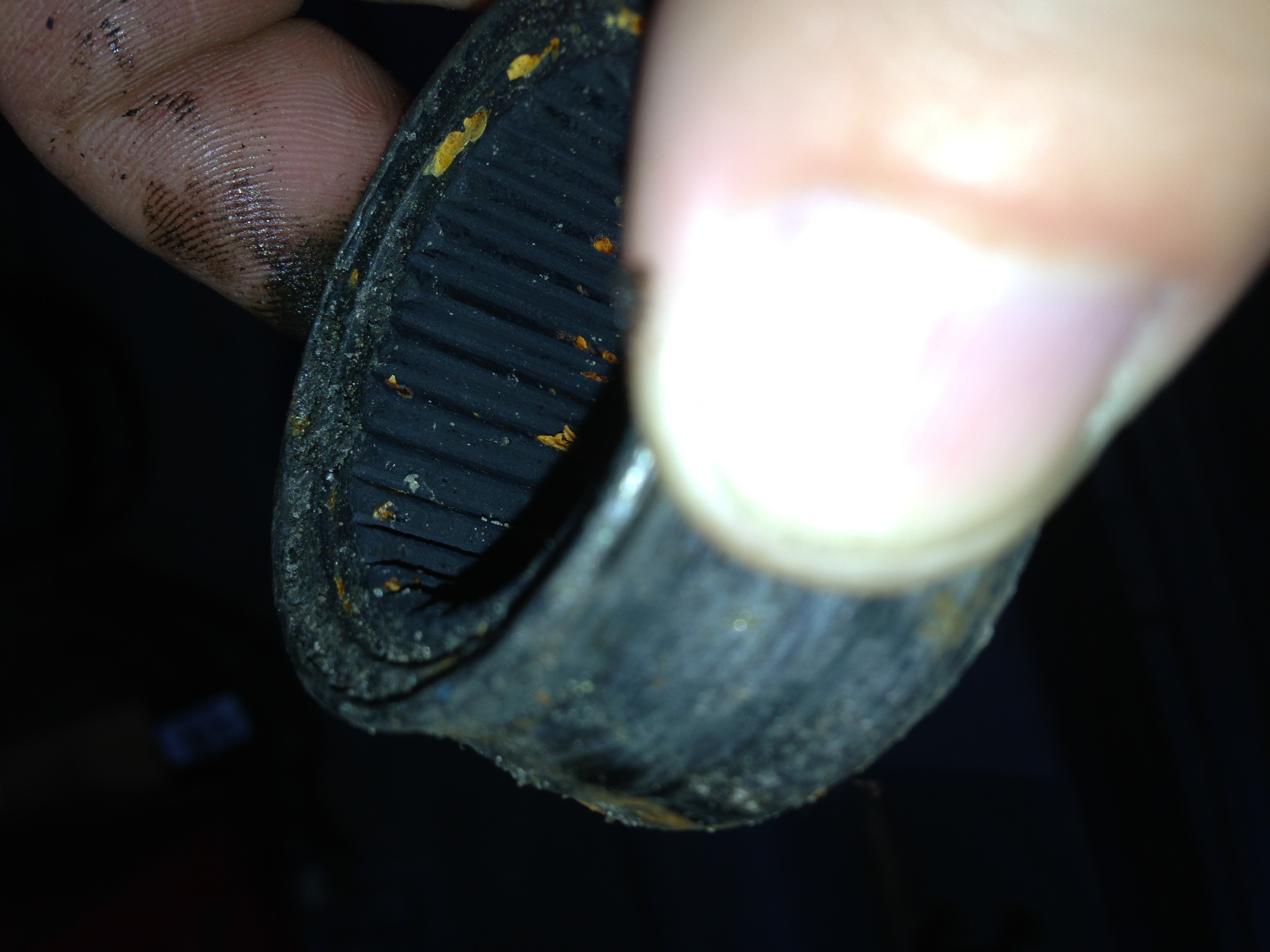

Received 0 Likes on 0 Posts
Inner splined piece, not sure what it's called
Attached Thumbnails 94 4x4 toyota pickup clicking from drivers side wheel when manual hub is locked.-image.jpg
