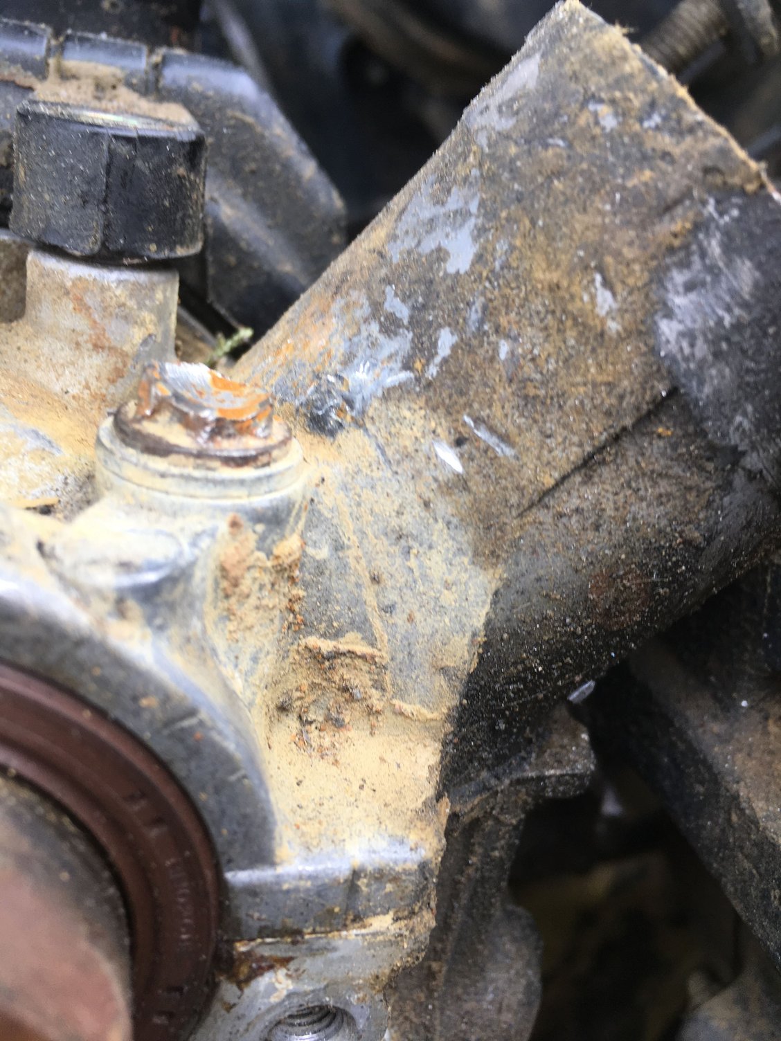

My favorite is the stripped out bolt that made them give up the whole project. Rain is dying down a little so I might get to wrench a little today.

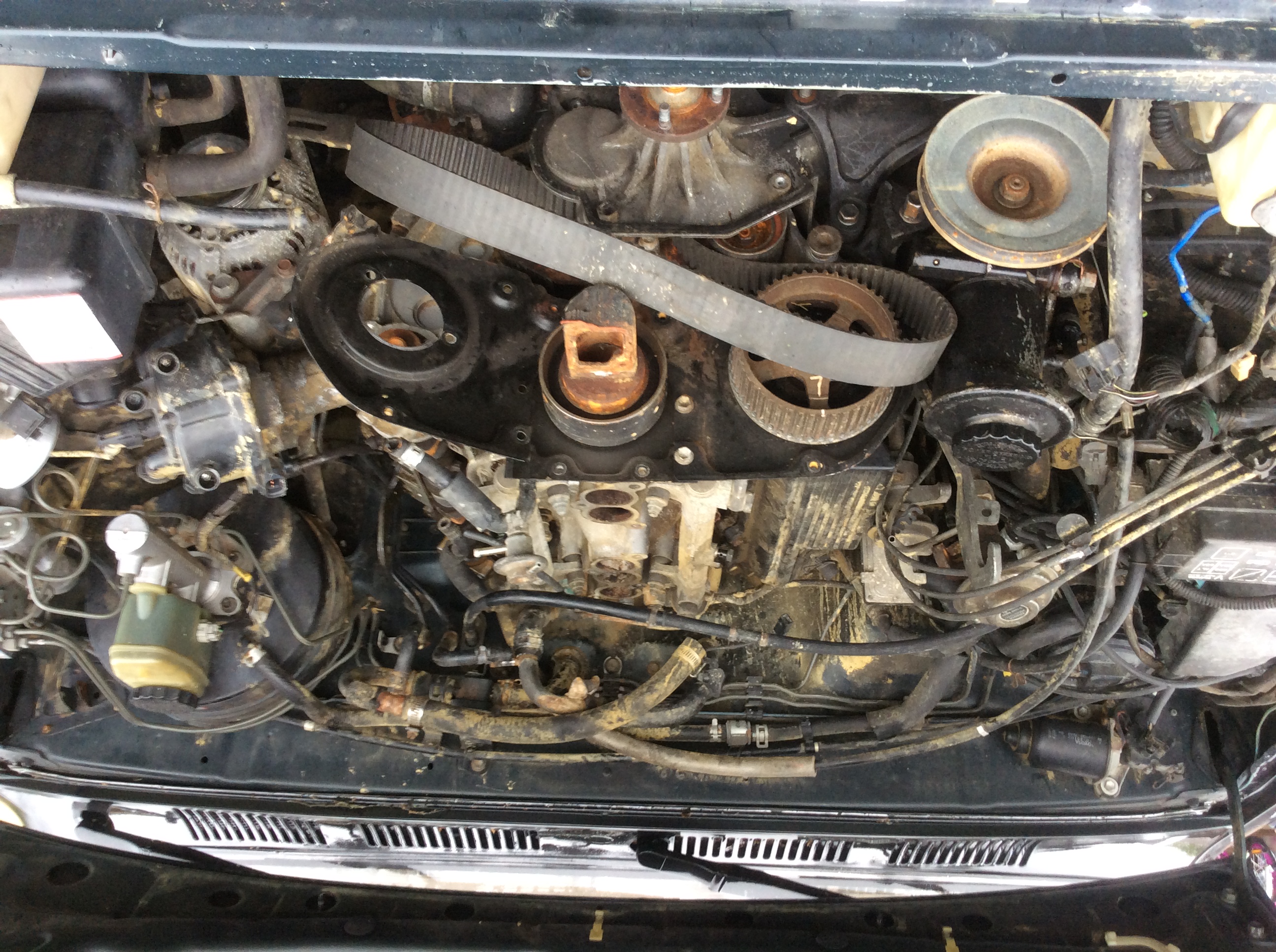

Sorry space junk, I'm better with a wrench than an iPad. I found a dash in a runner that was in a barn in North Dakota years ago and never installed it in anything. I'm waiting to see what my friends wife says she wants to redo all the seats. I'm the kind of guy that spends his resources on parts and not pretty stuff. The frame brackets for the front torsion bar have busted off bolts so it's just hanging there, the transmission bracket bolts are all loose or missing and have been for a while, power steering pump is toast, the auto tranny and (stupid A340H tranny and it's electronic engaged transfer case) linkages are WAY out of adjustment, Hensley Preformance here in Knoxville will do the machine work on the block and crank for $250 ish not bad for a world renowned race motor shop, and there were a couple other things loose or broken that shouldn't be.
I'll post more pics later. Biggest news was I drained to oil and hand rolled the motor and can hear #3 rod raddleing around in the crank and I got all the bolts they just piled together separated in to marked bags.

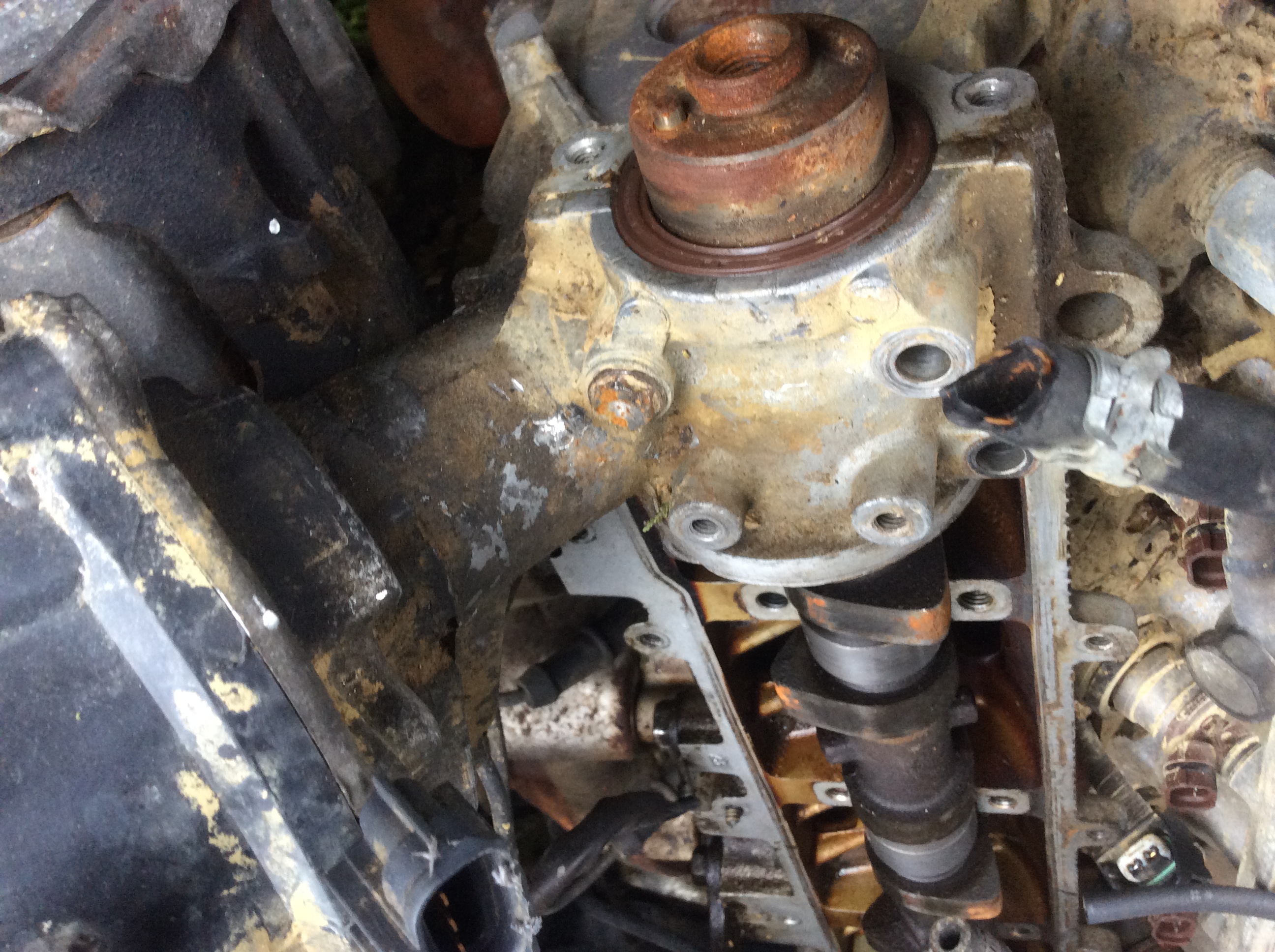

Removing rounded off/stuck bolts that touch aluminum.
Everyone that's ever turned a wrench has ran in to a rounded off bolt that just won't budge. That's a huge reason why I got this runner so cheap. There are several under the hood and more down the frame so I figured I'd write something up.
its pretty straight forward to do. You grind the bolt down to where the lip on the bottom is nice and thin. Then you GENTLY tap it counter clockwise with a punch or chisel. The key things to remember are that your working on a hardened steal bolt torqued in to a price of soft aluminum. Be gentle and patient while grinding, make sure everything leading to the internals of the motor are covered (good practice any time) and take your time. When I'm grinding off a bolt it's because what it's bolted to is expensive or hard to find. And now for the pics
The bottom lip is what holds pressure against the surface below it. Weaken that lip enough and the bolt will un torque itself. The culprit stopping me from removing the crank.
Just a little tapping with a chisel. Be careful not to let the bolt wobble because it will damage the threads. No more bolt and the part is still usable.

Grabbits are great, but I'm never skilled enough to get them to work half the time. If I'm going to get the grinder out I'd rather just get it over with. There are a bunch along the frame that I'm going to have to bust out my fancy tools for because they are broke off flush. Two I'll have to drill out completely and tap. Not a big deal since I think the bolts are too small anyway.
