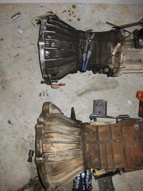

Just wanted to thank everybody for their help and advice on the transmission swap Finished the job last weekend, and documented the swap covering floorboard / interior mods. So for anybody that wants a great running, newer transmission / t-case in their older 2nd gen trucks / 4 runners, this is the thread for you!!!

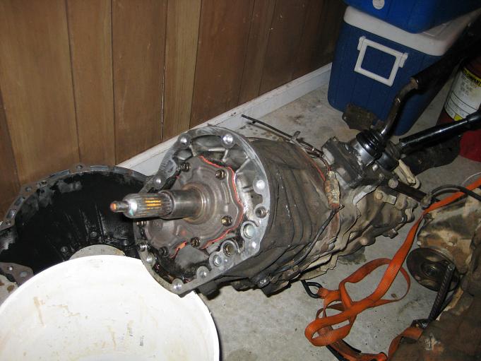

the first group of pics is the comparison of the trannys. the old W56-B is in front, the new W56-E is in the back. Note the angle of the shifters and forward-shift t-case design of the new transmission.

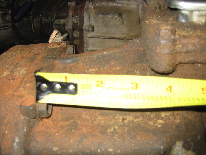

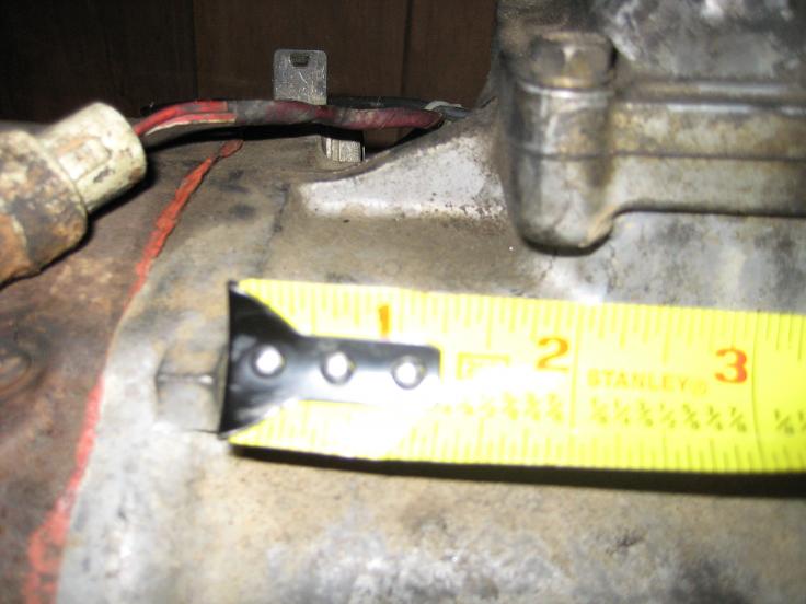

this is a closer look at the difference in shifter location. Measurements were approx. 3 1/2" back from the center plate for the old unit, and 1 3/4" for the new one, for a difference of about 1 3/4". This was a pleasant surprise, as I had been told to expect anywhere from 2 1/2"-3" difference.

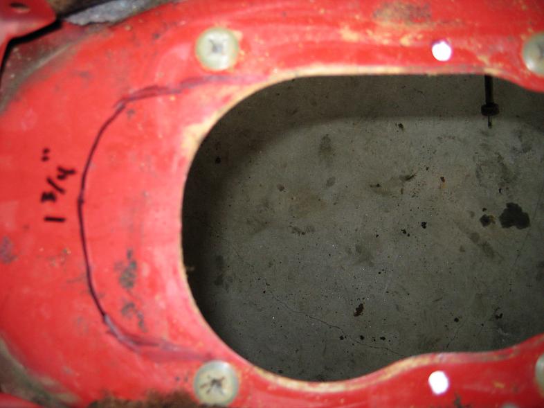

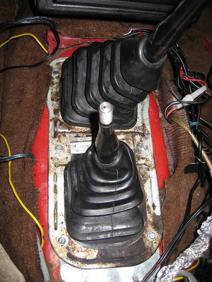

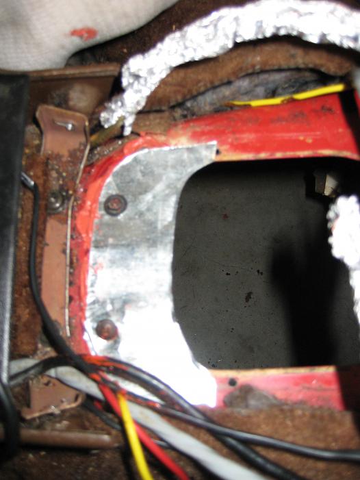

Here, I start on the interior work. To make room for the new shifter locations, I measured out 1 3/4" from the top of the floorboard opening (toward the dashboard) and mark out a pattern to be cut.
Six new holes that hold the rubber shift boot frame are also measured up accordingly. Pilot holes are tapped.
After the aluminum frame is temporarily mounted, I made a stencil out of paper and then got a $6 sheet of ducting tin metal from Lowe's to create a cover for the new hole at the back end of the shifter opening. New pilot holes are drilled to mount the tin metal, and RTV gasket maker is used to seal around the tin metal.

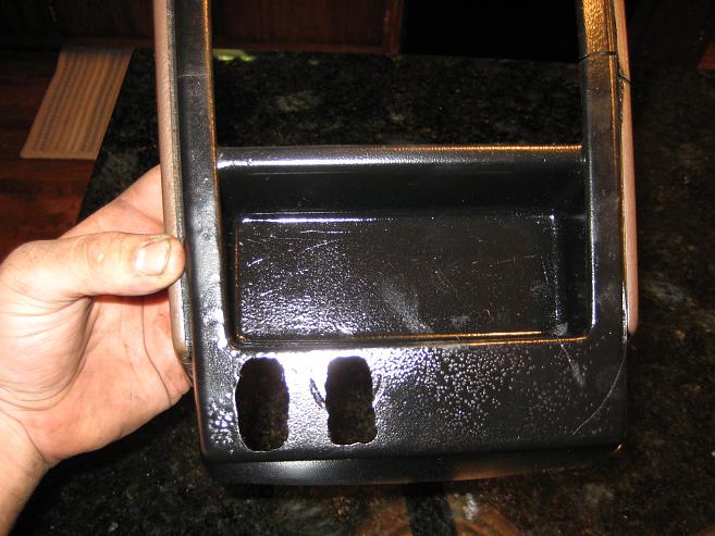

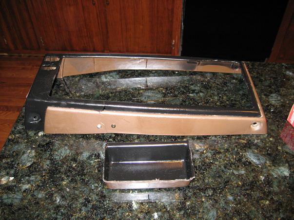

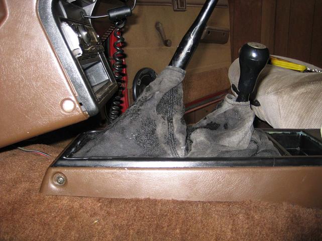

Here is the shifter cover / center console mod. To make up for the forward spacing of the shifters, I was going to move the change tray to the back of the unit. I used a rotary tool to intricately remove the change tray from the front of the leather shifter cover.
At this time, I decided it was time to clean up the cover, as time had taken its tole on the black trim. I taped off the brown plastic and laid down a few coats of gloss black rust-oleum paint to clean it up.
Some of the plastic supports had to be trimmed back to fit the change tray at the rear to make it fit flush. 2-stage epoxy was used; a layer was laid down on the top edge of the tray. The unit was placed upside down, and a hammer was used on the underside of the change tray to provide weight to allow for flush mounting as it cured.
A section of small diameter black fuel tubing was used, it being cut longitudinally along about 20" or so, and secured along the cut-out section to clean up the edges. Super-glue was used to hold it in place.
I think it turned out pretty good

Time to prep the new transmission. While removing the old tranny, I used the bell housing off of the new unit to keep place of the various sizes of bolts. I noticed that one or two of the bottom bolts that threaded thru the bell housing, did not thread into the new unit's bell, which I found odd.
Before the swap I had anticipated the possibility of having to replace one or more seals, so I pre-ordered the various seals that go in the tranny and t-case. This was a good thing, as my dad noticed what looked like a good bit of recent gear dope dripping out of the front seal.
While I finished with some of the interior, dad removed the front cover and replaced the seal. The original bell housing was removed off the old unit to be used in the swap, just to make sure everything goes in the way it should. This is about the time i saw our new friend, the 4' copperhead, out of the corner of my eye slithering out from under the driveway
