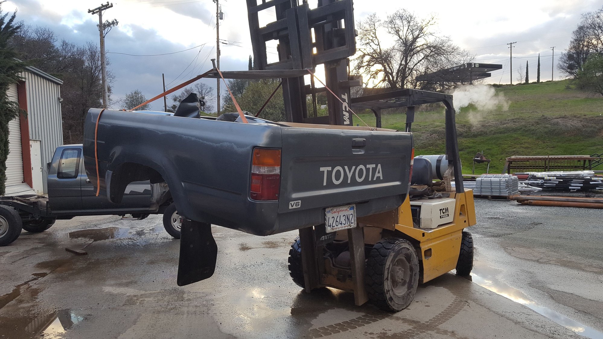

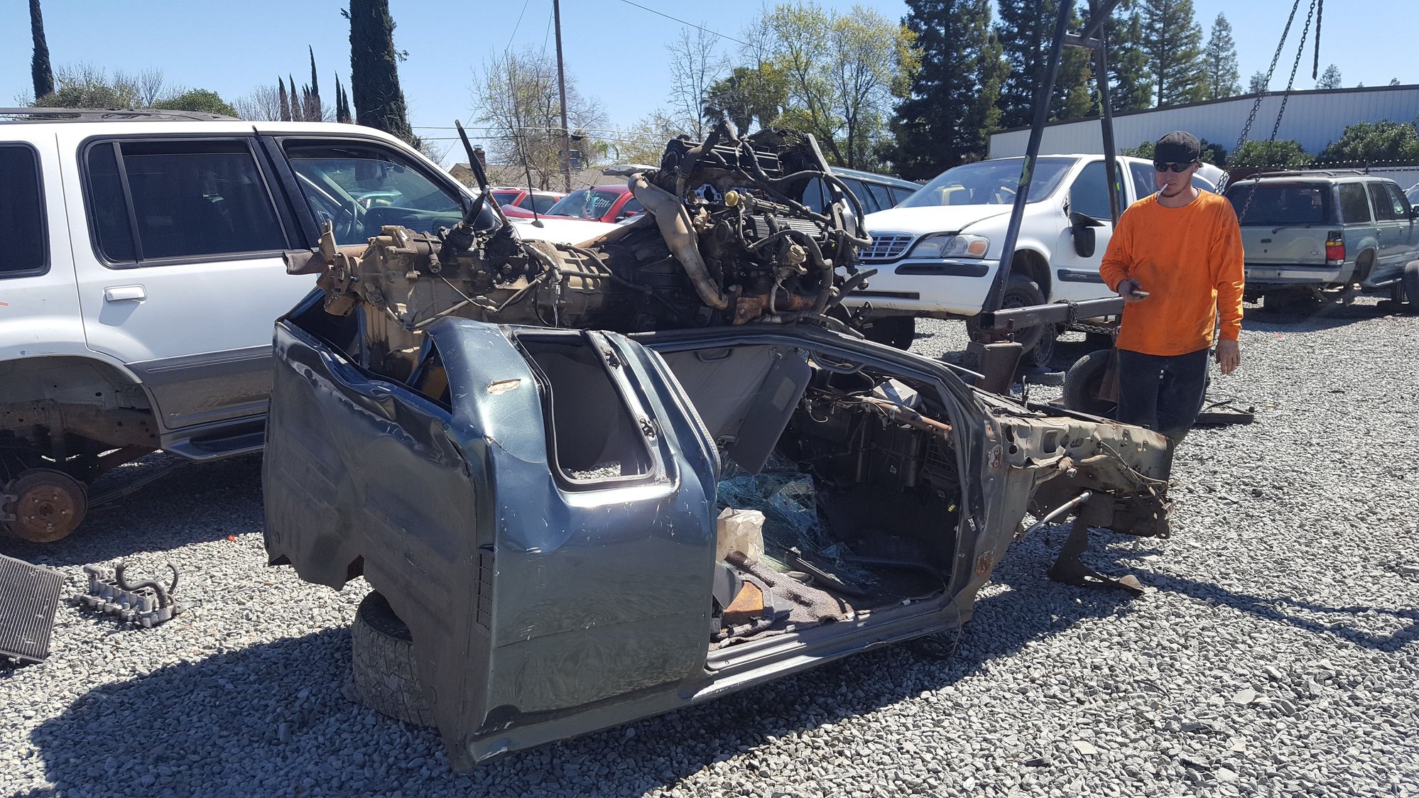

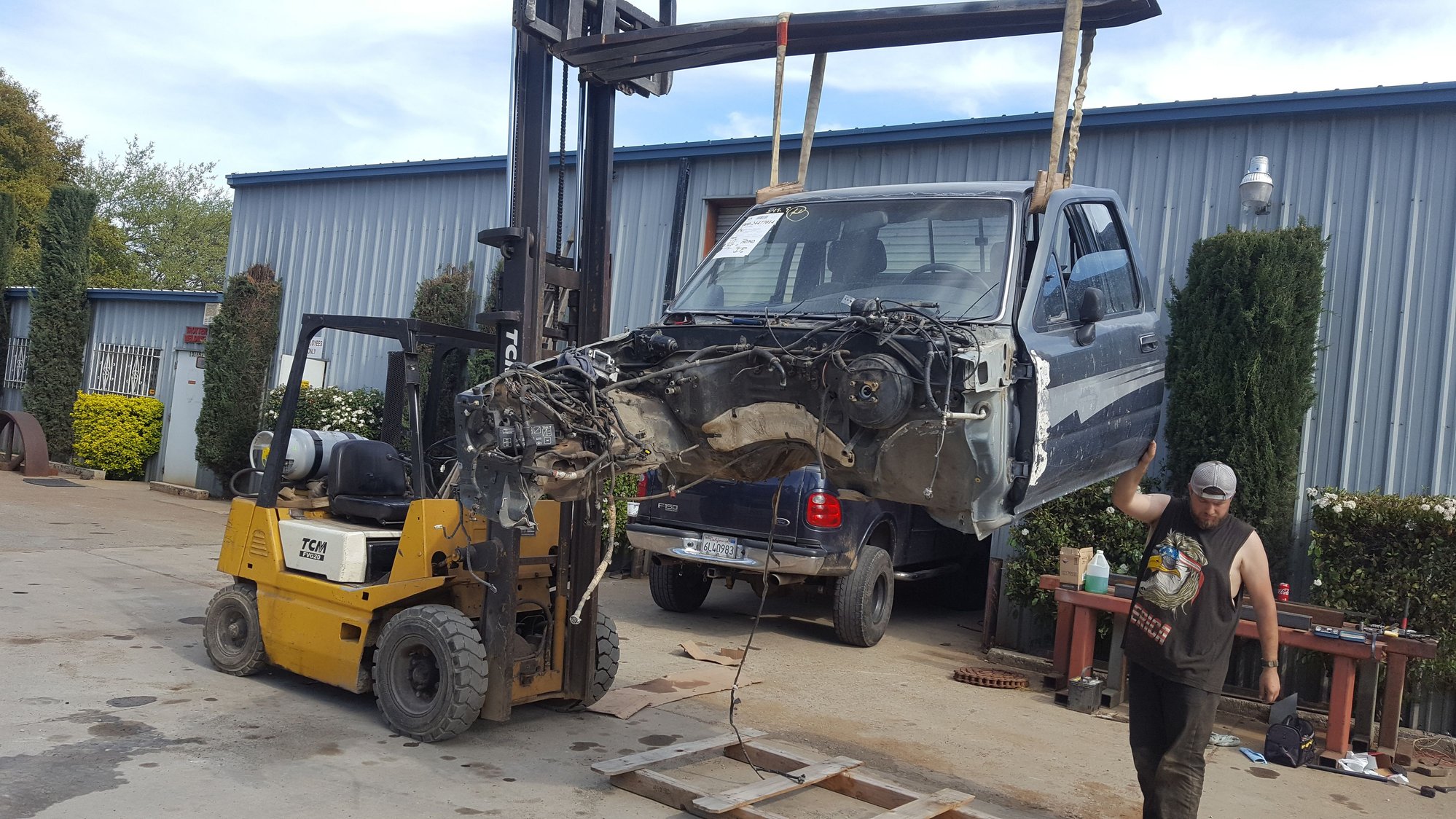

Drove 2 hours to a pick n pull to strip a truck and take the frame. Pick n pull smashed the cab and bed because of some "air bag danger" and ruined what looked like a descent truck in the picture before it was smashed. The truck didnt even have an air bag.

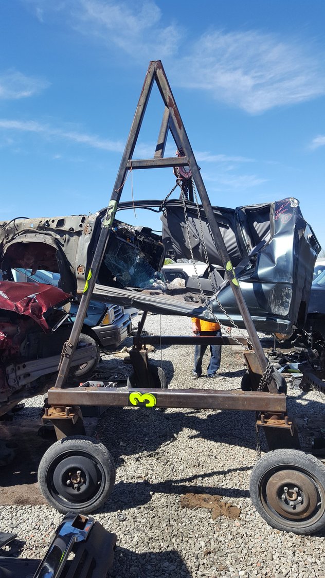

Pick n pull were of absolutely NO HELP. They wouldnt pick the frame out of the tight spot with one of the big fork lifts that were driving around. So it was a pain in the ass to get it out of there. They wouldnt even let us pull our truck and trailer back there to load it up. They even tried to charge me for the mangled wiring and brake lines still stuck to the frame, so we had to pull that garbage off even though it would have gone in the trash. So we decided to leave the cab with the engine and trans on the roof, in the middle of the yard for them to clean up. It looks just like it was dropped on the roof. LOL. This is why i hate wrecking yards.

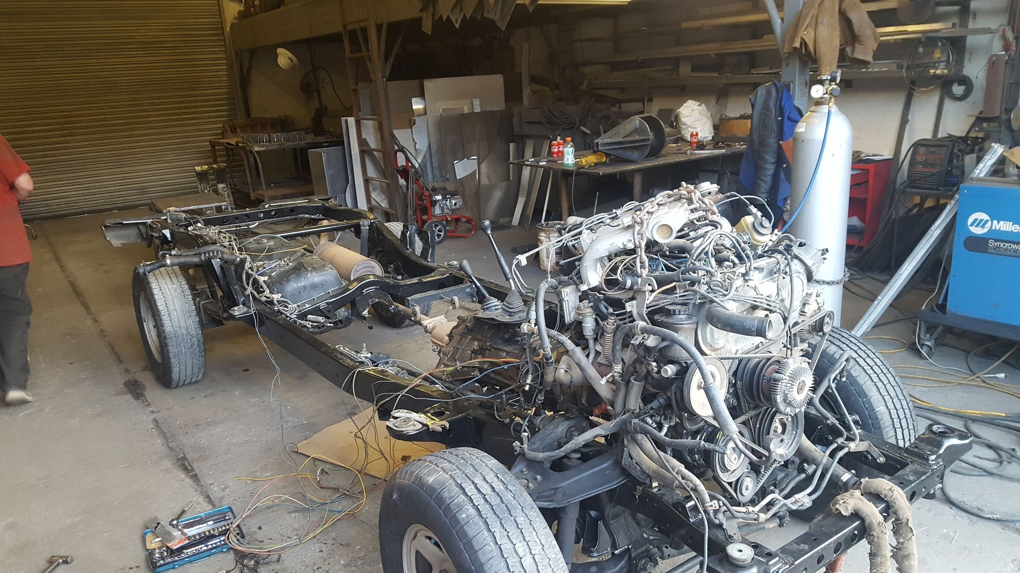

Took us 5.5 hours to strip that truck to the bare frame. Couldnt have done it without a couple friends and brothers of course.

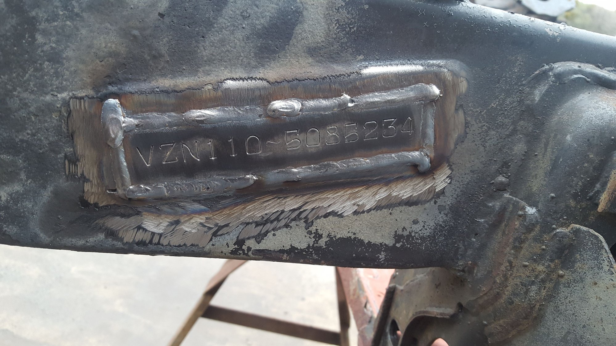

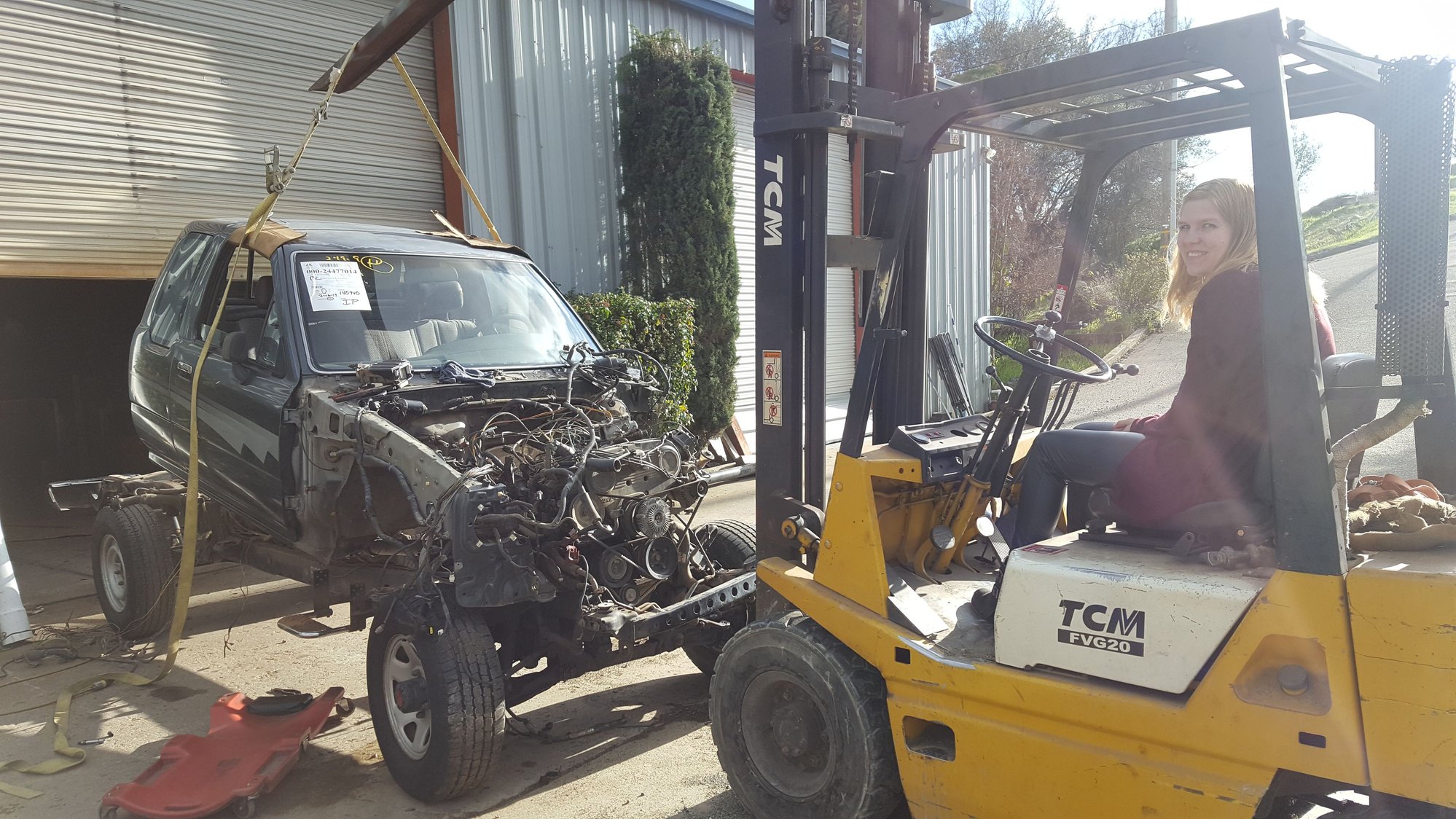

Cut the old frame vin out and fabbed it into the new frame lol

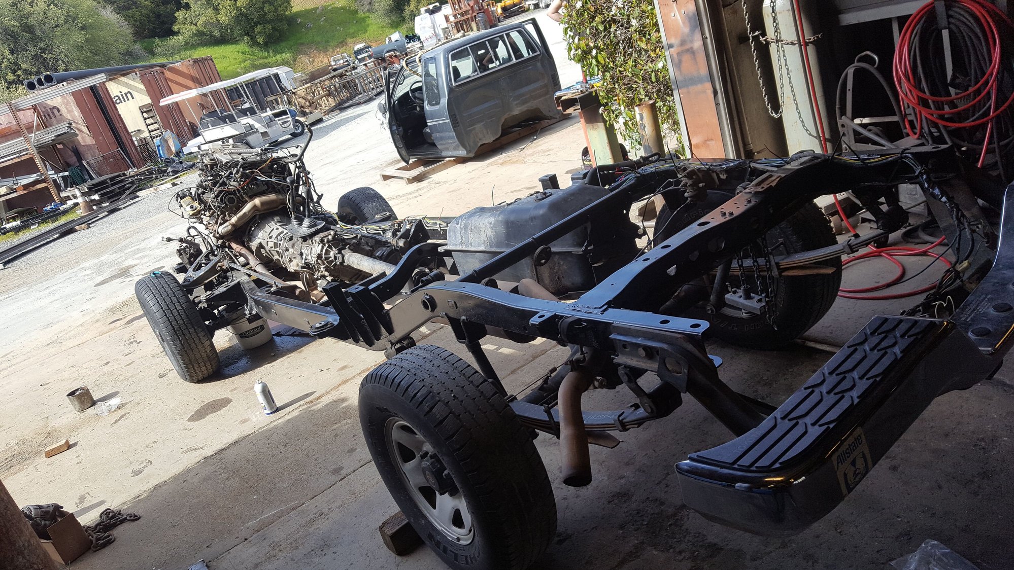

Frame all cleaned up, primed, and repainted.
Starting to look like a truck again!

Doner 4Runner front end
Ended up getting a Non power steering shaft for my power steering truck. Had to shorten it about 9 inches.
