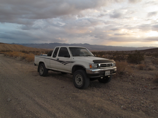

I am starting to realize what everyone says about the 3vze motor. It is a pain to work on but when I realize it is 20+ years old and that seems to be the big problem. I found the fuel pressure damper to be leaking the gas. After tracking down all the needed gaskets, I started the job of replacing the damper.
4 broken vacuum lines, 1 broken BVSV, power steering pump, still need the power steering pump idle up valve, 1 new power steering hose line, and now a check engine light I can finally drive the truck without leaking gas. Oh and the damper.
It took almost a week to get it done but I drove it out to the Mojave Desert this weekend and it did great. No real 4 wheel drive trails, but a lot of off road.
Field Road out in Mojave looking for Agates
Still need to do the brakes. I just got the hub seals so I have everything. Also still looking for the prawl that goes into the manual hubs. No luck at the junk yard here.
