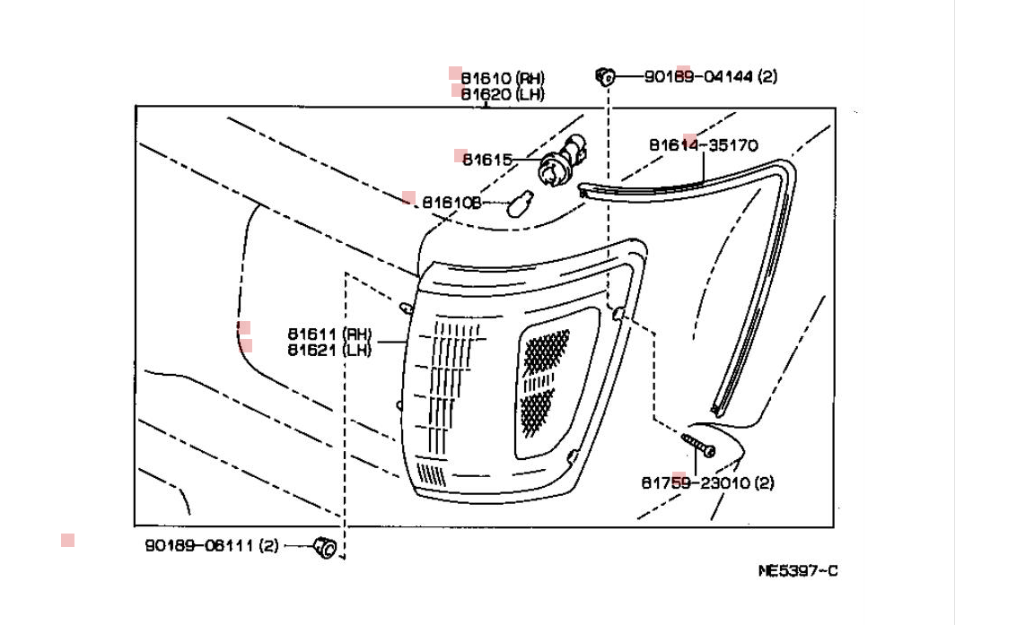

So here I am scouring the interwebs for a part that seems to no longer exist... While adding in fancy new led headlights I discovered that the Drivers side running light socket and male plug are completely destroyed. I have searched forums and websites for this part or part # or anything. I thought I had the part # but anytime I search with it pulls up a socket which is great but it is a 4-tab socket. Stock is a three-tab socket. I have found whole housings with lights and sockets but still no info to find the male plug to the light socket. If anyone has any thoughts ideas or parts please for the love of my sanity let me know! the 81615 pn doesn't find anything though on the site it says it fits. If I try and find this part online elsewhere that has photos it is clear it won't fit.

The 81615 number is not a full part number, rather it is just a diagram / part type reference number.
Using https://www.toyotapartsdeal.com/ and my favorite Toyota dealer parts website (Heartland Toyota), I was able to find the part number associated with reference number 81615.
SOCKET & WIRE; SOCKET AND WIRE; SOCKET PLUG
Part Number: 81735-12180
https://parts.heartlandtoyota.com/p/...173512180.html
It appears to still be available through Toyota.
