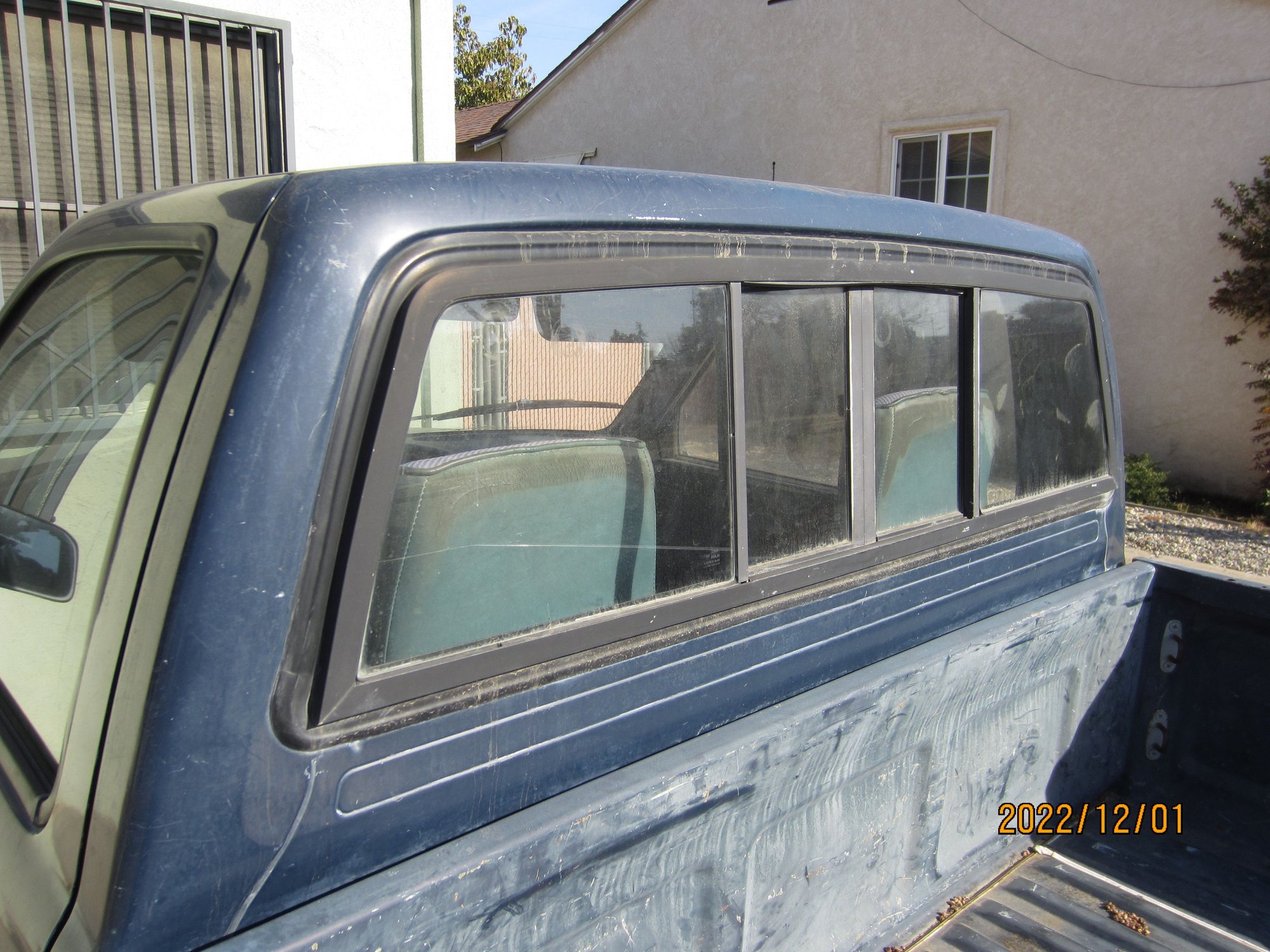

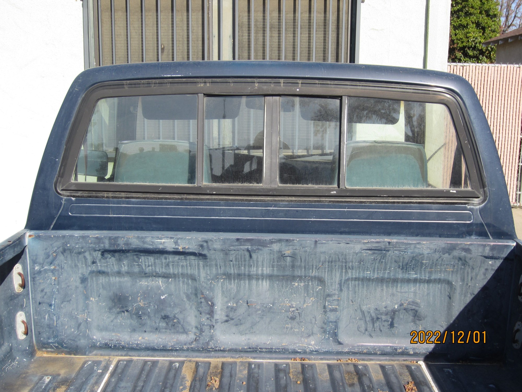

Old Nov 30, 2022 | 09:35 AM
JJ'89's Avatar
Joined: Aug 2007
Posts: 356
Likes: 56
From: Fresno
Old Nov 30, 2022 | 10:41 AM
Jimkola's Avatar
YT Community Team
5 Year Member
Joined: Jan 2020
Posts: 2,253
Likes: 1,005
The bed is Toyota, it's just one that was manufactured and installed in the USA. The vehicle would arrive as an incomplete vehicle (IV) and have the bed installed at the port. Pretty much all the DX and SR5 models have USA beds, while the STD all got the Japanese beds. Jap. beds all had that external lip, while USA beds were smooth at the lip. Most likely this was done to reduce tariff costs.
The rear glass is just held in with the rubber seal. It'll pull right out. Letting it sit in the sun for awhile will make the rubber seal easier to work with.
