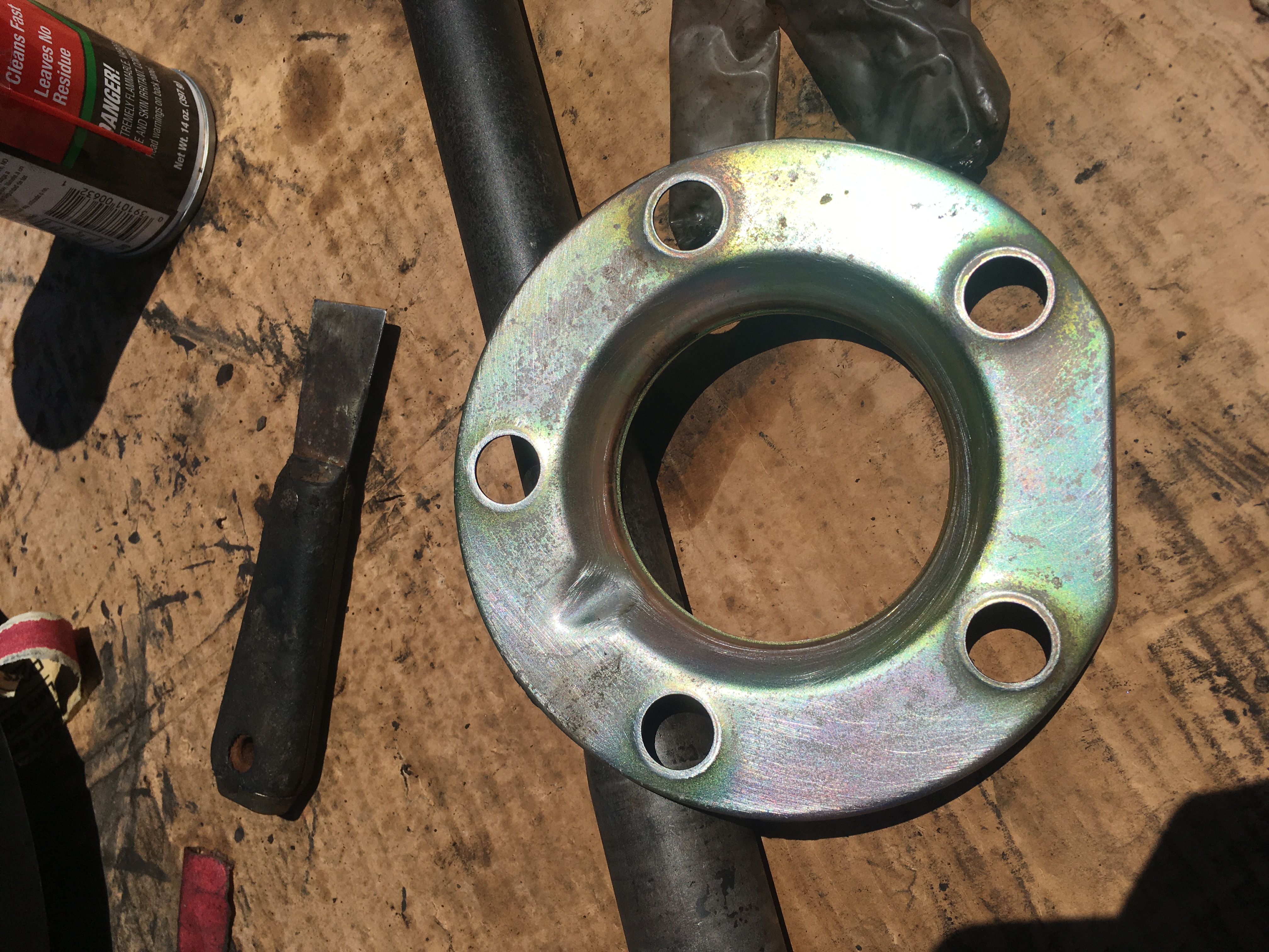

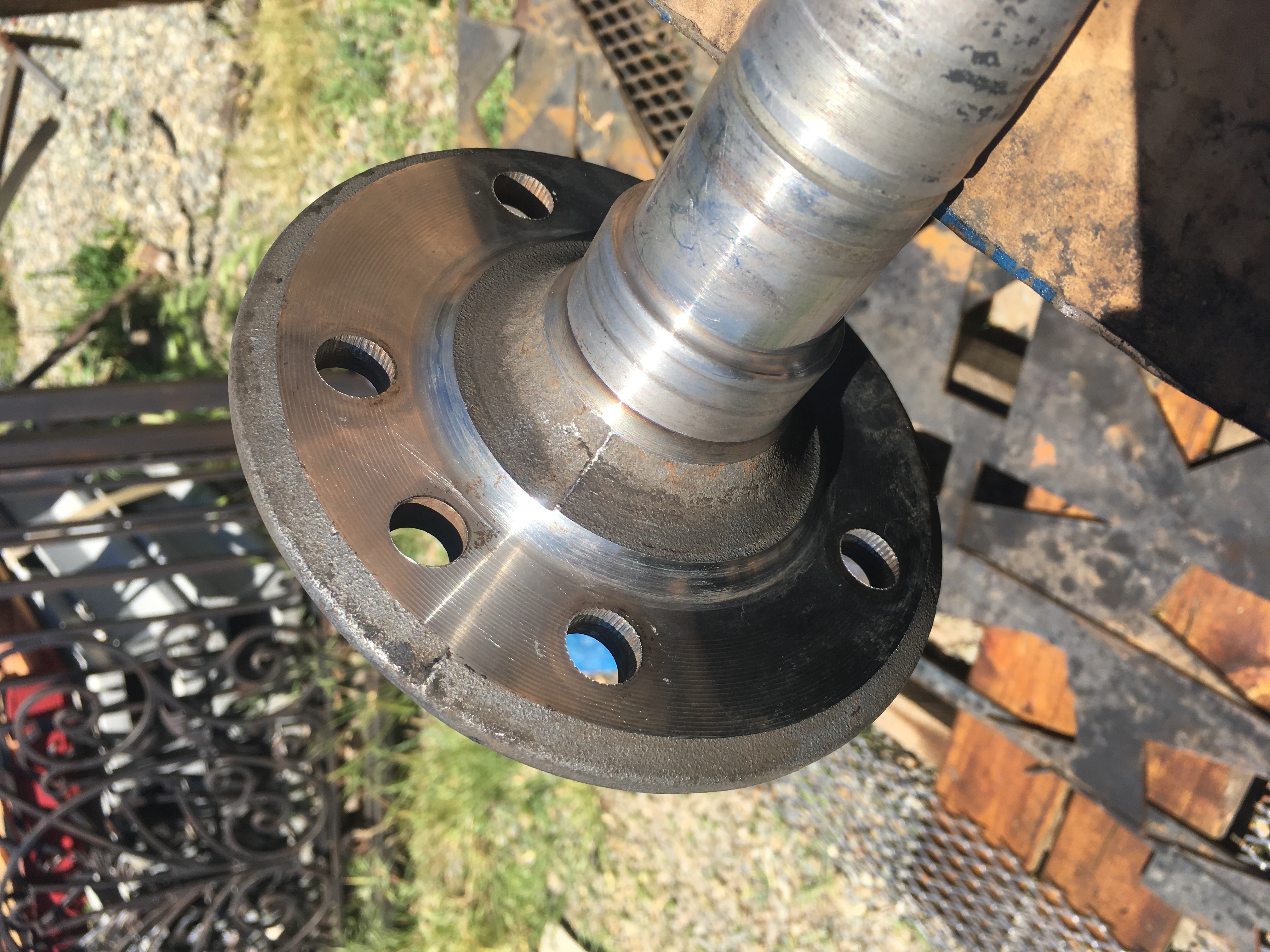

Here are pics of the pieces all cleaned up.
I used acetone to clean up the gunk by soaking everything for a good hour in the sun and then wiping it off with a steel brush.
I used wd-40 and 200 grit sandpaper to wet-sand the rust off the steel mating surfaces.
Came out REAL NICE!
Waiting on Toyota to receive the paper gasket part for where the faceplate goes on the back of the "hub". $2.50 a piece NOT BAD for a stealership.

I was rushing to finish installation so I could make it to a jobsite. Everything went great! No more axle rattling and the steering is stiffer on the road! now to check my front bearings.
I Even put fresh fluid in the diff and new plugs and crush washers.
