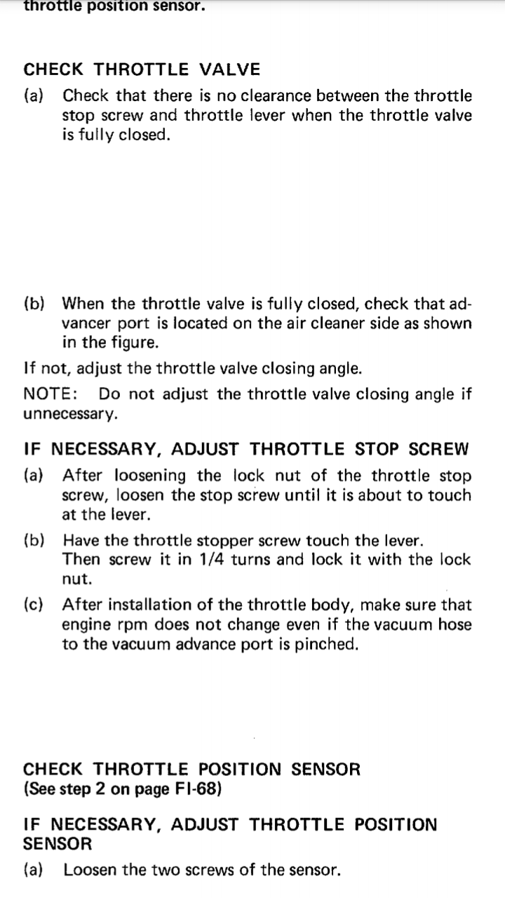

The throttle blade stop screw got adjusted.
Right above the red circle on the right hand side is the idle screw. Turn it counter clockwise to increase idle speed.

Release lock nut, back out screw untill its not touching, drive screw in untill it \"just touches" then add a quarter turn. Secure lock nut, verify vacuum port to throttle plate position.

As mentioned the idle set screw is in your photo, it's about 1cm and runs vertically along the right side of the throttle body. If it wiggles in the housing, rotates by its self, or doesn't have an intact plump oring replace the oring.
