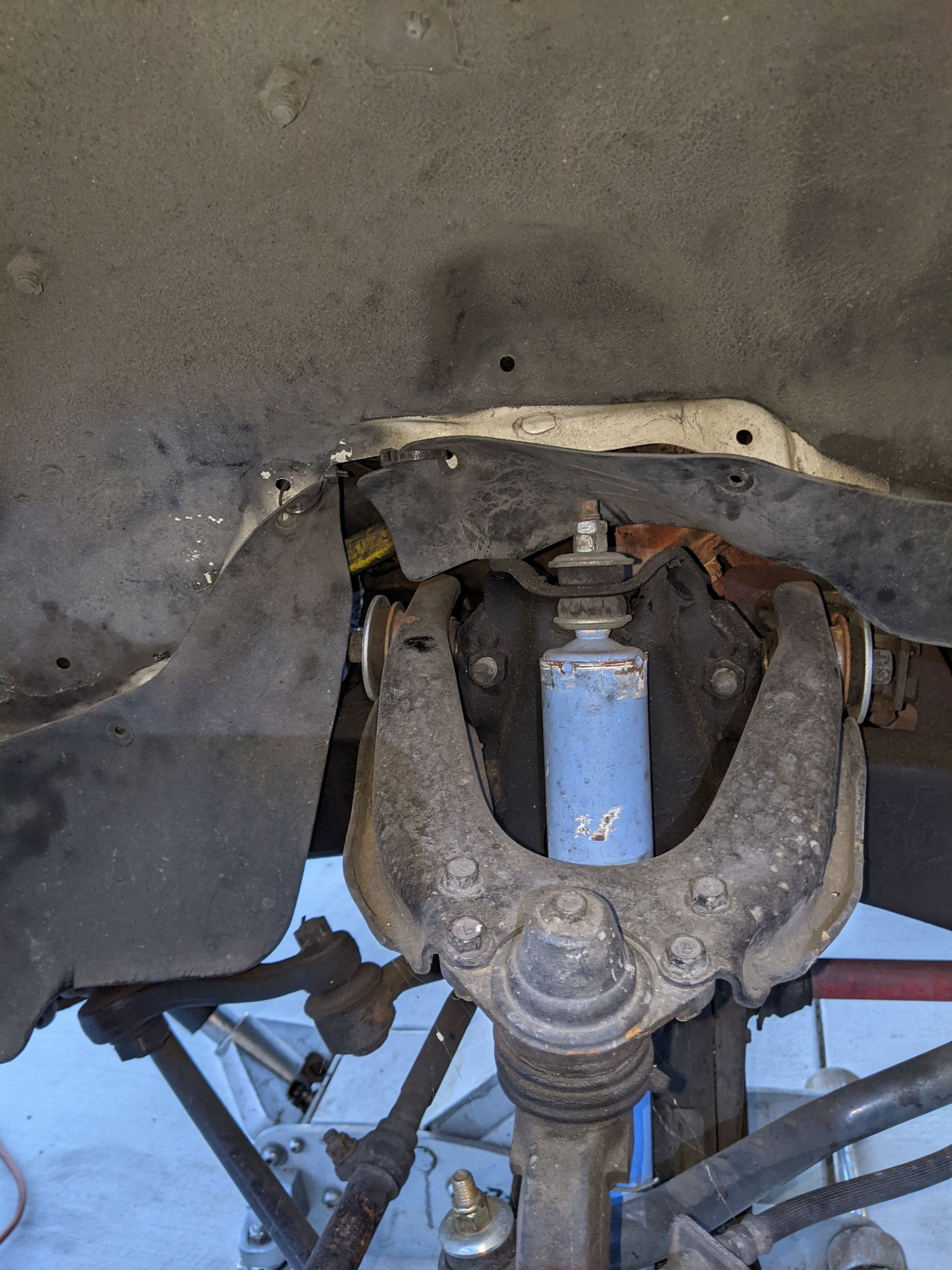

Old Oct 29, 2023 | 05:23 PM
MichaelKLerner's Avatar
Joined: Jun 2012
Posts: 122
From: San Jose, CA
My UCA Replacement - No fender cutting involved
I promised I'd check my inner fender well regarding whether replacing the UCA necessitates cutting the inner fender well. I checked. It does not.
LH - this is the side where the UCA was replaced.
RH - this side is factory original (except for the shock absorber) as far as I know.
Old Nov 1, 2023 | 03:01 PM
prcnctoyo's Avatar
Joined: May 2011
Posts: 236
Likes: 45
From: North Carolina
No cutting was necessary. I did have to unhook the steering shaft from the steering gear box. The FSM doesn't mention that. With the steering shaft out of the way you can maneuver the UCA out. If you were playing the game operation you'd hear the buzzer go off multiple times. The other thing the FSM doesn't mention is removing the shock which would give you more room. I didn't cuz I already had the lower control arm supported and couldn't get to the lower shock bolts.
I also used a great tool for pressing in/out the bushings. It was a loaner tool from Advance Auto. It's the Powerbuilt 648604. Here's a youtube video of it being used.
