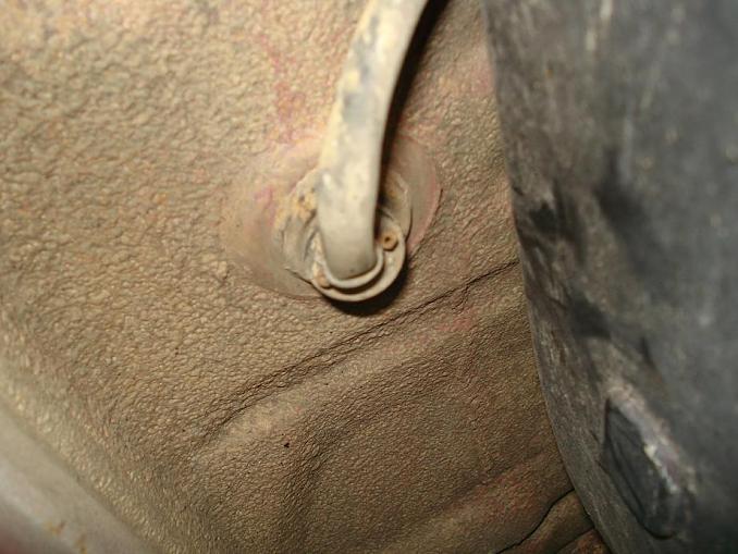

hey guys, im trying to figure out where the disconnect plug for the o2 sensor is on my pickup, 22re, 4X4 manual, you know the rest, haha, the wire from the top of the sensor runs up and into the cap of the truck, got pics to show you, if anybody can help that would be awesome, im guessing its up in the dash somewhere, i dont know

oh...actually, weird. Yours does go into the cab. WTH? None of my 22res had that

ohh ok so does the wire go in to the dash area somewhere, i guess i got to hunt it down

update guys, the wire ran right under the driver side seat under the carpet, and the plug is just right there under the seat, thanks for the help, i got 145k miles on the truck, and it has the original o2 sensor, do u think it would be a good idea to go ahead and replace it, its not throwing any codes or anything and is still getting 22mpg, just wanted to know if it would be a good idea to go ahead and replace it with that many miles on it

its under the driver seat u gotta take the floor panel off 4 screws i think and ull see the plug under the carpet dont tug on the wires there tight ull just be able to get it uncliped and clip the new one on. I just replaced mine hope this helps.
