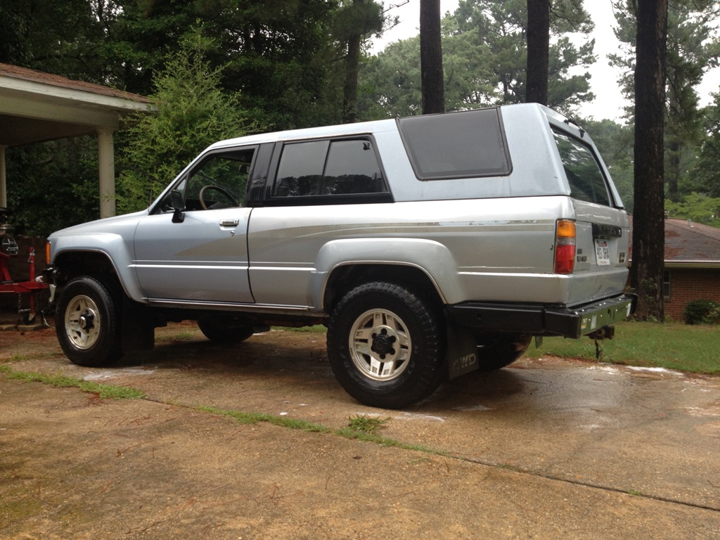

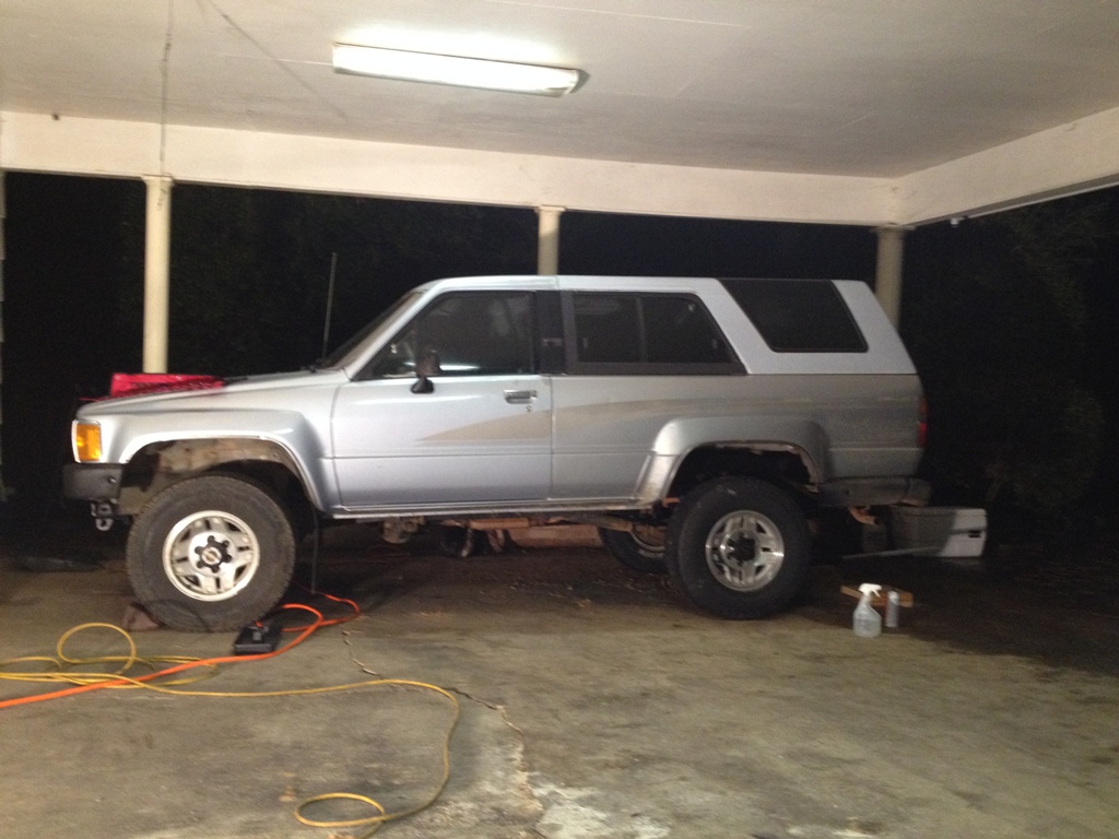

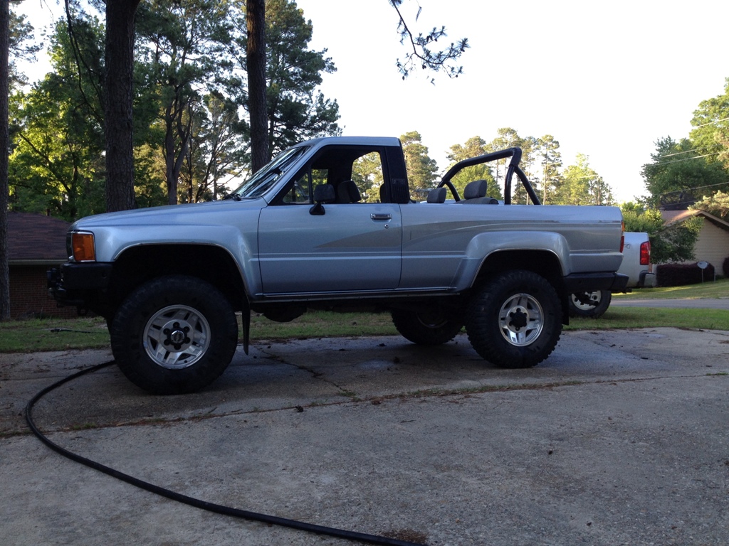

This would probably be most helpful to you. Take a look at these four pictures. They are the evolution of my lift. First one is how I found her, second is after the add a leafs I bought off Amazon, third is after the 6" shackle upgrade and the last one is how it is now with both rear mods and the bjs.
The ball joint spacers just put your joints at a lot more angle than they were designed to ride at all of the time. These trucks are old and if you aren't replacing your joints with some high quality parts when you do it, you are going to end up finishing off what is left of them at a much accelerated rate. If the boots didn't leak, they might after the spacers and I can guarantee that they won't be as tough as they were at less of an angle. It's absolutely not a performance upgrade. It's just for looks at the expense of your front end. Now to be clear. If I thought they would break my truck and or get me hurt, I wouldn't have installed them, so take that for what it's worth. Also, I would never have thought of doing them if I had a body lift in mind.
I take detailed notes on all of my work but looking back at them, I'm not exactly sure at what point I took my measurements. Wait a minute. I see what I did. I didn't have before measurements. My first measurements were taken after the add a leafs were installed. The nearly two inches I got came after the shackles. I knew they gave me an inch and a half or so. Take a look at the pictures and judge for yourself.
Look at my first picture and see if yours sits like that. My rear end sagged but the springs actually didn't measure out to be bad. The bow in them was within the normal / fair range for a 1st gen. If your spring packs look almost flat, then you need to replace them. Again, look at the Chevy 63 upgrade. If they are still ok, then my best guess as to how to make 2" would be the smallest add a leaf you can find and some nice 6" shackles.
