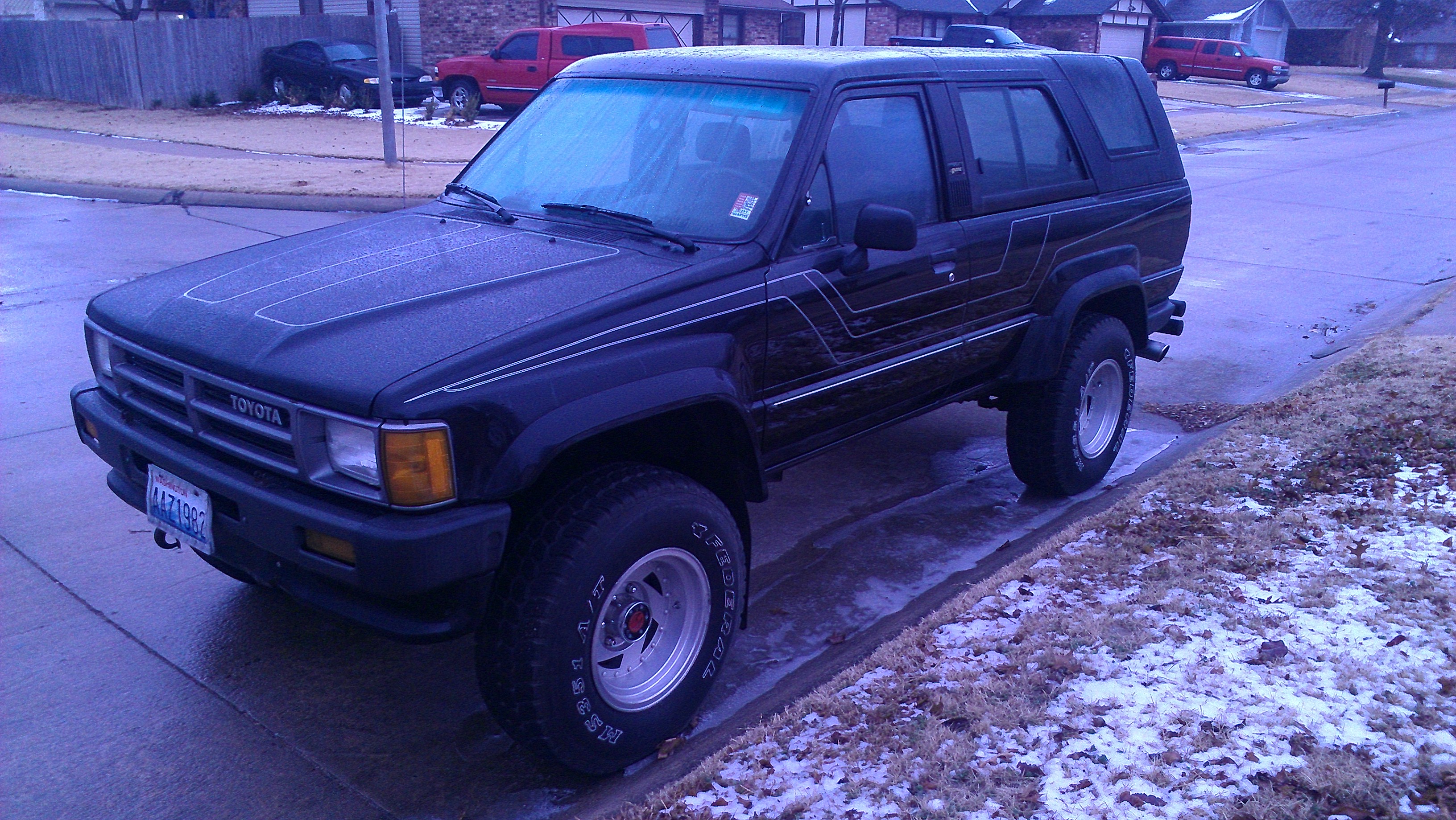

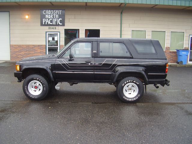

Hey, I'm new to the forum and i have a mechanic friend that does all my work cause i'm useless with tools on anything that isn't a firearm. I have a 1987 4Runner that originated in Washington state. I bought it and had it shipped to Tulsa, Oklahoma. The 22re efi that is in it has no AC and is at approximately 250k miles. Also I am averaging approximately 14mpg.
Will I be better off adding an AC to my existing motor and having it rebuilt and hoping that my mpg goes up or should i rebuild and sell this motor and put in a new one? Also does anyone know if a lexus is-300 will bolt up and work with my stock 5 speed tranny? the is-300 would run around $1600 for a crate motor. I'm open to suggestions as my knowledge stops at being able to drive it like I stole it. Here are some pics of my new (old) baby. Zero rust xD!
