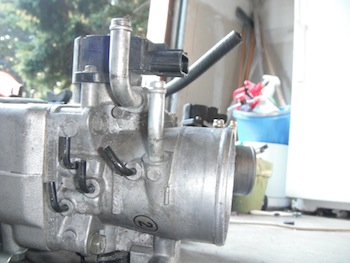

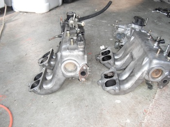

ONE hose attached to identify the 86 upper intake plenum (Or TB if you like calling it that)

More pics...What gets me also is the valve(where the hose is attached) on pic DSCF0730 that is not on the 1992...From what I've seen it should be there on the 92 as well

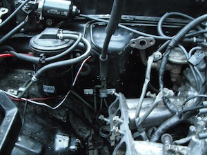

VAC lines

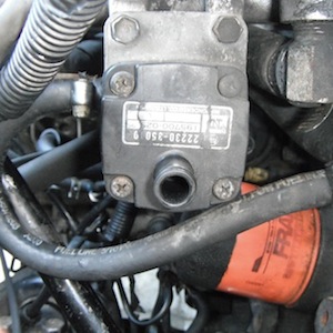

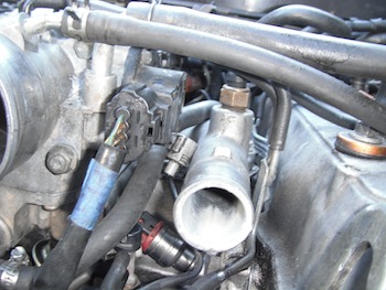

Like I said the camera didn't come out until after the upper intake was removed or at least in prep for removal. BTW..Rerouted the injector wiring CORRECTLY after I removed the intake. Pic 712.....Not exactly sure where this one went...Considering it is the IAC, could've been the whole problem...couldn't find good instruction on this one. OH and BTW...I removed the VSV's before the pics...If you were wondering.
Attached Thumbnails 86 vs 92 big issues-dscf0718.jpg   86 vs 92 big issues-dscf0712.jpg   86 vs 92 big issues-dscf0723.jpg

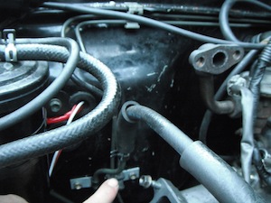

Just some snaps I took of lines. Pic 725, this line just does not look right, but saw where this was supposed to go on another thread....I have it from the T-stat housing...92 does not have it the same setup. I'll get some pics of the "Lime Green" 92 motor soon...You'll see what I mean about Lime Green...LOL

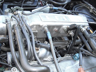

i was unsure here too, but attached it to the back of the upper intake. Assume emissions for fuel gasses, since it is not rigid. AND the only end that size within reach..LOL

Appreciate the pics....I am currently RE-installing the upper intake and replacing the 86 vacuum rail with the one from the 92. All 92 Injectors, plenum etc....distributor and coil are the same best I can tell...othersise, connectors won't match.
Will let you know.
Still don't know where the line from the fuel system goes from the last set of pics and the IAC line still concerns me.
That valve is the A/C idle up valve. I'm drawing a blank on what all vac lines route to it on the 92's, but on the '86 atleast the A/C vacuum switching valve line routes to it (and pretty darn sure the power steering vac lines) from the valve cover where the VSS is mounting. Since the VSS is not adjustable, you have the idle up valve that is.
In other words, anything that draws power from the motor while the motor is operating at idle or low RPM's.....like the a/c or power steering.... requires that there be some form of compensation for it. In the case of the A/C, the VSS allows a small, controlled vacuum leak into the plenum to bring the engine RPM's up so the drain on the motor does not occur. The idle up valve allows for some adjustment should the amount leakage the VSS provides be not enough or too much. But, you should never really have to mess with the adjustment if the VSS and related systems are operating correctly.....though, it does happen that way sometimes.
So, yes.....you should have one on your '92 set up. I'm not really sure where it'd be located on yours. A possibility, maybe...if you don't see anywhere it would mount on the '92 plenum body, is the pass side wheel well inside the engine compartment. It is on a '92 V6, anyway.

Are you using the '92 ECU and wiring harness?
Are you using the '92 injectors?
Are you trying to use that IAC on your '92 set up? If so, it won't work. The '92 set up uses an IAC that's integrated into the throttle body. In fact, in the bottom of it and is solely coolant temp operated. The '86 IAC is heater operated by voltage supplied from the fuel pump relay circuit and ambient air temp's.....which means your '92 electrical system won't operate it.
You need to use the '92 intake......upper and lower...with the '92 throttle body to have everything work right. And, you're right........the IAC could very well be your big problem. Atleast, it's part of it....if I understand correctly and you are indeed trying to use it.
but OH and BTW...I removed the VSV's before the pics...If you were wondering.
